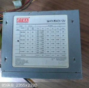

can anyone tell me about that;
it was on my CPU SMPS.
[Edited on 3-1-2023 by Ankit1612]

this PSU looks like the 400 or 300 watt variant and anyways you have a lot of amps to use. Highly doubt you will even get close to running it more
than 8 amps with your electrode

It means I will get 40A at 5V..!

That is the maximum you will get before it shuts down or shits itself. This likely wont reach values anywhere near 40 amps unless you have large
enough electrodes with low enough resistance which dinky graphite rods simply wont make that possible unless you dead short them.

Yes, for a short time. As the unit runs at that high of a current, it will heat up. Hotter it gets, less power you can draw.
But thats just a starting point. You need current control.
Thats more important than voltage.
