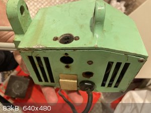

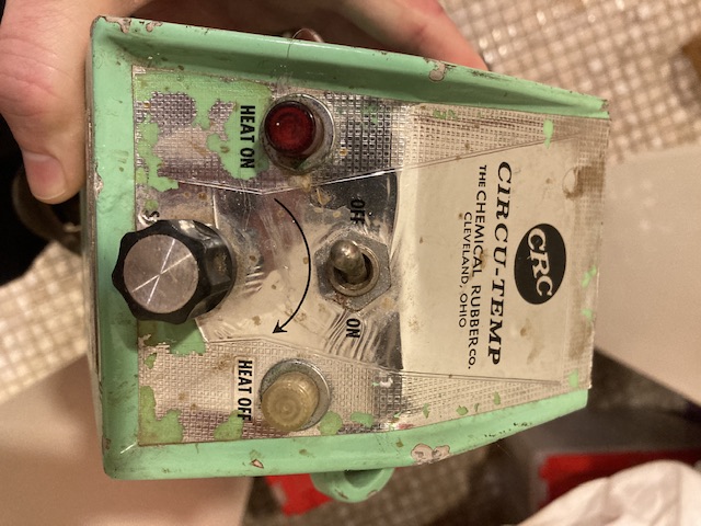

i came across this post to buy some of this stuff and I saw this. i asked the seller what it was, he did not really seem to know. he sent some pictures of it and I was wondering if anyone knows what it is.
I'm 90% sure its an induction heater, but I can not find it anywhere online. i look up EVERYTHING including model number and I did some research on the CRC and I can only find that it was basically google in 1901 and that they supplied chemistry stuff related to rubber. this thing looks old 10-15 years old maybe more idk. I'm also guessing that its a specialty item made for a hospital hence the "University Hospitals" on the back with its model number.
im not sure what a hospital would have use for an induction heater but i could be mistaken. if you have any ideas on what this is please write something.
here are the pictures the seller sent.

It looks a lot like a water bath heater

Its an immersion heater, it heats the liquid you immerse it into. Mostly for water baths. The dial sets the temp.
Posts: 3469
[*] posted on 5-1-2023 at 16:52
The knob is labeled "STIRRER SPEED" so it is to control the speed of the stirrer ;)
The immersion heater probably had an external thermostatic sensor / controller.
Looks like significant wear and corrosion so hardly worth the postage costs I'd guess.

A hotplate would create convection currents but not enough to ensure that all places in the bath would be at (almost) the same temperature.
PS this model looks old enough to be pre-internet :)

At a glance, I’d guess 1970s, maybe 1980s at the newest. I don’t think it would be worth any money unless it was in good working order and you could find a compatible temperature controller. Kind of obsolete nowadays because we’ve got powerful and precise temperature controlled hotplates with magnetic stirring. But, it could be a decent budget option for an amateur chemist in some cases.

There's probably not much inside that thing. The heating element will just be a coil of wire. There is likely a thermocouple in the copper coil somewhere, but those are so much cheaper and better nowadays. It looks like there is no heating control, so it may be preset to maintain some temperature. Medical fields need heated water baths all the time, thawing IV fluid, culturing cells, etc.
Then you have a small motor with speed control.
You will likely find similar components in an old blow-dryer. It is almost certainly not an induction heater (like the ones used to melt metal). You could use that copper coil to build an induction heater, but you would need to build the circuit yourself.

It is indeed a water bath heater with an integral mixer, to circulate it to keep it at an even temp, looks like an old analog unit so odds are it could be cleaned up and made to work and look good doing it.
not much to go wrong internaly.
I'd wager a old style capillary thermostat for heat setting, and rheostat for speed.

i bought it and found out the stirring does not work, but the heating is VERY hot and get to like 200c in like 5 seconds :)

Yes, it is designed to only be turned on in water, so the element will burn out fast if left on without a cooling bath.
