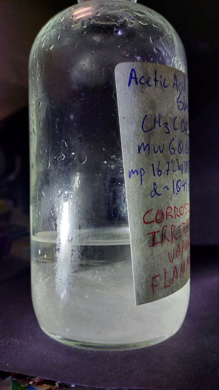

There's a small handful of examples besides water.... but I don't think acetic acid is one of them! Wiki/Merck say the liquid density is ~ 1.05 g/cm3 vs the solid density is ~1.27 g/cm3. I put mine in the freezer for a few minutes and got this:
frozenAceticAcidGlaciers.jpg - 101kB
not sure what to make of the swollen bottle!

It does NOT expand of freezing. It shrinks. I have frozen it already few times in original glass bottles (>99%) to increase concentration and the glass survived every time. I was more worried on melting but also then the glass survived. I suppose tiny layer of melted acid was created between glass and frozen acid which prevented breaking glass on melting - luckily the melting starts from outside and not from the center. Also the volume significantly reduced during freezing and increased during melting, which was well visible by eye as the bottle was full before freezing and there was much more free space after freezing. I let bottles in fridge at +4 C for half a year, small periodical oscillations of temperature made solid acid to be at bottom and small amount of liquid on top which was then easy to pour out (unlike at the beginning when most of liquid trapped in the icy acid). I did the same as well with my 1,4-dioxane where at the beginning there was only a little of liquid visible but after months the volume of liquid is significantly bigger as the liquid which was initially frapped among crystals went slowly to the top.

After sitting inside for about 24 hours, most of the acetic acid has melted. Indeed, the solid part goes to the bottom.
Not sure why the whole bottle was frozen solid yesterday, with the ice expanding even into the neck of the bottle. Perhaps someone transported it upside down (even though the box has an arrow on it, and was correct when it arrived on my doorstep. Perhaps air got stuck in it due to motion while transporting.
Today the liquid does not even come up to the top of the bottle (with some frozen part still present).
