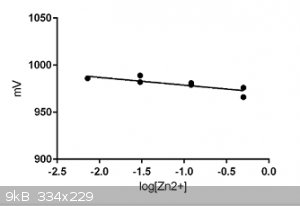

With this configuration I measured the EMF (at 19 C) for five Zn2+ stock solutions and their replica.
With Nernst we get:
$$\color{red} {\underbrace{E=E° -\dfrac{0.059}{n} \log_{10} \gamma [Zn^{2+}]}_{\text{Applicable at only 298K}}} \label{Nernst Short}$$
The following picture says more than a thousand words:
EMF LR.png - 15kB
The problems are:
* poor reproducibility
* long equilibrium times: 10 mins or longer.
Both the intercept and the slope are in the right ballpark.

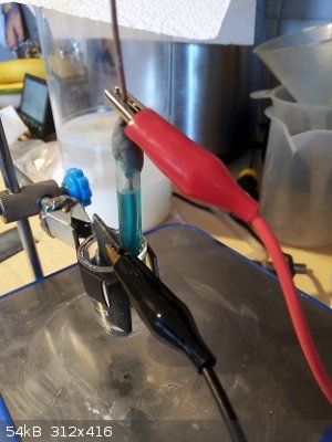

Cell and electrodes:
IMG_20230202_115551_273 (1).jpg - 59kB IMG_20230202_110156_968 (1).jpg - 54kB

It is possible that the zinc plate is covered on oxide and should be polished? (from your pictures)
(once I tried to check for zinc on a zinc plate with CuSO4 solution (it contained another reagent - cannot recall which was. The test for zinc,is to get a black spot when you add a drop of the solution on zinc)
I know for sure that it was Zinc but the test did not work (no black spot)
When I polished the Zinc, the test was succesful (black spot)
so maybe oxide maybe is interfering? (wearing of on each test, so different results)
Note: I do not have knowledge of Voltammetry.

What is your separator?

Are you sure that this is voltammetry? It look like potentiometry to me. If I understand it correctly, you just measured how potential changed with decreasing Zn2+ concentration. If you want to do voltammetry, you must apply changing pontential and measure change in current.
Nice experiment though. Do you consider use similar setup for potentiometric titration?
Voltammetry/potentiometry... you know? :D:D:D
No, it's potentiometry, definitely. :P
I wanted to use the setup for standard addition and titration methods but with such poor reproducibility that's out of the question.

I clean the Zinc plate by dunking it into 2 M HCl for 5', prior to a run of measurements. Bubbles of H2 then occur. So oxide cannot be the problem.
[Edited on 11-2-2023 by blogfast25]

An Aga agar gel, 1 M NaCl, at the bottom of the Cu ref. electrode.

So the experiment above was repeated, albeit with a slightly better grade of ZnSO4.
The results were very much similar to the first run:
* reproducibility was slightly better but not brilliant
* equilibrium times remained long: 5 mins and longer
The slope was -8.2+/-2.2 mV when acc. Nernst (see above) it should be about 28 mV. I can't explain the discrepancy. The lower slope means of course reduced sensitivity.
potentiommetry.png - 9kB
