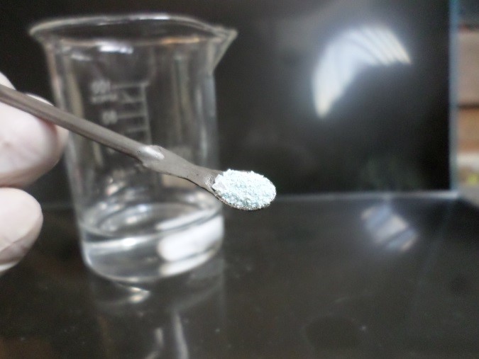

B] Now the Pre-Indicator is added. In these case I used a small amount of solid purified copper sulfate. A better way to do these is to have a solution of pre-indicator made and filtered so no particulates are present and the solution is perfectly clear.
Copper Sulfate Purified [I].jpg - 70kB Copper Sulfate Purified [II].jpg - 51kB

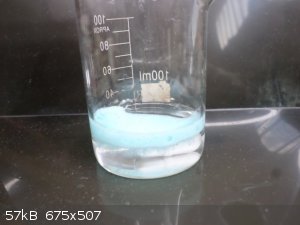

The copper sulfate reacts with the bicarbonate to produce basic copper carbonate.
CuSO4 + NaHCO3 [I].jpg - 57kB CuSO4 + NaHCO3 [II].jpg - 60kB

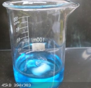

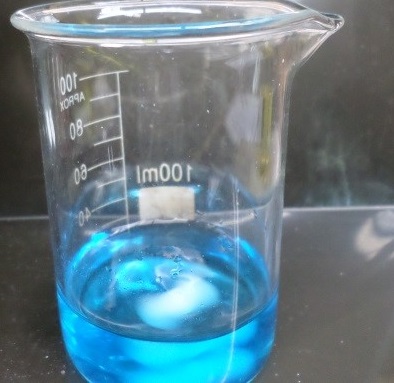

The basic copper carbonate dissolves in the bicarbonate giving a strong blue color. Possibly unknown complex formed here.
COPPER COMPLEX.jpg - 45kB
