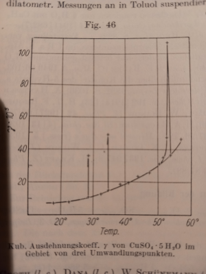

I think this is the correct table (and it is published in 1894):
https://gallica.bnf.fr/ark:/12148/bpt6k34902q/f552.item
There are 2 reasons why some sources contain incorrect data for CuSO4.
1. Solubility curve of CuSO4 has 3 anomalies in the pentahydrate range: 28.9, 34.85, 53.72C. It is like spikes where properties of crystalls are changing very fast in very narrow range (fractions of degree) and comes back to the curve:
CuSO4sol.png - 112kB
There is a reason for this behaviour: water molecules in crystalls change behaviour from oscilation to rotation. But those anomalies of CuSO4 solubility were discovered in the end of 19 centure. Try to evaluate the quality of your in-house methods. And probably what you can observe at those points is "there is no constant equilibrium".
Solubility table in classical references are very often just interpolations, for example Bronsted (1928) gives the full table built by 4 actual measurement, the rest is calculated by generic formula.
2. After 95.9C it doesn't crystallize as pentahydrate, so those table which gives solubility at 100C can incorrectly substract 5 mols of water instead of 3.
So, for me there is no any miracle here.
[Edited on 12-3-2023 by teodor]
