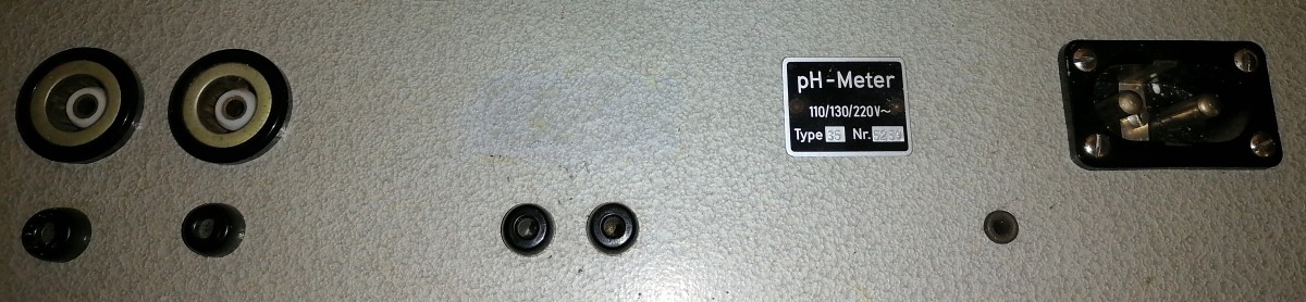

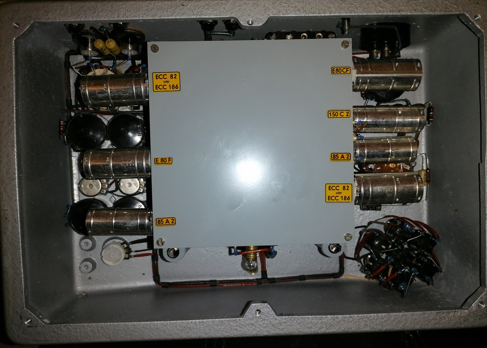

Well I just could not resist for 15 € and bought me a Knick Type 35 ph-meter.
Naturally I would love to have it functional and more I would want to know HOW to use the darn thing.
I am aware of the basic functioning of it, measuring mV of the elctrode what resembles ph taking into account the drift due to temperature. What I do not know though is the function of:
left side:
- Stufen Komp(ensation) whats stepwise compensation translated but what does it mean?
right side:
- left is titration, right is DS. Whats DS? Two channels, to every chanel belongs an electrode, connectors for two kinds are present. I can choose one channel and then choose between titration - nada - measuring, or DS-nada-measuring. I suspect that DS is just normal ph -meter and titration is somehow dynamic following a changing ph when titrating. The bottom knob labeled titrationcan be turned left or right and does what? Why are the small pre-select buttons labeled 54/56/58 ?
Middle position of top button is Eich(ung) say calibration. I guess the two connectors on top in the middle are for a Calomel electrode and well thats easy then.
Delta ph and delta E will be adjustment of the logarithmic function.
So how to do a titration with this? If somebody knows, I would be really happy, I searched the net and mailed the company but nothing. Or if somebody knows a old book online where they explain the general use of those oldies.
It weighs 7 kg btw. Unbelievable heavy.
Pictures attached
1Knick.jpg - 470kB
connectors.jpg - 127kB
drinsides.jpg - 668kB
electrodes.jpg - 138kB

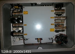

1A roehren.jpg - 528kB

Its got tubes. Older than the web

My background is in electronics. I also restore vintage electronics.
Tubes do wear out of course, but the other components in this instrument are higher quality than in a typical consumer item. My guess at this point is that it dates from about 1980.
Do you know about titration using an indicator solution? A meter will not make it any easier, but it could make it more precise.
You would need a pH probe and to adjust it a couple of precise buffer solutions like pH 4.0 and pH 7.0. I wouldn't turn the unit on without a probe at this stage, you couldn't learn much about the unit if you did.
The input terminals of a pH meter have a very high impedance. A typical digital voltmeter would have an input impedance (load it puts on whatever is measured) of about 10,000,000 ohms. A pH meter would have an impedance about a thousand times higher. That makes a pH meter somewhat delicate electrically. The electrical insulation has to be very good, many times glass and Teflon are used around the input circuit. Even the contamination from your figures can effect the operation.

Thanks. The device has a dedicated calibration setting, I believe titration means something different. The elctrodes have not changed, only the connectors so I got me two cheap ones off Amazon and replaced the coaxial connectors with some banana plug connectors which fit perfectly. I also got me the ceramic AC connector. HHave yet to switch on though....
I doubt it is younger then 1960's, I looked for Knick phh meters on the net and they follow very accurately the design taste of the periods, so 80's would look more like (fake) digital, very square without any rounded corners.
There are plenty of those devices on the market and for very cheap too. I might keep this just for decoration and get me another one with an output for a writer, the signals easily converted to be useable for data logging or even automatic ph adjustment.
