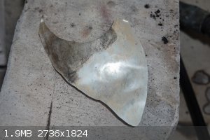

[*] posted on 26-4-2023 at 12:07
I just tried melting some NaOH prills on a piece of silver sheet (alloyed with Cu and Ge, so-called 'Argentium silver') and were after melting the lye wetted the sheet, it got very clean.
After cooling it got somewhat yellow but I put the sheet into water to dissolve the frozen NaOH and the photo shows the result.
So I'll try to electrolyze it another time.
