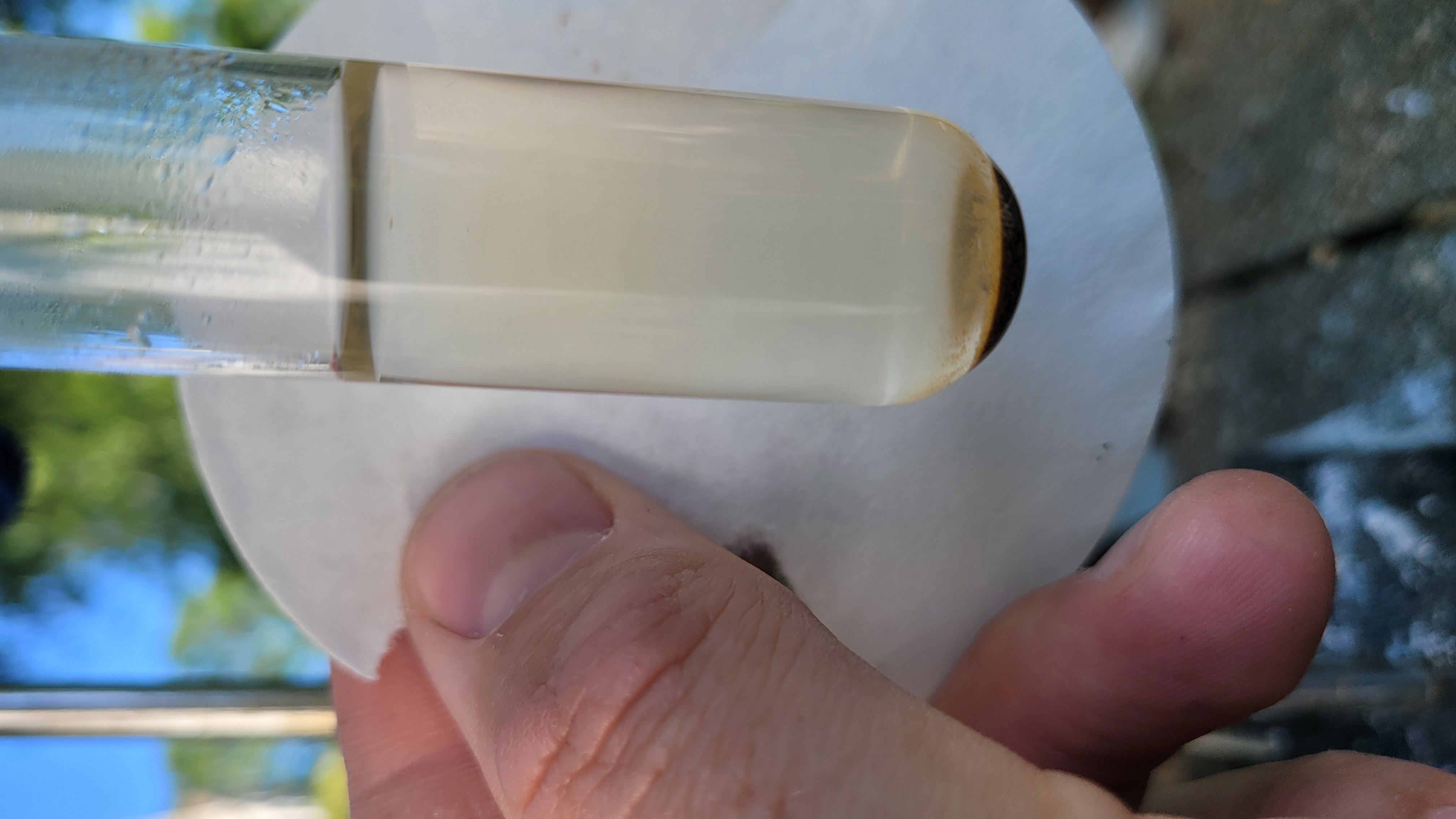

Rainwater
Posts: 709
Registered: 22-12-2021
[*] posted on 3-5-2023 at 05:58
1.0g of ore was boiled with di water and rinsed twice.
40ml of di water and 2ml of 68% HNO3 was added.
Solution heated with a flame to gently boil for 10 minutes
Ivory cloudy solution was the result.
No glass etching is visible
20230503_080658.jpg - 2.7MB
After settling the solution maintained its color, much less cloudy
20230503_092719.jpg - 1.8MB
Half the solution was decanted and its volume more than doubled
3 dtops of solution where transfered to a vial. 1 drop of saturated AgNO3 solution was added to the solution.
White percipitate was formed
Na2CO3 solution was added to the main solution, drop wise until bubbles quit forming.
Additional Na2CO3 drops caused a change in opaqueness.
Ph~10
A white percipitate has settled to the bottom of the test tube.
20230503_095320.jpg - 1.9MB
Thank you all very much. No beter way to spend a vacation
