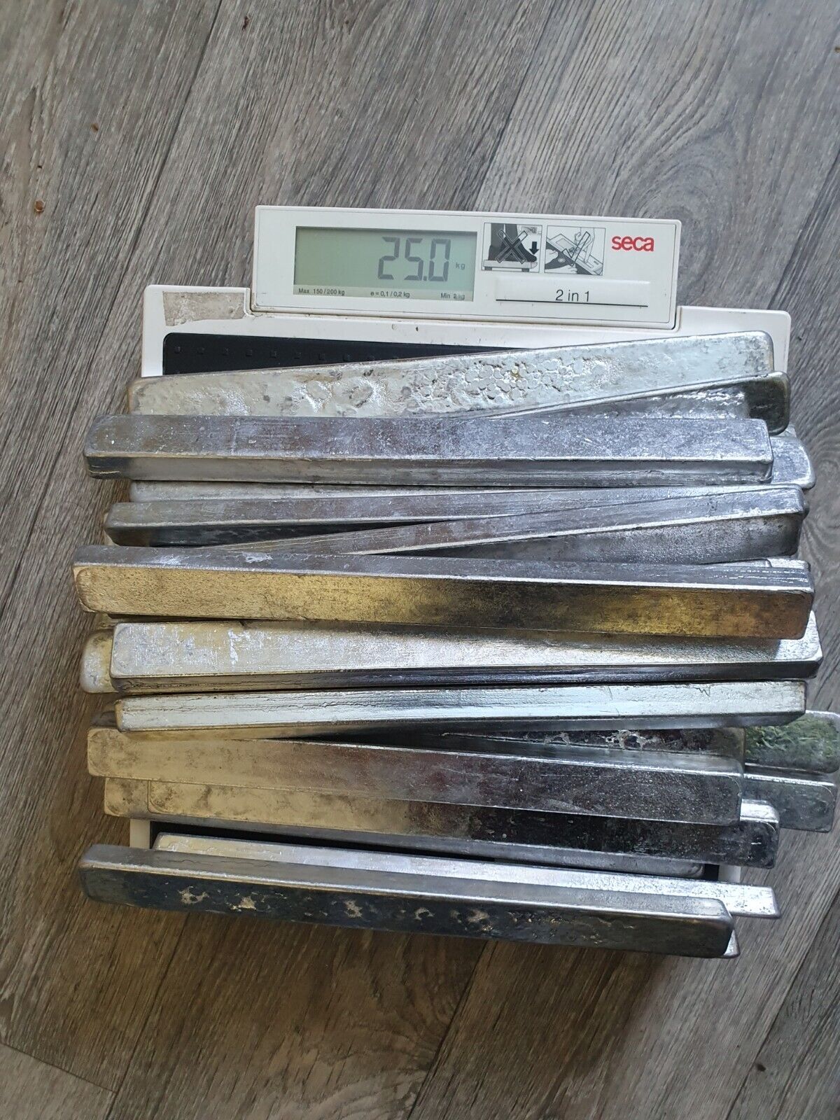

Finding percentage of tin in leaded tin solder
Hello Dear forum members, I'm back and need your help.
I've bought 25kg of bars with density 8928 kg/m3 of a lady that doesn't have knowledge of metals, she thought it's aluminum.
Paid 95£ with delivery to my door.
Bars are very old and unoxidized, that's another reason I'm thinking it's leaded tin solder 60/40.
Knowing that tin sells for 27£ a kg, theoretically only tin in them bars worth at least 405£.
I need a method of finding out the percentage of tin in the solder alloy.
If I dissolve it in diluted nitric acid will all the tin drop out as stannic acid or some may remain in solution?

Here's photo of them bars.
s-l1600 (3).jpg - 393kB

The easiest way to work this out is with algebra, assuming it is purely an alloy and doesn't contain intermetallic compounds.
Let x be the fraction of the alloy that is tin (between 0 and 1). The density of tin is 7.3 g/cc, and the density of lead is 11.3 g/cc (to 1 decimal place).
Then, again to 1 decimal place:
7.3x + 11.3(1 - x) = 8.9
7.3x + 11.3 - 11.3 x = 8.9
11.3 - 4x = 8.9
11.3 - 8.9 = 4x
2.4 = 4x
x = 0.6
On this basis, it's likely to be around 60% tin and 40% lead.

Since you know the total mass and it's density you can calculate the total mass of tin.
A few thoughts ;
1 all soluble lead salts are toxic to humans and aquatic life.
2 check with a local scrap dealer if they would buy your recovered tin and at what price.
3 check with a local scrap dealer,
you may be able to make a profit without expending nitric acid or creating toxic products.
4 if you are not short of cash, consider the solder bars as an investment metal.

No doubt it's 60/40 leaded tin. Not soft enough. And I was wrong leaded tin solder tarnishing with time, this bars doesn't.
Thinking now that it's a Zinc alloy with 90%+ Zn in it. But I'll still give a go dissolving few grams in nitric.
Still a good deal, will use them to precipitate PGMs out of catalytic converters, but first I'll check if zinc and copper displacing Pt and Pd, using 99.95 pure bars. And maybe Rd, minimal order now days is half an OZ which cost almost 4000£. Remember in the first years of COVID pandemic gram of Rhodium cost more then 800£ at some point, and KG of tin more then 40£, prices returned to normal now. Sometimes items with thick plating of Rd showing up on auctions cheap. I'll experiment with them to start with. I know about PGM toxicity, I'm prepared for it, got my self a Belgian army chemical attack suit from Preppersshop's online, paid 20£ with delivery. Produced in 1974, don't think so you can work with pure H2SO4 wearing it, will it decompose suit to carbon?

Posts: 3469
[*] posted on 11-5-2023 at 15:18
Quote: Originally posted by Romix
Thinking now that it's a Zinc alloy with 90%+ Zn in it...
zinc density = 7.14 g/cm3
So if your original estimate of 8.928 g/cm3 is correct then it can't be zinc.
The 60/40 Sn/Pb calculation is much more likely.

Seller calculated density wrong, because one side of the bar is thicker then another.
