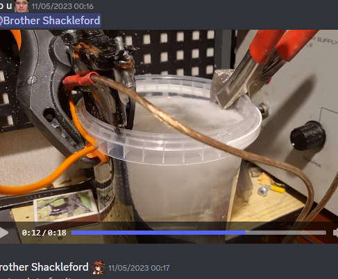

graphite foil and carbon fiber sleaves actually lasts longer than dense graphite plates and is a good alternative.
This video below is an example of graphite foil being used for long periods.
https://www.youtube.com/watch?v=f5sY3rEAdes
Below is carbon fiber sleave electrode
carbon sleave.png - 376kB
