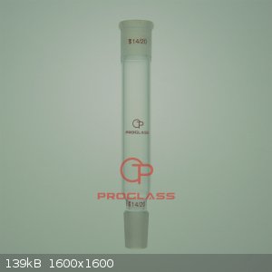

Could this 14/20 connector be used as a glass packed column?

separation of products with a 1oC difference in bp is difficult with a fractionating column,
impossible with a simple distillation.

I have a cheap Chinese 2-stage rotary vane oil vacuum pump which reduces b.p. of 2-nitrotoluene from 220 to 70 C. So the pump is unsuitable for distillation of anything boiling in range 150-200 C, for that I use water aspirator pump.
Even good column (= long enough, that means upto 1 m) with good packing (that means e.g. Raschig rings) and good insulation (vacuum jacketed) has reduced efficiency at vacuum level due to reduced pressure of vapor. The efficiency depends on the exchange between upwards flow (vapor) and downwards flow (condensate) - so a variable reflux ratio adjustable distillation head is necessary.
