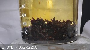

The prep went smooth as a cake. I followed the exact same procedure as per the literature including the stoichiometry. I will post some images and video link to my prep here. I will also include the link to the literature here.
figure 1 and 2 : 1,4 dimethylpyridinium iodide
figure 3 and 4 : red precipitate mentioned in the literature just prior to MOED
figure 5 and 6 : MOED crystallizing out and MOED after drying
figure 7 : Solvatochromism demonstrated in various solvents
THE LINK TO SYNTHESIS DEMONSTRATION VIDEO : https://youtu.be/Bs0ffWv2YQA

[*] posted on 24-9-2023 at 04:05
@vibbzlab, how long did you reflux the initial reaction mixture? The paper by Minch et al says 24hrs but I am trying a modified reaction using 3,4-dihydroxybenzaldehyde and after 2 hrs the reaction mixture is almost solid!! The ppt is a beautiful deep crimson as in your photo's.
