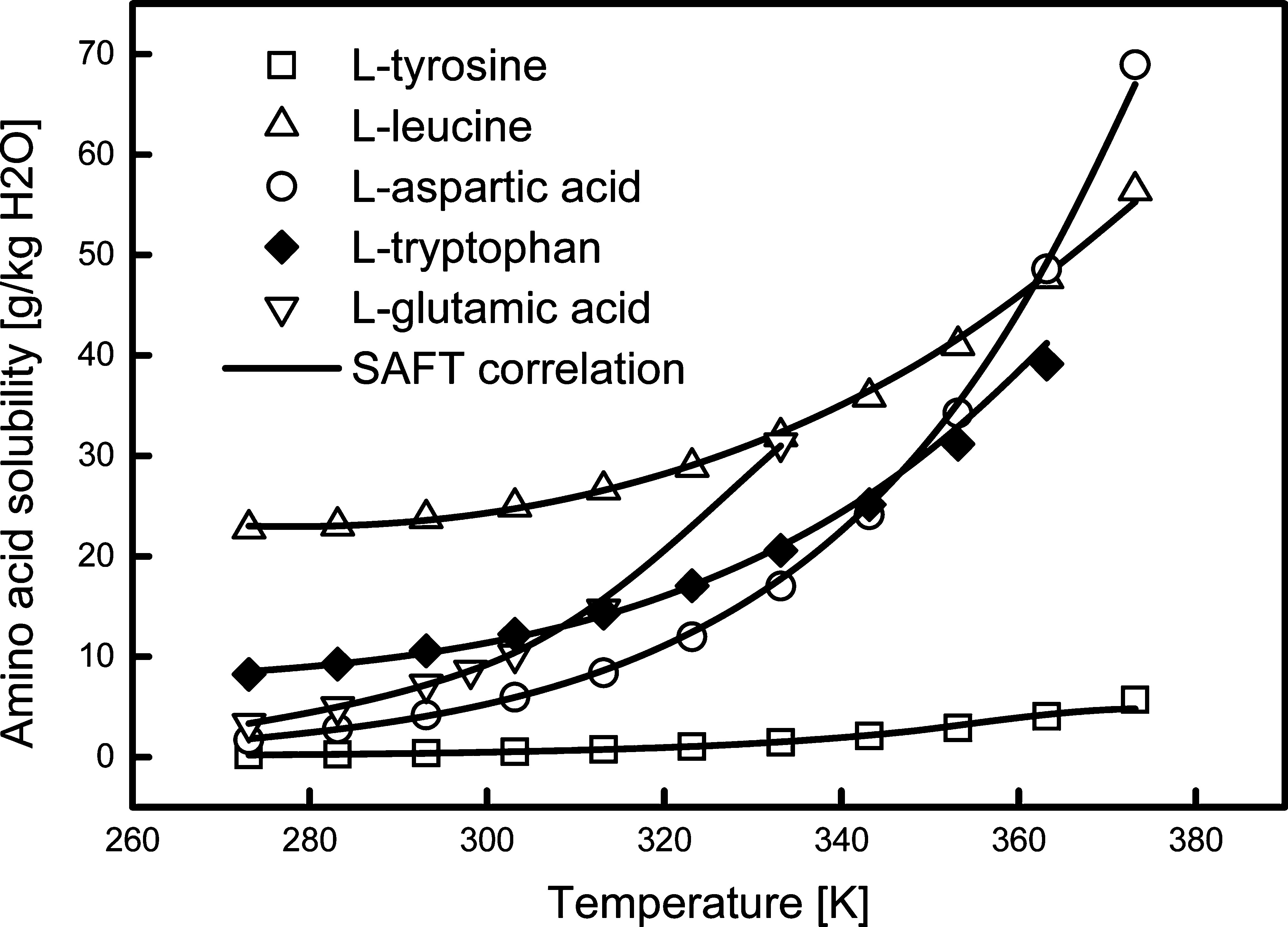

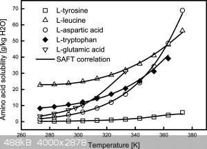

I've tried titrating MSG with hydrochloric acid, and I never got a precipitate, so I'm guessing that my pH control isn't fine enough. How would I recrystallize the acid? It seems to have very low solubility in water.

[*] posted on 22-6-2023 at 00:25
When you don't get a precipitate my first guess is you used too much water. A concentrated MSG solution gives a very thick precipitation.
Recrystallization is done with hot water, with higher temperatures solubility goes up significantly.
images_large_ie-2008-00313h_0001 (1).jpeg - 488kB

I'll try acidifying a more concentrated solution of MSG. Thank you for the solubility data!
