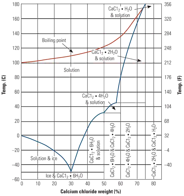

The melting of the sulphur is mediated by a calcium chloride brine with a concentration in excess of 35-40% CaCl₂ by mass, which is required to elevate the boiling point of water above 115-120°C, which is the temperature range quoted for the melting point of the alpha and beta sulphur allotropes.
Calcium_chloride_solution_graph.png - 34kB
According to this phase diagram, the maximum boiling point of a calcium chloride brine could reach an astounding 175°C at a concentration of 78% CaCl₂ by mass, beyond which it collapses to the dihydrate.

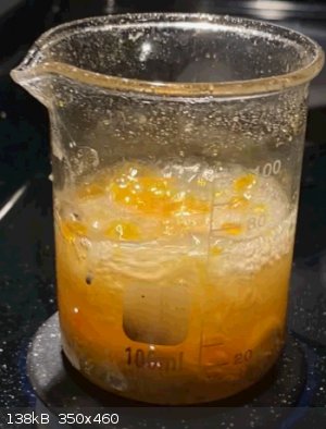

Melting_pot.png - 138kB Molten_sulphur.png - 196kB Sulphur_patty.png - 92kB
A beaker of melting sulphur, a large red globule of molten sulphur floating atop the brine, and the same glob, crystallized as a shiny yellow 'patty'. Brief video available here.
The sulphur globs, which are surprisingly fluid, typically don't entrain the calcium chloride brine as they solidify due to their high cohesion, which I'm guessing is due to the difference in molecular polarity between the polar brine and the non-polar orthorhombic octasulphur (S₈) molecules. Nevertheless, the sulphur beads can be broken apart and washed clean to ensure their purity.
