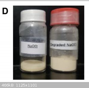

The paper you referenced contains a picture of sodium ethoxide in a jar. It is tan. Did you read it?
Attached, for reference.
IMG_3764.jpeg - 466kB

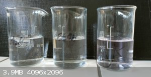

I decided to check if EtOH is truly oxidized by O2 in alkaline environment to acetaldehyde. I used Schiff's reagent to test it. I have some leftover solution, which is several months old, so I firstly tested if it is ok using 5% formaldehyde. Reagent produced strong red coloration, so it's still usable.
I dissolved 2 g of NaOH in 75 ml of 95% ketone-free EtOH. I bubbled air through it for 2h. Then I added 50 ml of water and 1 ml of sample (H2O, EtOH, NaOH+EtOH) in to 3 beakers and addjusted pH to 3 using dilute H2SO4. After that I added in to each beaker 1 ml of Schiff's reagent. After 10 minutes beaker with NaOH+EtOH sample was slightly pink in colour. Colour was weak but still clearly visible. Beakers with EtOH and H2O samples were colourless.
IMG_20230722_085839.jpg - 3.9MB

Thanks Bedlasky. Your experiment clearly proves clearly_not_atara hypothesis.

I repeated experiment today, this time using more soluble KOH and 4 h reaction time. I dissolved sample only in 25 ml of water, addjusted to pH 3 with sulfuric acid and added Schiff's reagent. After few minutes nice pink colour developed in the solution.
That water blank looks yellow on the photo, but it's actually colourless in reality.
IMG_20230723_104212.jpg - 3.8MB
