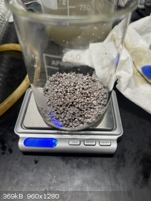

I followed the method used by NurdRage at a 2x scale: https://youtu.be/BsNoiFj3wlw?si=U34zZRGfd6MLti6O
28g of magnesium turnings
40g of NaOH granules
4g of menthol crystals
650ml paraffin oil
7.2g of starter sodium kindly donated by another SM member :)
All the above were added to a 2-neck 2000ml RBF with a hose adapter and tube leading into a cylinder of paraffin oil. A temperature probe was immersed into the 2nd neck and the temperature was set at 130c, held at that temperature, and stirred for 3 hours until the evolution of H2 gas had stopped. The reason for this is to allow the starter sodium to destroy any water present in the NaOH otherwise it will destroy the flask at high temperature. You don’t need the starter sodium as you can use lithium too or just sacrifice a flask.
The temperature was raised to 200c and held there for about 40 hours. Evolution of H2 gas began again and stopped at around 30 hours as paraffin oil began climbing up the tube. After 40 hours everything was left to cool down and the solids were filtered through a kitchen sieve. There was a little leftover Mg. The solids were then put into a flask of 300ml of 1,4 dioxane and refluxed for 2 hours. The heat was turned off, allowed to cool and the sodium floated to the surface while the little leftover Mg sunk to the bottom. The sodium was weighed in granules being 19.6g.
The sodium was then added to a beaker of paraffin oil heated to 105c to melt it and small squirts of isopropyl alcohol were added. The sodium all congealed into a nice ball and I played around with it in my hand. I cut it in half with a knife and observed its beautiful sheen. It is now stored in a bottle of paraffin oil where the outside of it has turned golden from reacting with the open air and maybe any impurities in the paraffin oil.
The theoretical yield of this experiment was 22.99g of sodium. I only got 19.6g minus the 7.2 starter sodium so 12.4g was made which means a 54% yield. Kind of disappointing as NurdRage got a 94% yield with the same method. My magnesium turnings are supposed to be quite pure so I assume it was my hardware store NaOH which probably contained a lot of water which could have lowered the yield. Anyway, it did work and I got an element that I’ve always wanted to see.
