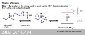

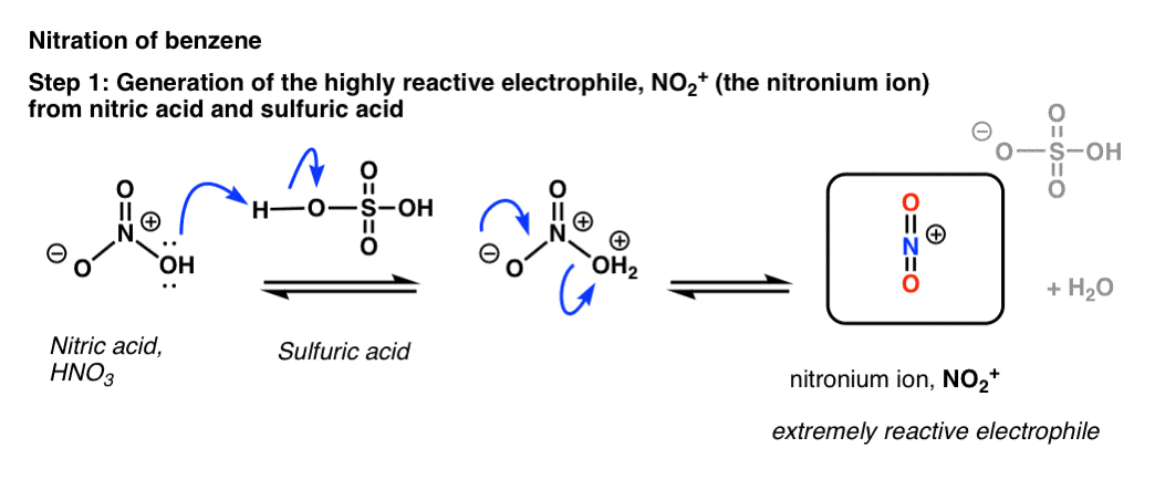

Below is the mechanism for aromatic nitration. Note that the nitration is carried out by a nitronium ion, which is generated by nitric acid deprotonating sulfuric acid. This step is only favouried because sulfuric acid is a much stronger acid than nitric acid and likely also because the sulfur is in a relatively high oxydation state, as opposed to the Cl ion in hydrochloric acid (but correct me if this hypothesis is wrong). So, simply because NaHSO4 is a relatively weak acid, this reaction is not favoured. You would need to add a very large excess of NaHSO4 to shift the equilibrium above to the right, so your nitration (if it occurs at all) would likely be extremely slow.
2-nitration-of-benzene-using-hno3-h2so4-giving-nitronium-ion-mechanism-step-1.gif - 24kB
