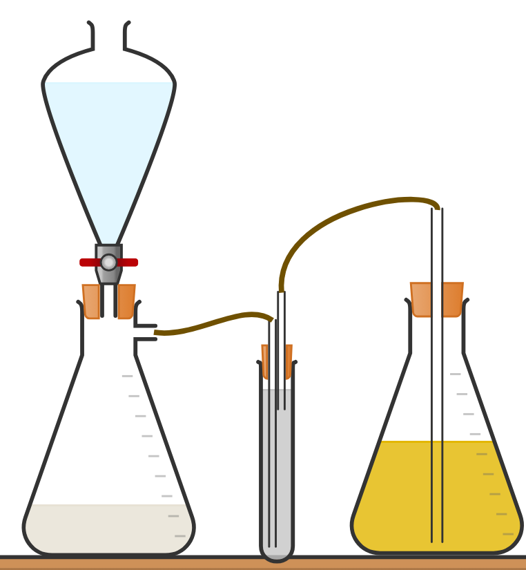

Step 1: Setup a chlorine generator (the simplest way I could come up with):

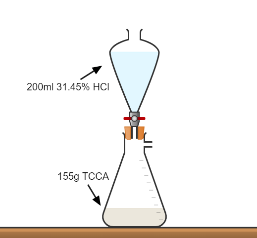

A glass filtering flask is charged with 155 grams of TCCA (or 143 grams of Ca(OCl)2). A separatory funnel with 200ml of muriatic acid (or 270ml if Ca(OCl)2 is used) is placed on top.
Screenshot 2024-11-10 153403.png - 20kB

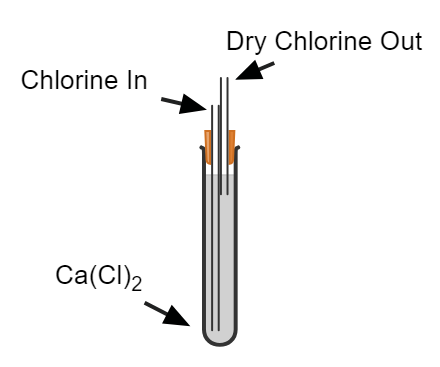

Step 2: A gas dryer (to dry the chlorine) is set up. A test tube is stoppered with a bung and a glass (or a suitable plastic) tube is inserted to the bottom. A second tube is connected that just barely enters the test tube. The test tube is filled with anhydrous (or monohydrate) calcium chloride.
Screenshot 2024-11-10 154038.png - 13kB

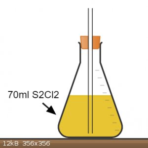

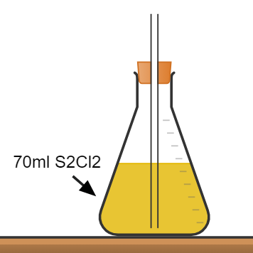

Step 3: 70ml (1 mole, 135 grams) of S2Cl2 is charged into an Erlenmeyer flask. A glass (or a suitable plastic) tube is placed into the S2Cl2.
Screenshot 2024-11-10 154631.png - 12kB

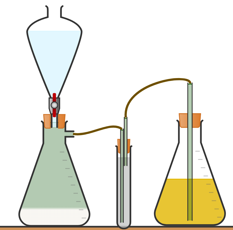

Step 4: The entire apparatus is assembled.
Screenshot 2024-11-10 155356.png - 51kB

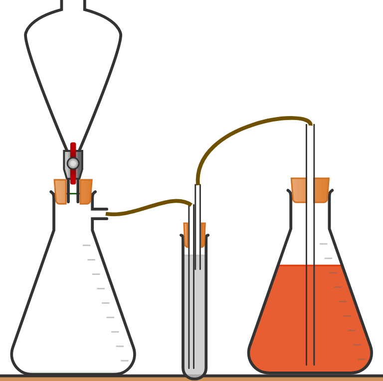

Step 6: After all of the muriatic acid has been used up, the S2Cl2 should have changed color from yellow to red as it was converted into 2 moles (205 grams, 127ml) of SCl2.
Screenshot 2024-11-10 155920.png - 49kB

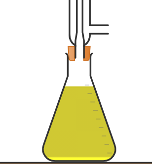

Step 7: The chlorine generator, dryer, and input tube is disconnected and removed. The Erlenmeyer flask is charged with an excess (>65 grams) of sulfur, fitted with a condenser, and set up for reflux.
Screenshot 2024-11-10 160335.png - 14kB

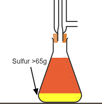

Step 8: The solution is refluxed until it changes color to back to yellow and most of the sulfur is gone.
Screenshot 2024-11-10 160542.png - 10kB

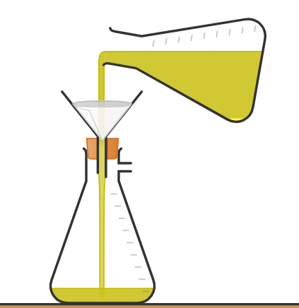

Step 9: The condenser is removed and the solution is filtered to remove the unreacted sulfur.
Screenshot 2024-11-10 160958.png - 24kB

In picture 4, you need a trap (I forgot how it is called) after the drying tube to prevent suck back. For the drying tube, a flask with concentrated sulfuric acid. To make it even safer, two traps after the drying tube.

Posts: 3826
[*] posted on 3-12-2024 at 09:36
Bofis:
would have thought that you will also need a vent with a chlorine scrubber on the final flask, at least to start with or you will never get the chlorine into the finalpl flask.
4-stroke:
I'm a little confused by what you are saying here. Do you mind explaining?
The stopper in the Erlenmeyer used for bubbling has only one hole,
there is nowhere for excess gas to escape so internal pressure will increase
the pressurised chlorine gas will bubble up through the addition funnel the next time the stopcock is opened...
If the pressure is high a violent eruption of HCl and chlorine will occur.
Not good
Plus, when bubbling chlorine I always get unreacted bubbles reaching the surface and escaping,
so a scrubber is used to absorb and/or neutralise the excess gas.
PS nice drawings, I must learn one day.
and, moist chlorine gas corrodes rubber quickly - I can vouch for that.!
and, have a brief read about 'suck back'
[Edited on 3-12-2024 by Sulaiman]
