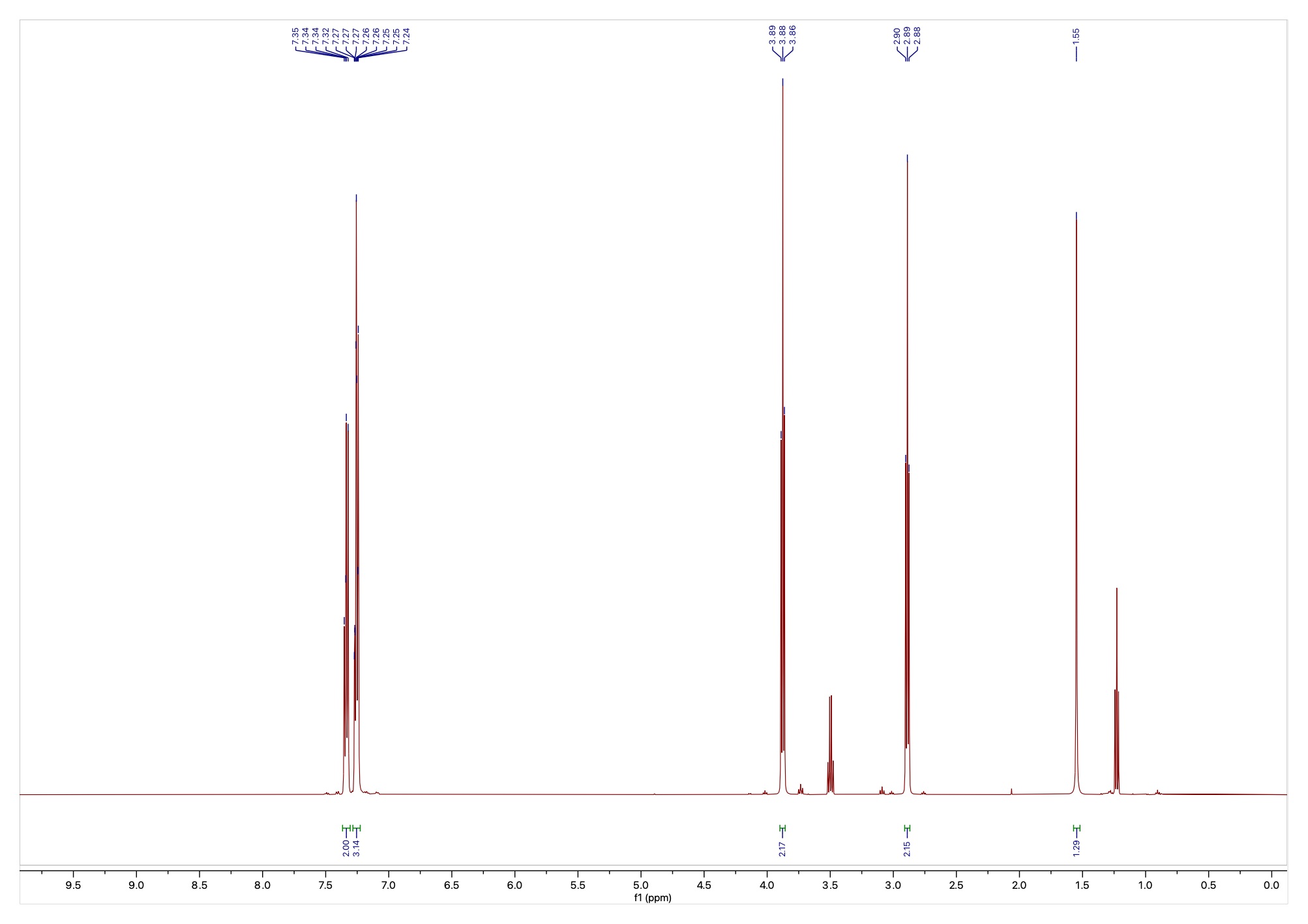

I decided to try this procedure myself today on the side at work and get an NMR of the result. I ran it on a 1 gram scale and extracted the product with diethyl ether since it was a little more difficult to separate from the aqueous layer on the smaller scale. I also dried it with K2CO3 instead of CaCl2 so that residual HCl would be removed. Otherwise I did everything the same as Maui3 described.
The verdict is...
Screen Shot 2025-01-09 at 4.10.50 PM.png - 183kB
It's all starting material. No sign of styrene or either alkyl chloride. The unlabeled peaks at 3.5 and 1.2 are extraneous diethyl ether because I didn't have it on the vacuum long enough.

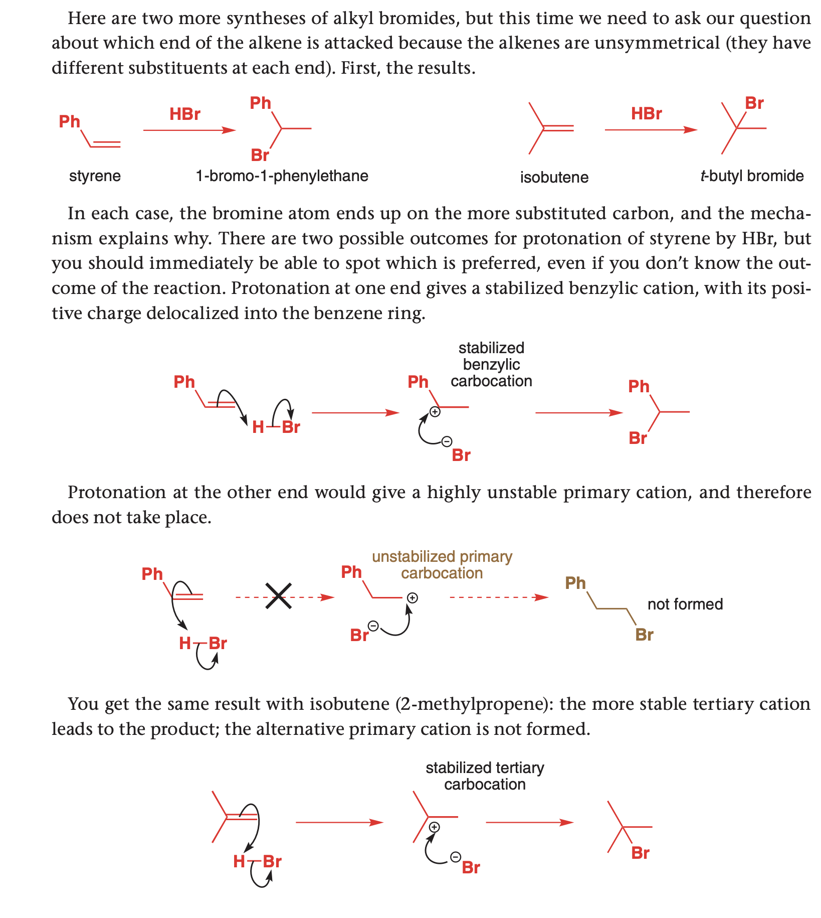

I would expect the Br from HBr to add at the 1-position because of rearrangement of the carbocation.
This is different from direct bromination by Br₂ under UV light or NBS, which form bromine radicals Br•. These radicals are ‘acroselective’, they add at the terminal carbon because this structure is more stable. See, for example here.
[EDIT: Add textbook excerpt]
