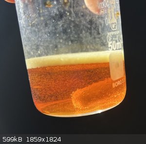

Let me know if more details or photos of my setup would help clarify things. I’ve included photos of:
The anthranilic acid solution right after diazonation and "sulfonation".

IMG_0852.jpeg - 626kB IMG_0854.jpeg - 609kB IMG_0850.jpeg - 599kB

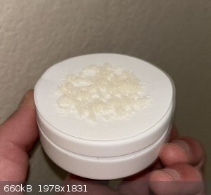

Saccharin precipitated out of the solution and was then filtered, washed thoroughly with cold water, and recrystallized twice from ethanol for purification
My yield was 1g, which is only 22% of theoretical. I’m confident that a large portion of that came from transfer losses and the two recrystallizations, I got a bit sloppy near the end of the synthesis. The tiny scale obviously didn’t help either. I didn't really bother with being very exact with the amount of gas I used since they're cheap and the scale was so small, but I imagine this would become necessary if I was to scale this reaction up.

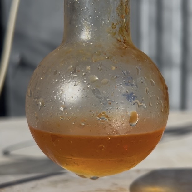

IMG_1079.jpeg - 51kB
Mixture immediately after diazonation

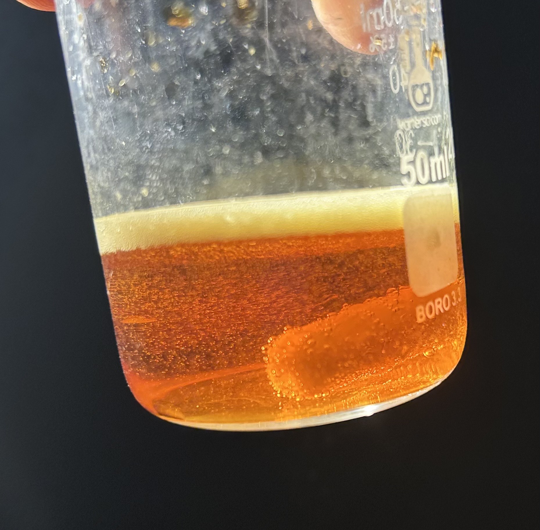

IMG_1080.jpeg - 60kB
Nitrogen evolution after addition of the copper catalyst

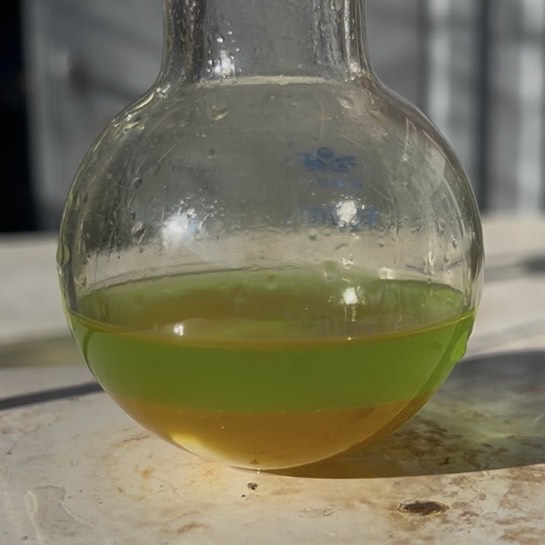

IMG_1081.jpeg - 44kB
Mixture after chlorination

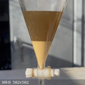

IMG_1082.jpeg - 36kB
Separation after ammonia addition
IMG_0897.jpeg - 660kB
Final Product :D
