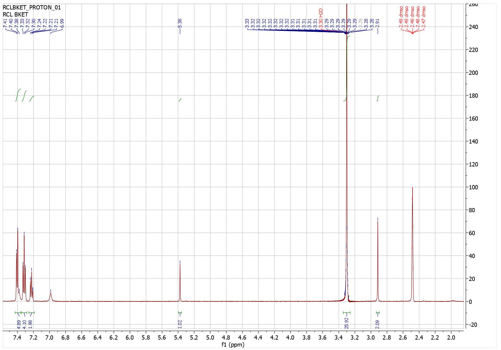

Further analysis of the product
I‘ve now analyzed two samples of the modafinil by 1H-NMR, one before and one after the ethylacetate washings.
The spectrum of the final washed product overall looks really good, almost perfect really, so it’s surprising there was still an impurity present on the TLC. Either way this means it’s likely present in way too little of a quantity to really worry about.
