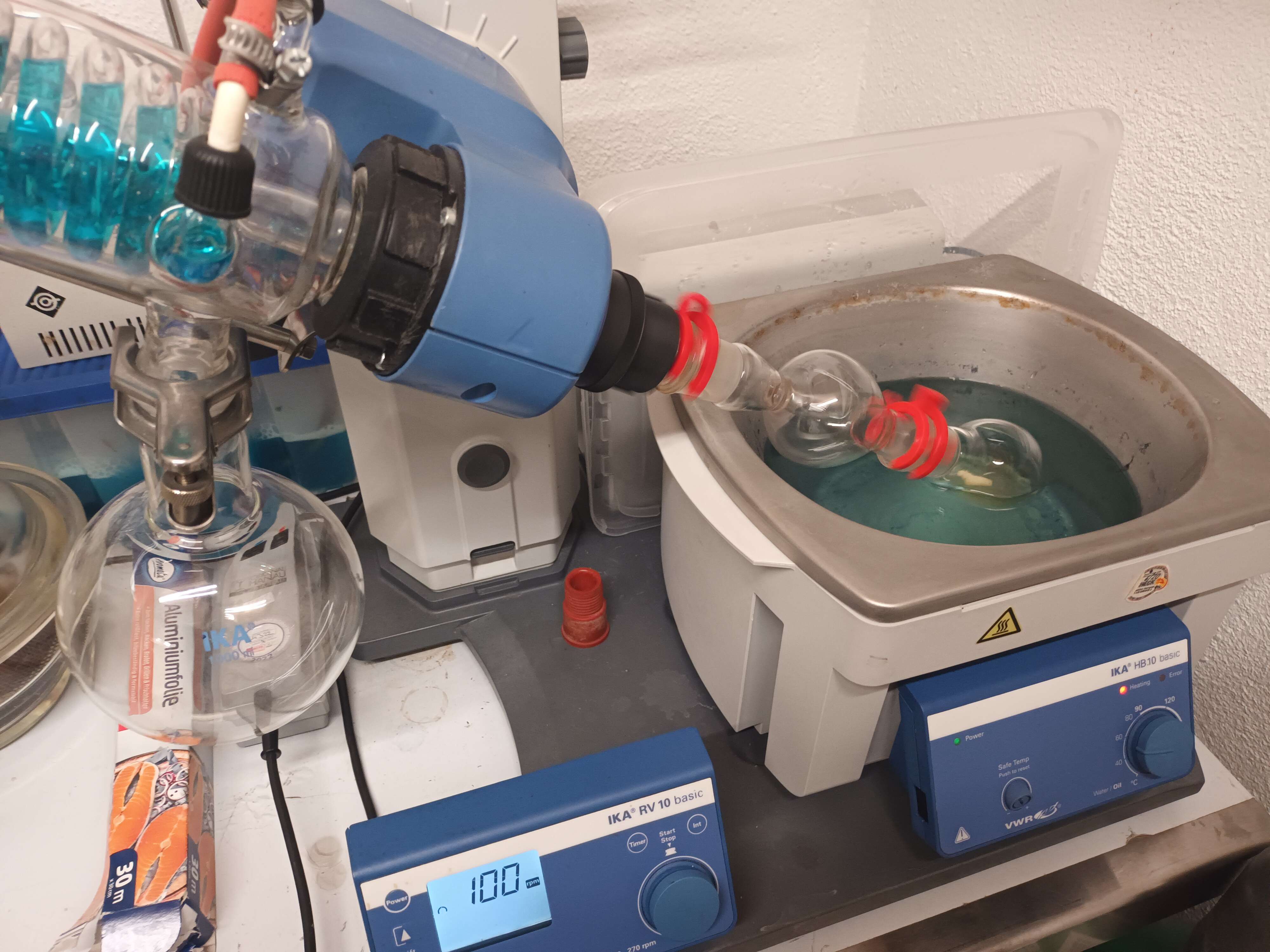

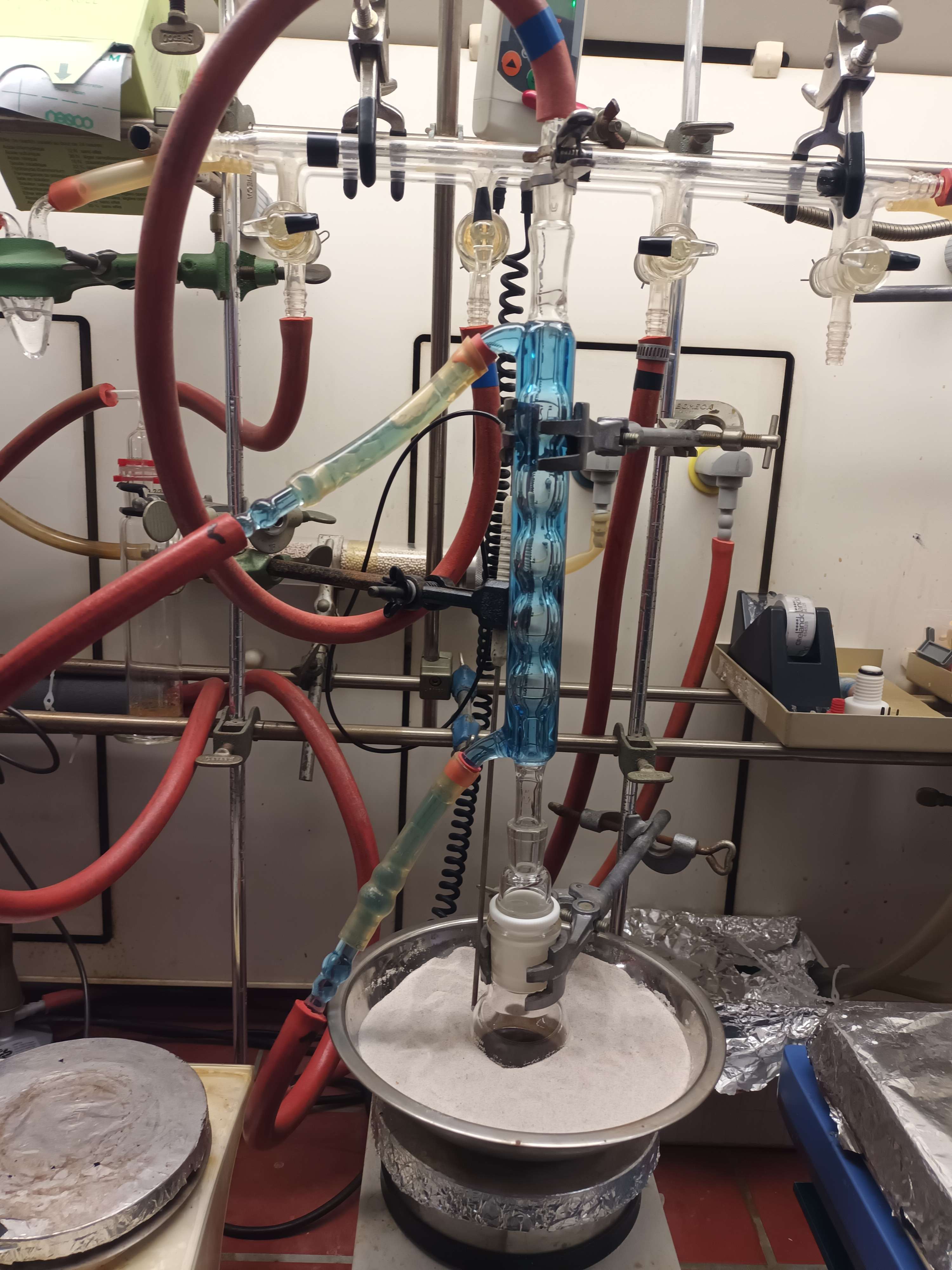

Synthesis of Cyclopentanone ethylene ketal (1,4-dioxaspiro[4.4]nonane)
A 2 l round bottom flask, set in a glycerol bath on a magnetic stirrer, was charged with 400 ml cyclopentanone (4,52 mol) and 800 ml cyclohexane as the solvent. The mixture was stirred to result in a clear solution, 640 ml of ethylene glycol (11,48 mol) added forming a separate layer, followed by 5 g of strongly acidic cation exchange resin as the catalyst (Note 1). A Dean-Stark apparatus utilizing a Dimroth condenser was set up, and the mixture heated to a reflux by warming the glycerol bath to 120 °C until the water generation had largely subsided, in total collecting 310 g of distillate (Note 2).
After cooling the now light yellow cyclohexane layer was decanted from the small amount of unreacted glycol and the cation exchange resin, the dark yellow glycol layer extracted twice more using 50 ml cyclohexane each, and the combined extracts dried over anhydrous sodium sulfate. The drying agent was removed by filtration through a piece of glass wool, the cyclohexane removed by rotary evaporation, and the remaining clear yellow solution, which has a strong characteristic smell, transferred to a 1 l three-neck round bottom flask set up for fractionated vacuum distillation through a 20 cm Vigreux column, utilizing an Anschütz-Thiele adapter to allow to take fractions. The crude product was then distilled under vacuum (Note 3), first collecting around 150 ml of distillate at 36-39 °C likely consisting of residual cyclohexane (Note 4), and then, after increasing the vacuum, finally the product at 102-105 °C while simultaneously increasing the glycerol bath temperature from 120 to 150 °C to allow for a constant distillation rate. From this 496,6 g (87,5%) of a clear colorless liquid having a strong characteristic smell (Note 5) were collected. n20D: 1.448 ; 1.448 (/ 1.469) lit.
Note 1: The cation exchange resin used was purchased from Merck KGaA. Alternatively para-toluenesulfonic acid may be used as a catalyst and toluene as the solvent, initially resulting in a much darker reaction mixture, but still ending up in an acceptable 80% yield. In this case one has to neutralize the acid by washing with sodium carbonate solution before the distillation though.
Note 2: As excess glycol is used, which forms more water on cyclizing to 1,4-dioxane, the quantity of water collected is not a good indicator for the end point of the reaction (the theoretical maximum would have been around 81,5 g). To avoid excessive refluxing one can track the progress of the reaction by TLC (4:1 hexane / ethylacetate) using a vanillin stain.
Note 3: One has to keep the vacuum somewhat low initially as the mixture tends to foam really strongly, at the time I didn’t have my vacuum gauge connected, but based on the boiling point of the presumably cyclohexane fraction I would assume pressure of around 220 mbar. One may also just remove the cyclohexane at atmospheric pressure to get around the issue of foaming entirely.
Note 4: Even though this fraction had a clear ketal smell redistillation did not yield any notable quantity of additional product.
Note 5: I find it really hard to describe its smell and even after discussing with other people having handled it we did not manage to come up with a good description. In literature its smell is oftentimes described as “minty“, but to me that seems completely off.
Pictures:
20250328_173706.jpeg - 657kB
Fig.1 The apparatus used for the reaction

Fig.6 Removal of the cyclohexane by rotary evaporation

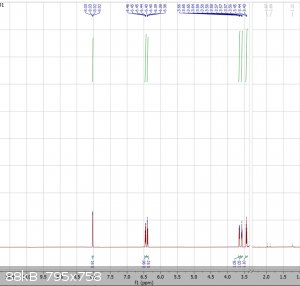

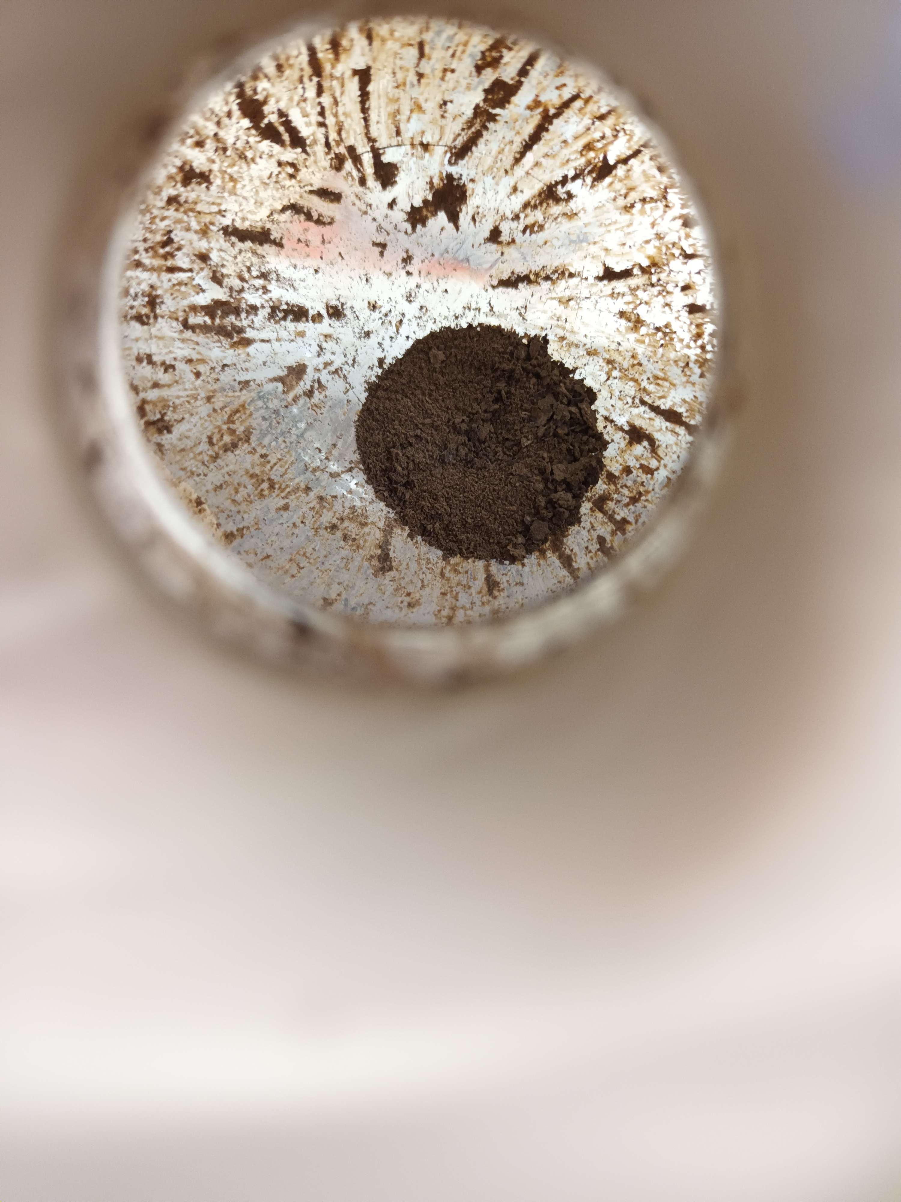

endo-2,4-Dibromodicyclopentadiene-1,8-dione (“Bisketone“):
While stirring magnetically, to a 250 ml round bottom flask charged with 90 ml of 96% sulfuric acid, was added all the previous product (73,3 mmol) in portions resulting in a dark brown solution, the flask capped with a stopper, and the mixture stirred for 36 h at room temperature (as it was currently around 10 °C in the lab the flask was submerged into a water bath warmed to 25 °C). During this time the solution further darkened to almost a black color, and the product was precipitated by carefully pouring into 500 ml dest. water. After cooling the solid was removed by vacuum filtration through a Büchner funnel and washed acid free using dest. water, from what, after drying under vacuum, 20,69 g (88,9%; 84% lit.) of a beige solid resulting melting at 162-164 °C (164-165 °C lit.) (Note 1).
For further purification things were recrystallized from ethylacetate (around 120 ml required) with a spatula of activated charcoal added to remove colored impurities. On cooling to -20 °C 13,86 g of a slightly off-white crystalline solid were collected as the first crop, and on evaporating to a volume of around 20 ml under vacuum and once again cooling in the freezer 2,85 g (71,8% total; 88,9% lit.) further product, being ever so slightly darker, could be collected (Note 2). This product appears to have quite a reasonable purity according to 1H-NMR analysis (DMSO-d6).
Note 1: As the following [2+2]-cycloaddition tends to quickly darken anyway this product may likely already be sufficiently pure to be processed further.
Note 2: Another small crop could be isolated by concentrating down to a volume of around 5 ml I have not yet gotten to filtering.

20250216_100718.jpeg - 483kB 20250403_183453.jpeg - 412kB
Fig.14-15 The crude (left) and recrystallized (right) bisketone

Fig.16 The NMR spectrum of the final bisketone product

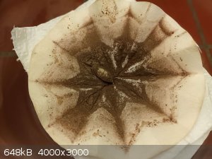

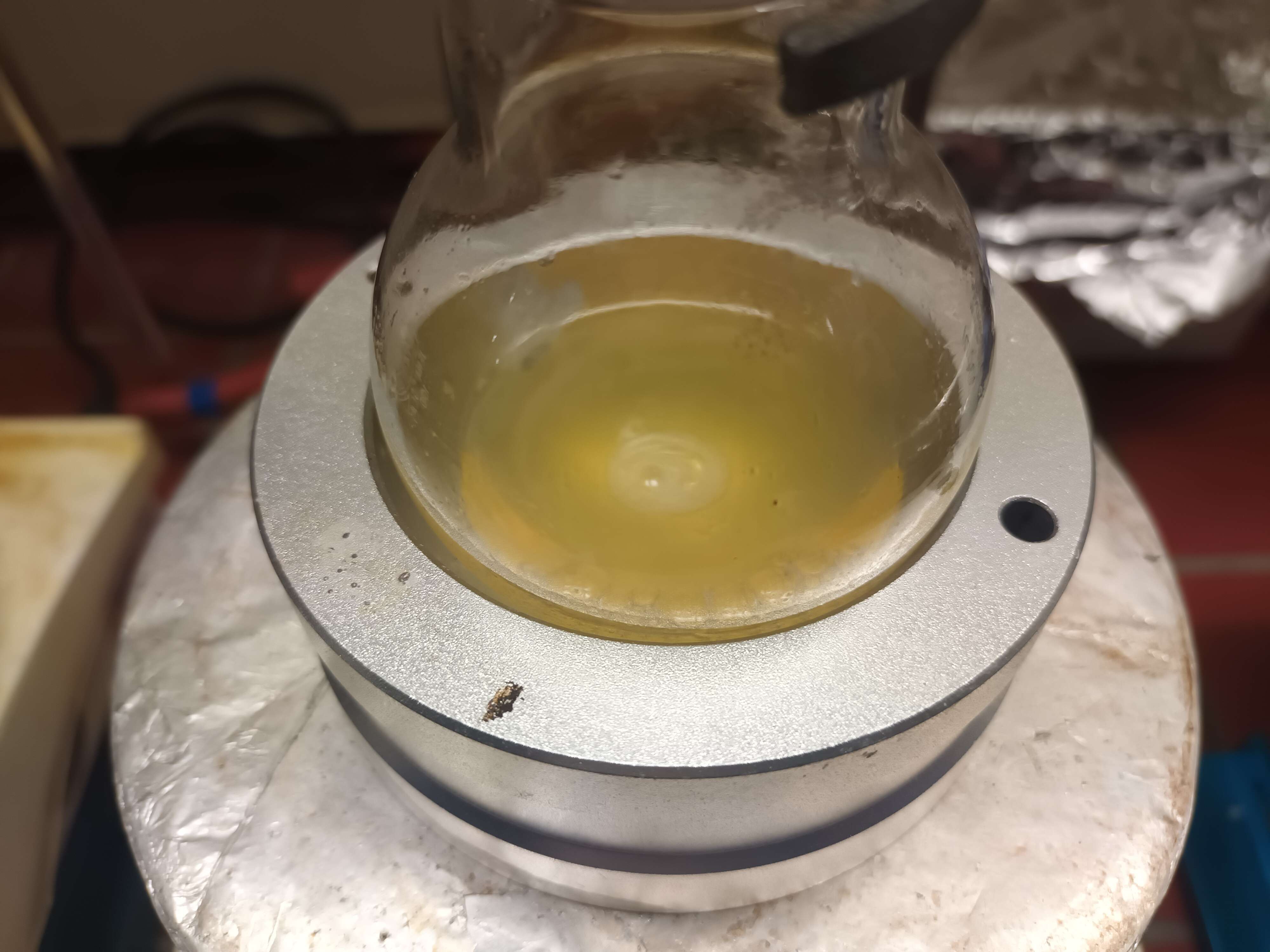

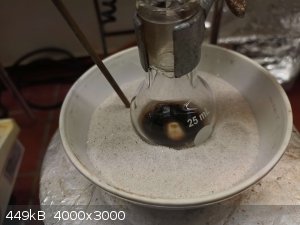

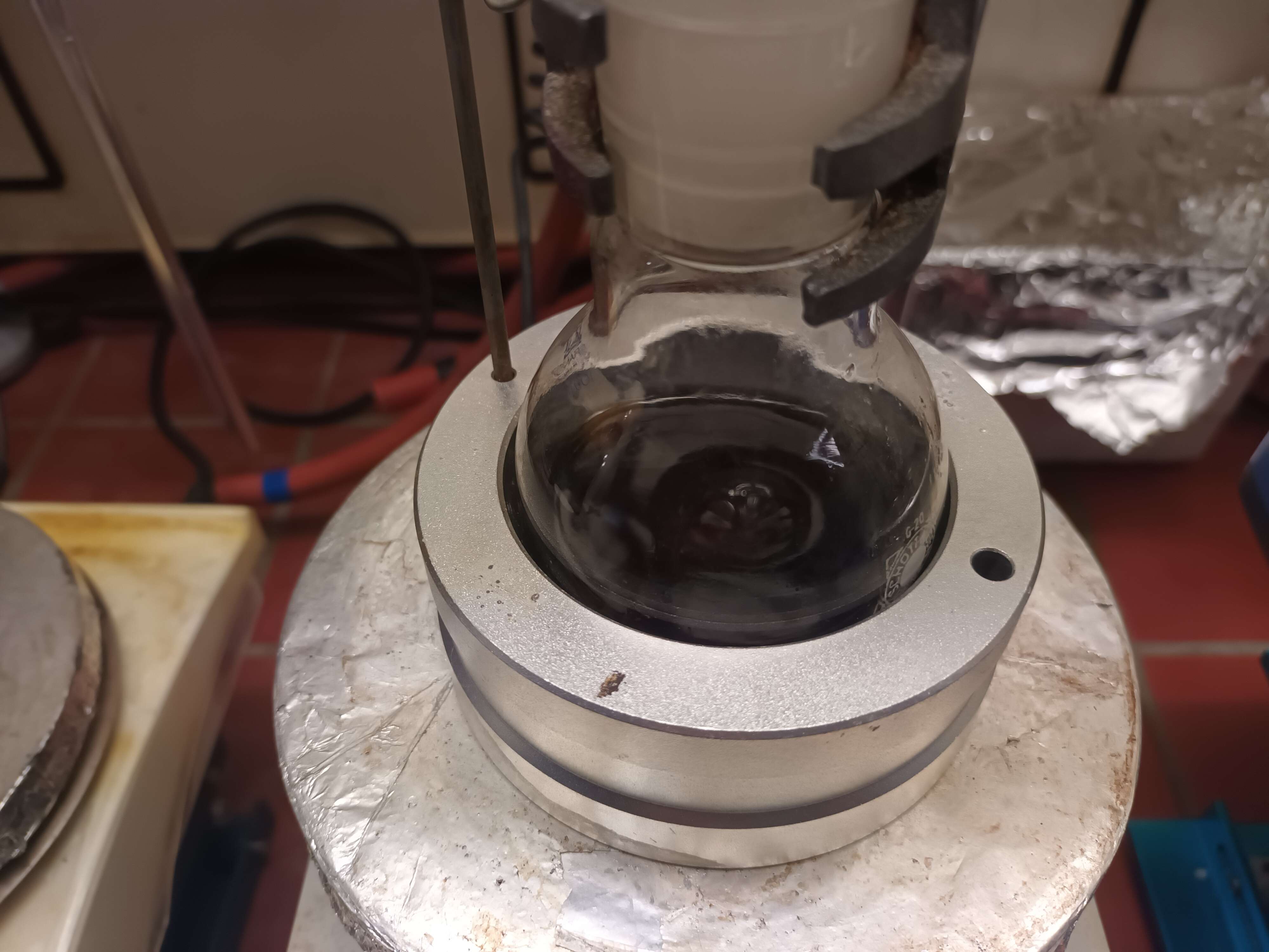

Quote: Originally posted by Niklas

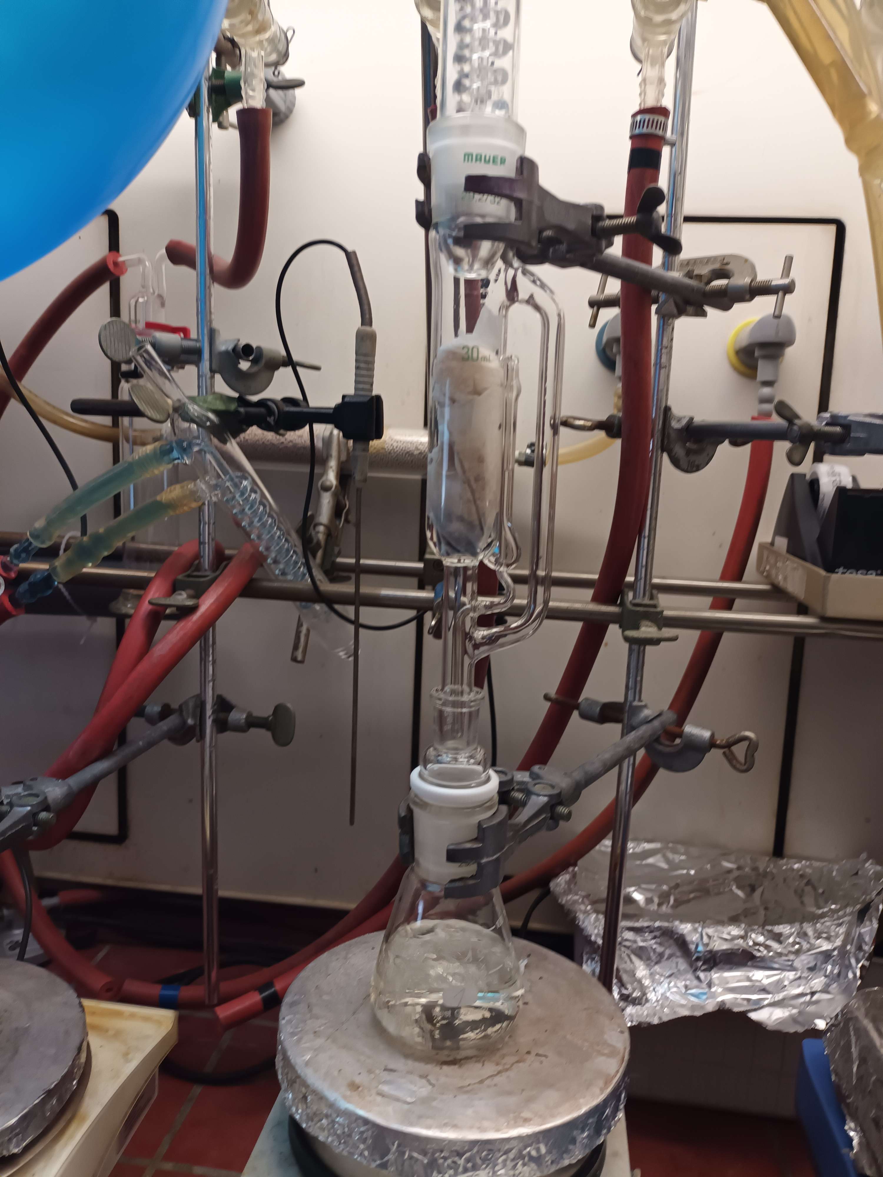

Note 1: The cation exchange resin used was purchased from Merck KGaA. Alternatively para-toluenesulfonic acid may be used as a catalyst and toluene as the solvent, initially resulting in a much darker reaction mixture, but still ending up in an acceptable 80% yield. In this case one has to neutralize the acid by washing with sodium carbonate solution before the distillation though. [Edited on 5-5-2025 by Niklas]

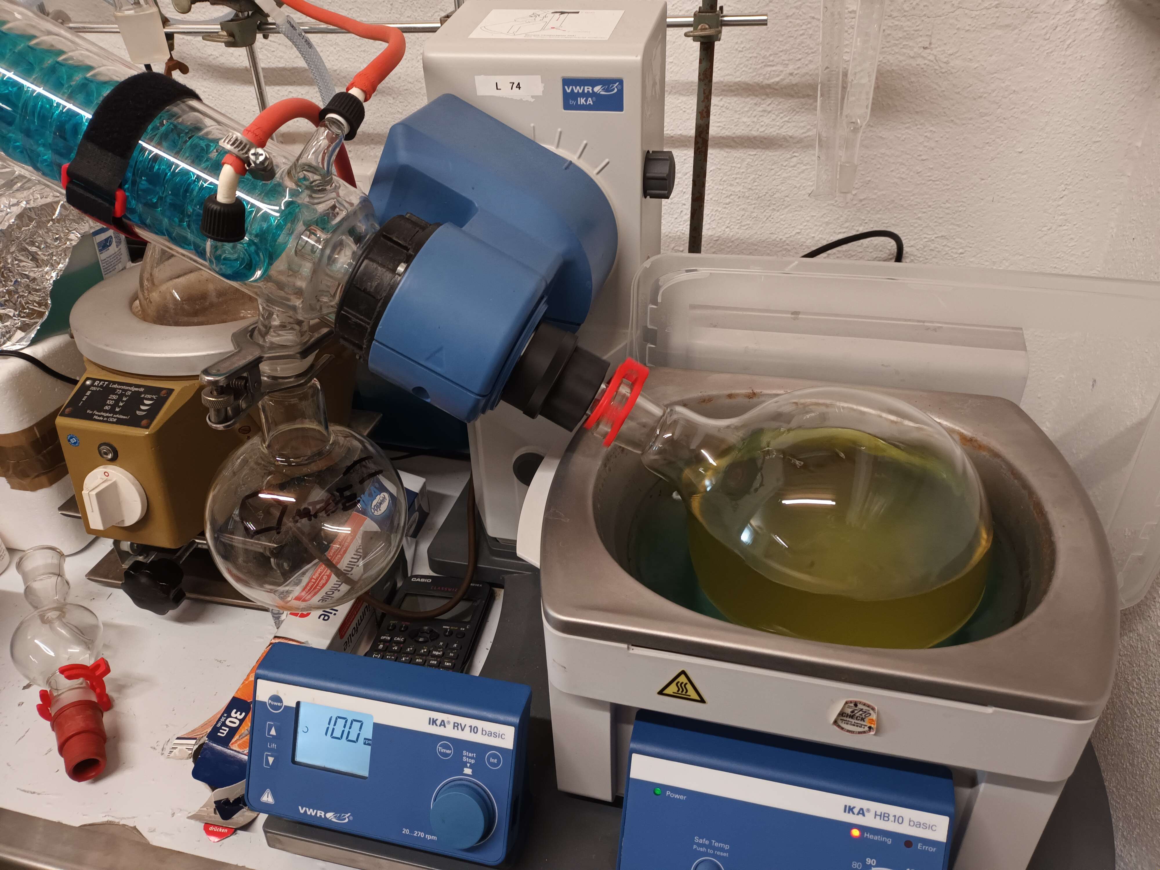

A further note on this, after some discussion with Saffron Ravenspear I deem it likely that when using TSA the distillation rate has a large impact on the rate of darkening / tar formation, with fast reflux rate being preferable, as with a slow rate the water can stay around in the reaction mixture, likely allowing some TSA to turn back into sulfuric acid, which then causes the formation of colored aldol type products (both from the cyclopentanone and acetaldehyde which likely forms from the excess glycol).
When I did things I refluxed things rather mildly so I can feel safe running things over night, while Saffron vigorously refluxed in a 250-300 °C heating mantle, and for me as I mentioned things resulted in a really dark red mixture, while for Saffron it ended up being a light yellow. It is worth mentioning though that the color, as far as there isn’t actual solid tar, isn’t a good indicator for the end result as my yield of 80% still ended up being more than satisfactory and actually exceeds Saffron‘s yield, probably as I ran it for fives day straight rather than “just“ three days, or because I used a larger excess of glycol which seems to help with the yield quite a bit, or both, who knows.
IMG_2282.jpeg - 877kB IMG_2285.jpeg - 644kB

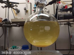

Also on the UV step, I ended up dropping the lamp and breaking it (whoops), but luckily the company was kind enough to give me a refund as there appeared to be a malfunction anyway so in the end it’s just delaying things slightly.
20250513_174325.jpeg - 685kB

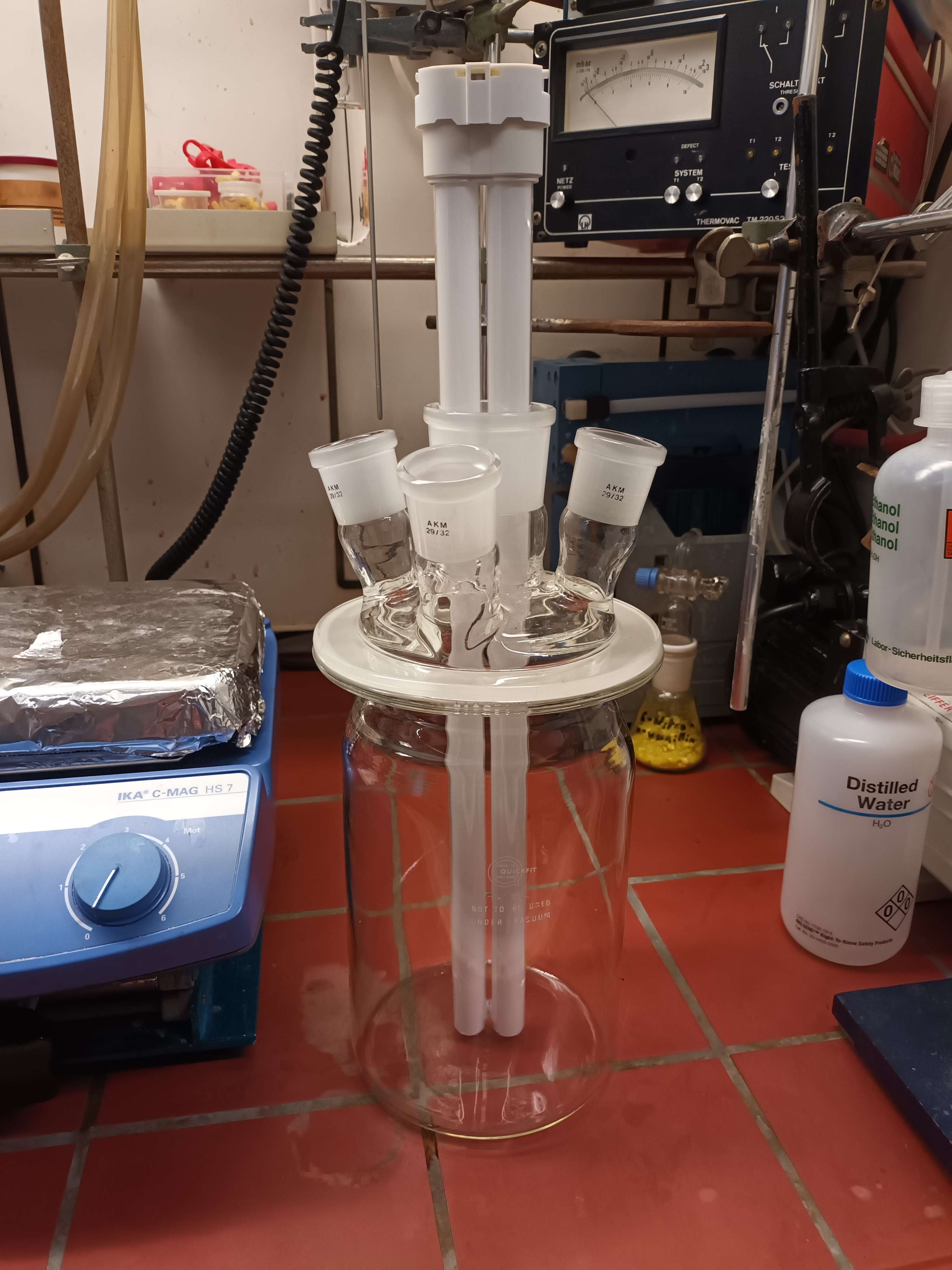

And when I‘m already at it, I recently managed to cheaply get a 2 l reactor with a NS45 central joint (30€ including a few more pieces of glassware), and I‘m planning on using that on scaling up the UV step. I just gotta get a fitting internal tube, but that should be cheap to just get custom made. For cooling I‘ll just put reactor in a bucket and let a stream of cold water from my thermostat chiller run over it.
20250509_193837.jpeg - 516kB IMG_9287.jpeg - 201kB

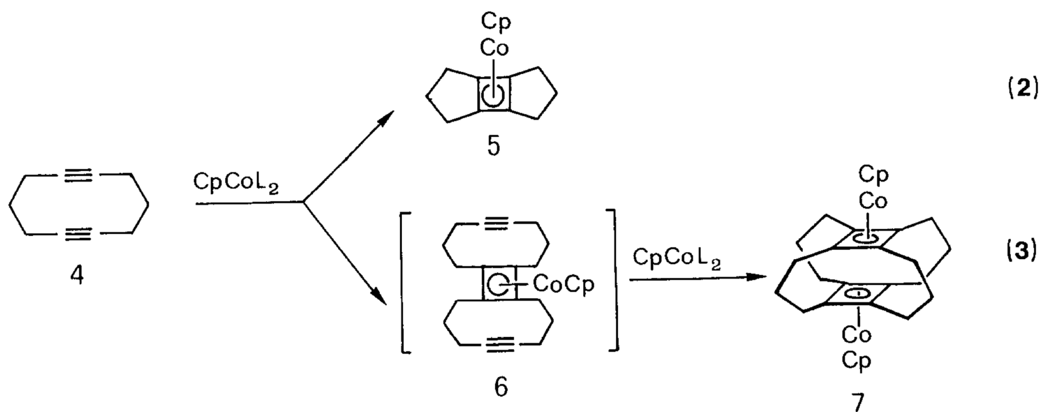

I was recently reading about a theoretical derivative called "hypercubane" which would resemble the 4-dimensional cuboid, called a tesseract or hypercube. I wondered if it could be possible to synthesize this from cubane. So, I did a bit more reading.
I was thinking, monohalogenated cubane could undergo dehydrohalogenation to cubene, which is unstable, but easily partakes in Diels-Alder-type reactions. By applying the Hunsdiecker or comparable reaction to the dicarboxyl cubane, you should get the dibromo derivative, which can be used to get the cubene. This can be combined with butadiene to get the 3-cyclohexene-cubene fused ring product. This could continue until all four parallel bonds are occupied by cyclohexenes. Then, the rings would have to get ethylene bridges somehow...
What are your thoughts?

Hypercubane really is an interesting compound indeed, first read about I believe two years ago, and honestly put way too much thought into it since then, without ever coming up with anything good or practical. It doesn’t seem that hard to come up with a synthesis that would make it, but making that synthesis have a higher yield than 0.001% and short enough to actually be doable, well that’s the hard part.
Same I reckon unfortunately applies for the path you suggested, while it seems like a logical idea, this would only insert two of the cyclohexene rings with bad control of the regioselectivity (if we imagine using a dihalide accessed from the dicarboxylic acid), and that likely in a fairly bad yield as this is more of a capturing reaction than a synthetically viable one (milder elimination approaches of course make things more usable, but as those are based on AB-eliminations you‘d spend a whole lot more effort to still only end up installing two rings). And while I‘m sure there would be ways going from this, this would simply be unbelievably much effort with a lot of uncertainty connected.. Cubane and the typical derivatives just don’t feel like good starting points due to the inherent difficulty of late substitution and reactions on cubane, what most of my previous approaches had been based on is to create a top plane in some way, dimerize a corresponding cyclobutadiene derivative, and then connect the remaining four double bonds between the planes, but I ended up discarding most of that because of the quite impossible geometry of the required cyclobutadienes.

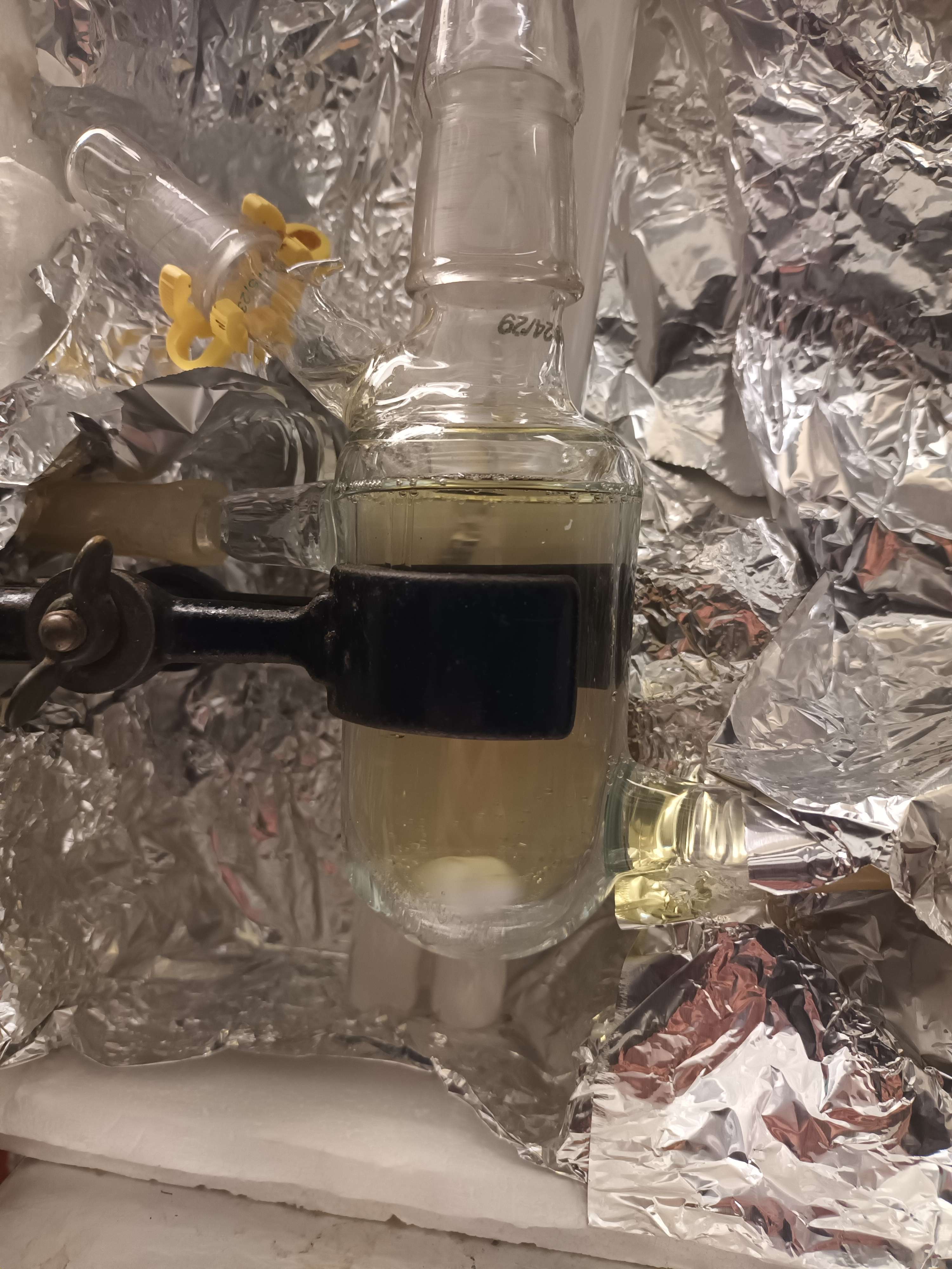

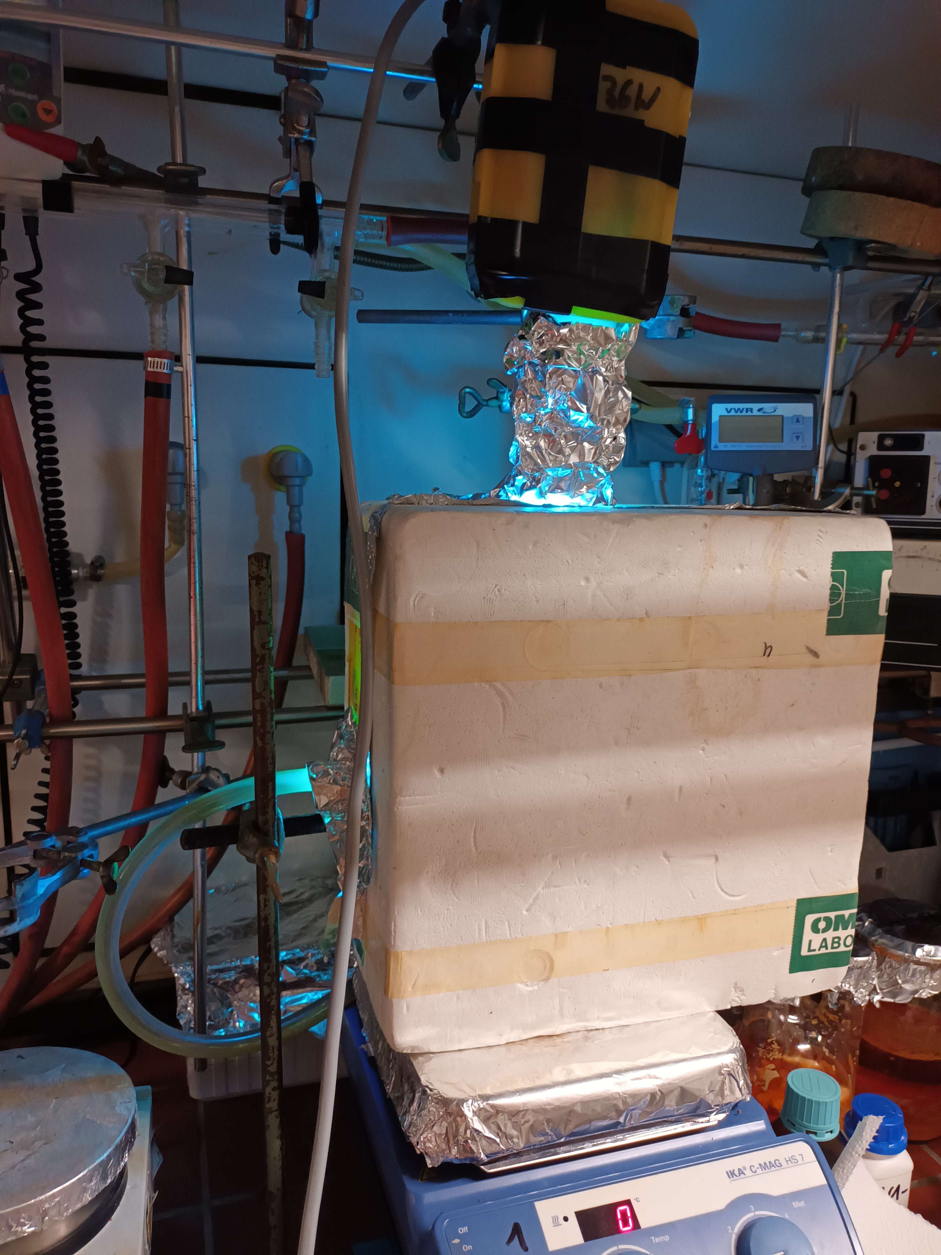

My latest idea I‘m taking in consideration is to use octa-cycopropylcubane or a similar derivative as a starting point, as this is available in two steps from dicyclopropylacetylene (https://onlinelibrary.wiley.com/doi/10.1002/anie.200605150), and already has the “octamethylcubane“ structure with the possibility of further substitution in place. But that was just a random thought I haven’t yet tried going from further. If I manage to come up with something I‘ll definitely mention it here though.
Anyway, new UV lamp is here, finally running as it should, this time being a little more careful with things.
20250516_172459.jpeg - 870kB
Directly set up a small test run of the [2+2] using 1,4 g of bisketone, following Bartoneks procedure, details will be given once I‘ll put together an actual writeup of that run like I did for the previous steps.
20250516_191543.jpeg - 790kB 20250516_213134.jpeg - 976kB 20250516_213619.jpeg - 949kB 20250516_213413.jpeg - 683kB

Small scale synthesis of crude cubane-1,4-dicarboxylic acid
The below [2+2]-cycloaddition was performed using a Philips UV-B PL-L 36W/01/4p 2G11 as described by Bartonek in [1]. The following Quasi-Faworskii was also performed according to this procedure.
Cubane-1,4-dicarboxylic acid (crude):
In a 50 ml double walled two neck reaction flask (Note 1), equipped with a gas inlet tube on the side neck, 1,4 g of the Bisketone (4,4 mmol) were suspended in a mixture of 45 ml methanol and 8 ml dest. water. 75 μl of concentrated sulfuric acid (1,4 mmol) were added with the help of an Eppendorf pipette (Note 2), and the mixture magnetically stirred until all the solids eventually fully dissolved resulting in a yellowish solution, which was then sparged with argon for approximately 15 minutes and the flask capped. The mixture was irradiated with a 36W UV-B narrowband lamp for 24 h while passing water through the mantle of the flask to cool (Note 3), after which the mixture had turned notably more yellow and no more bisketone could be detected on analysis with TLC (3:1 hexane / ethylacetate; cerium(IV)-sulfate / polymolybdic acid stain). Bisketone rf=0,45; Cage intermediate rf=0,09 (Note 4)
The product solution was transferred to a 100 ml round bottom flask, the reaction vessel washed out with more methanol, and the methanol then removed by rotary evaporation, resulting in a yellow aqueous residue which was diluted with 10 more ml of dest. water and heated in a heating block warmed to 110 ° C for 2 h (Note 5). After cooling a solution of 4,05 g sodium hydroxide (101 mmol) in 15 ml dest. water was added at once to the now orangish solution, causing things to instantly turn brown, and the resulting mixture heated under reflux for 5,5 h in a heating block warmed to 120 °C with an Allihin condenser attached. After cooling somewhat 10 ml of fuming hydrochloric acid were carefully added to acidify, and after cooling in the fridge the precipitated solid was collected by gravity filtration, washed with a little dest. water, and dried under vacuum till constant weight. From this 303 mg (35,8%; 68% lit.) of a light brown powder was collected which was used in the esterification without further purification.
Note 1: While borosilicate isn’t fully transparent at the required wavelength of around 315 nm a borosilicate reaction vessel will do just fine. As far as a narrowband lamp isn’t used it’s actually less preferable to use quartz as the borosilicate acts as a filter from the lower wavelengths which cause undesired side reactions to occur.
Note 2: The exact amount of sulfuric acid used doesn’t strictly matter. Therefore, in case a microliter pipette isn’t available, one may just add 1-2 drops of the acid.
Note 3: The lamp itself doesn’t require any cooling as its temperature doesn’t exceed approximately 60°C even on running for multiple hours.
Note 4: It is worth noting that the cage compound shown in figure 1 of the introductory post is almost fully present as the dihydrate to release ring strain, therefore explaining the high polarity and low rf.
Note 5: This step presumably serves the purpose of hydrolizing any dimethylketal that may have formed during the UV-reaction.
The yield honestly is kind of disappointing, but for a first run it’s acceptable I guess, besides that I still have some mother liquors to potentially concentrate and get more product out of.
Pictures:
20250516_191543.jpeg - 790kB 20250516_213619.jpeg - 949kB 20250516_213413.jpeg - 683kB 20250517_211444.jpeg - 715kB
Fig.1-4 The [2+2]-cycloaddition
20250518_105608.jpeg - 288kB
Fig.5 TLC of the reaction mixture
20250517_220953.jpeg - 591kB
Fig.6 Removal of the methanol
20250517_223417.jpeg - 436kB 20250518_104544.jpeg - 855kB
Fig.7-8 Hydrolysis of potential Dimethylketal byproducts
20250518_105157.jpeg - 407kB 20250518_105305.jpeg - 415kB 20250518_105300.jpeg - 662kB
Fig.9-11 The Quasi-Faworskii reaction
20250518_194933.jpeg - 626kB
Fig.12 The crude diacid

Having a type of immersion well reactor is by far the most efficient way to perform the UV step yeah. For small scale an external lamp is fine, not that you even really have an option in this case as the reaction vessel is much smaller than the lamp (what Saffron has been doing is to run the reaction in a Schlenk tube and have a cold finger inside for cooling of the mixture, thought that was quite a nice idea that doesn’t require as specialized glassware as I used), but on scaling like I’m planning in my 2 l reactor outside irradiation becomes really inefficient.
Talking of that, the glassblower sent me a picture of the tube, will only get it in two weeks but I‘m definitely excited (let’s really hope the lamp fits xd).

The most typical catalyst used for this esterification by far is hydrochloric acid, as has been described in countless papers [1][2][3], and also by Chemiolis and Extractions&Ire in their YouTube videos regarding that topic [4][5]. In a more recent paper, which is kind of interesting overall as it’s an improved version of the 385 nm benzophenone sensitized approach using xanthone as I mentioned earlier, cation exchange resin is used instead appearing to improve yields somewhat (78% vs. 65% looking at Kalpötke‘s yield using HCl), what is obviously a fairly big deal this far down a multistep synthesis so I decided to go for that. I did however follow the purification described by Klapötke [1], as this conveniently consists of a simple Soxhlet extraction with hexane which is undoubtedly far superior to both column chromatography and vacuum sublimation.
Dimethyl cubane-1,4-decarboxylate:
All the crude cubane-1,4-dicarboxylic acid from the previous step (303 mg; 1,58 mmol assuming 100% purity) was placed in a 25 ml round bottom flask containing a stirbar and suspended in 2,6 ml of dried Methanol (Note 1). 36 mg of strongly acidic ion exchange resin (Note 2) were added, the flask flushed with argon, and the mixture refluxed with an Allihin condenser attached for 16 h using a hot sand bath. During the heating period all the carboxylic acid dissolved resulting in a dark brown solution, and on cooling a crystalline solid precipitated which was redissolved by addition of 10 ml dichloromethane. The resin was removed by filtration through a piece of glass wool, and the solvent removed by rotary evaporation leaving behind an amorphous brown solid. This was transferred to a Soxhlet thimble, wiping down the flask with some paper towel to ensure quantitative transferring, extracted for 26 h using hexanes (Note 3), and the solvent of the yellowish extracts again removed by rotary evaporation. After drying under vacuum 318 mg (91,6%; 79% lit.) of some light yellow slightly waxy flakes were collected. Structural confirmation using NMR will soon follow.
Note 1: The methanol was dried using 3Å molecular sieves. As the reaction can also be performed with aqueous hydrochloric acid as the catalyst I doubt it really matters too much though.
Note 2: The cation exchange resin used stems from a Merck sample part of the Ph. Eur. reagent kits supposed to be used by pharmacies. It’s the same catalyst that was used in the cyclopentanone ethylene ketal synthesis described above).
Note 3: The time needed is of course dependent on the reflux rate, I just ran it for this long because I wouldn’t have the time to work up before that anyway. When following this procedure you should decide yourself when things are done, ideally by taking small samples of the solvent currently in the Soxhlet and evaporating on a watchglass.
This yield is pretty damn impressive (surprised that I can say that for once in this synthesis lol), and I honestly don’t know of a reported literature yield higher than that. Of course the product is still quite yellow, but in many sources it is described as an off-white to yellowish solid even though appearing pure in the NMR, so I am quite hopeful that this isn’t full of some undesired junk either.
Pictures:
20250518_202603.jpeg - 336kB 20250518_203418.jpeg - 449kB
20250518_202406.jpeg - 616kB
Fig.1-3 The esterification
20250519_131057.jpeg - 379kB 20250519_140435.jpeg - 504kB
Fig.4-5 The crude product and purification by Soxhlet extraction using hexanes
20250520_172027.jpeg - 728kB
Fig.6 The final product

[*] posted on 23-5-2025 at 13:28
Had some thought on hypercubane as well lately, didn’t get anywhere with the idea I once mentioned above, but today I came up with this rough “unpolished“ path.
IMG_9432.jpeg - 307kB
It is based on some of Gleiter‘s work, particularly his work on dimerizing cyclobutadiene by fixing the two rings with four 1,3-propylene groups.
IMG_9433.jpeg - 302kB IMG_9434.jpeg - 178kB
For this cubane synthesis in particular there ends up being a photoequilibrium created that only contains the product in a ratio of 1:14, but for my proposed application it would likely be fixed into its position even further and as we know from the tetramerization of something like dicyclopropylacetylene the dimerization of cyclobutadiene can work in synthetically viable yields at times.
The dienediyne synthesis is unfortunately really low yielding (like 5% at maximum), but not like anyone will be attempting this whole scheme anytime soon anyway so whatever.
A lot is still just kind of open questions and guesswork, but that’s just how it is sometimes, I will try my best further improving my ideas on hypercubane‘s synthesis though.
Trihomocubane is a lot less strained than actual cubane so I have my doubts whether barrelenes are really that great of a potential cubane precursor. But maybe it would be of use somewhere, so neat nonetheless.

It appears that the dark brown residue didn’t contain much actual cubane dicarboxylic acid, as esterification and purification by same means as described above only yielded 56 further mg (38,6%) of a yellowish solid.
This means in total 374 mg of dimethyl cubane-1,4-dicarboxylate were collected as a yellowish solid / yellowish flakes, corresponding to a total yield of 38,6% (53,7% lit.) starting from 1,4 g bisketone.
20250523_171637.jpeg - 746kB

[*] posted on 26-5-2025 at 10:37
(Improved) small scale synthesis of dimethyl cubane-1,4-decarboxylate from the bisketone
So I redid the whole synthesis starting from my bisketone at the same scale (4,4 mmol), and even though I did barely any changes to the procedure, things somehow yielded quite a bit more product in comparison so that’s odd, but I definitely won’t complain. So here is the (a bit more brief, as it’s the same for the most part) notes of this run.
The [2+2]-cycloaddition was carried out in the exact same manner as before using 1,4 g of the bisketone (4,4 mmol), with full conversion being detected after the 23rd hour on analysis with TLC (3:1 hexane / ethylacetate; cerium(IV)-sulfate / polymolybdic acid stain), again resulting in a yellow solution. The methanol was removed by rotary evaporation, the yellow aqueous residue diluted with 7 further ml of dest. water, and the mixture refluxed for 3 h by heating in a sand bath with a Dimroth condenser attached. To the slightly darkened, still hot mixture the sodium hydroxide solution is quickly added, and the reflux continued for 16 h. On cooling to room temperature the resulting dark brown solution is brought to a pH of 1-2 by addition of 8 ml fuming hydrochloric acid, and after cooling in the fridge the crude diacid is collected by gravity filtration and dried under vacuum. From this 726 mg (81,6%; 68% lit.) of a glittering brown powder were collected, which was again processed as such without further purification. Further diacid may potentially be isolated from the mother liquors in the same manner as described for the previous run.
Dimethyl cubane-1,4-dicarboxylate:
All the intermediate diacid (726 mg, 3,8 mmol assuming 100% purity) was transferred to a 50 ml round bottom flask and taken up in 6,3 ml of dry methanol. To this 86 mg of strongly acidic cation exchange resin were added, the flask flushed out with argon, and the mixture refluxed for 14 h by heating in a sand bath with an Allihin condenser attached. After working up in the same manner as described above 592 mg (71,2%; 79% lit.) of a light yellow solid were collected.
In total this corresponds to a yield of 61% (53,7% lit.) over three steps from bisketone to diester.
I‘m currently working on figuring out an approach for purification to remove this yellow impurity without much product loss, will hopefully find something viable in the nextweek or two. Will also revisit the bromination soon (not with the full 500 ml of ketal but on a maybe 40 ml test scale as this is currently the only other unsatisfactory aspect of this whole procedure.
Pictures:
20250521_185447.jpeg - 823kB
Fig.1 The [2+2]-cycloaddition
20250524_082536.jpeg - 648kB
Fig.2 The crude diacid
20250524_101024.jpeg - 622kB
Fig.3 The Faworskii reaction

Some analysis of the dimethylesters
Finally got around to doing some analysis of the final products, and things appear to have indeed been successful :D
For the melting points, the visibly more yellow product from the first less successful run melts at 157-160 °C while the sample of the last run melts at 161-165 °C (161-165 °C lit.).
For this first sample I also did some further instrumental analysis, and the NMR spectra (done in CDCl3), 13C and 1H, are shown below.
image.png - 85kB image.png - 78kB
Overall they more or less look as they should, of course not being completely pure, but considering the melting point difference I expected worse. Based on all this I would guess that when executed properly like in the last run that had a yield of 61% from bisketone to diester further purification after the Soxhlet extraction isn’t required.
