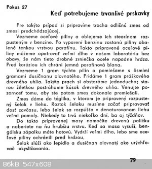

Zivko Kostic - Between Play and Chemistry, experiment 27
durable sparklers using Pb(NO3)2
take 1 g iron filings, protect them by coating using stearin (paraffin candle wax) dissolved in petrol (I would use low boiling point like medicinal petrolether) and let the petrol to evaporate
add 8 g Pb(NO3)2 and 1 g powdered charcoal and mix well
add the mixture into a vessel with shellac dissolved in ethanol (prepare the solution in an advance as the dissolution may last few weeks)
cover a wooden stick with thicker layer of the mass and let to dry
sparklers are very durable thanks to protecting the iron filings against oxidation/rusting by a protective layer (also consider electrochemical series of metals where Fe would reduce Pb2+ if moisture present)
I wanted to make these sparklers but toxicity discouraged me. I still have that Pb(NO3) which I made from captured Pb airgun pellets dissolved in HNO3 in my childhood.
sparklers_Pb(NO3)2.png - 86kB
