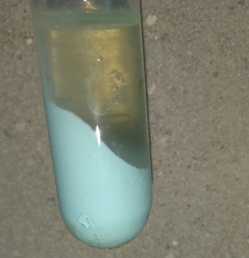

[*] posted on 31-5-2025 at 02:53
Quote: Originally posted by MrDoctor
Does it benefit from a few heat/recrystalization cycles like manganese oxalate does? In nurdrages method, i may be mis-remembering, but at one stage an extremely difficult to filter solid is obtained, it instantly clogs any filter, but boiling it then cooling causes small particles to dissolve and prefferentially crystalize on the remaining ones (still goes from sludge to sludge) but it has an effect on consistency akin to melting and refreezing ice cream, where the crystal structure becomes coarse and consequently the mass becomes porous. every so-often ill try this on difficult to filter precipitates and it will work.
As far as I could see, the size doesn't increase much. You can improve the process if you transfer the sludge to a tall flask. Suspend it at an angle (from 5° up to 20° with the vertical) and the oxalate will settle down more quickly. Then it only remains to decant the liquid before it gets discolored. Copper oxalate is soluble in acids. If you used excess oxalate, the discoloration happens in a relatively short time; if you used a small excess of copper sulfate, you have at least a couple of days.
cop_ox.jpg - 150kB
This is the result of my mixing hot saturated solutions of oxalic acid and copper sulfate and forgetting the tube for a few days. Notice the color of the supernatant.
Aluminum sulfate seems to work better. The quantities that I tested were less than 1 gram and I didn't get around to purify more aluminum sulfate for a larger scale, though. Aluminum sulfate is cheaper than copper sulfate and quite easy to purify.

On a website I found in bold big letters that Its technical grade, good, then I look down to description and find this: "Substancje aktywne w nim zawarte sprawiają, że jest on wysoce skutecznym środkiem do udrażniania rur.". Which basically translate into (for the english fellows) "Substances included in this product make it very effective for unclogging pipes". What substances is the question. The reason why I didn't buy a drain cleaner before is because there is always something else in it and Its usually not written down anywhere.
Put more trust into the people here! :D
And btw it is crystal clear!
h2so4.jpg - 301kB
[Edited on 19-6-2025 by Nikotin]
I think I actually should :)
How this was even approved? Every video I've seen about using drain cleaners always contained a part where they get rid of pigments and other impurities. There's no way they literally just sell pure sulfuric acid under the brand of a drain cleaner, but I mean, I guess Its time to buy finally something, perhaps I will still try the other methods so this thread wasn't created for nothing.
