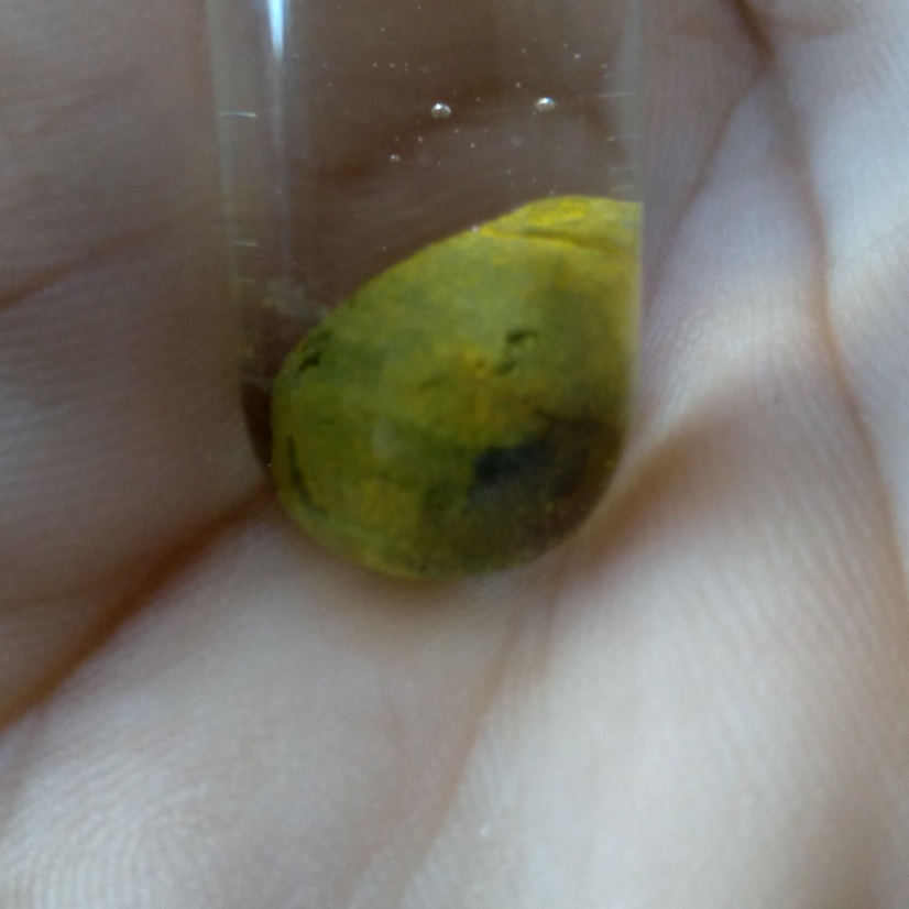

You don't need to dissolve the pellets to test for lead. Dissolve a few crystals of sodium or potassium iodide in a drop of water and add some acid (I used oxalic acid, you can use sulfuric or hydrochloric acid). Put the solution in contact with the pellet. If it contains lead, it gets a nice yellow coat of lead iodide. The advantage here is that, despite the low solubility of lead oxalate (or sulfate or chloride, in your case), there will be more than enough lead ions in solution for the test but not enough to pose a risk greater than handling the pellets with your bare hands.
lead_iodide_test.jpg - 112kB
Quod scripsi, scripsi.
