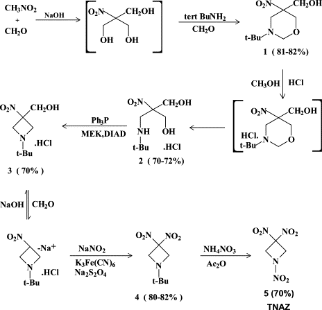

I will be using the Coburn 5 step method for this synthesis. The reaction pathway is shown below.

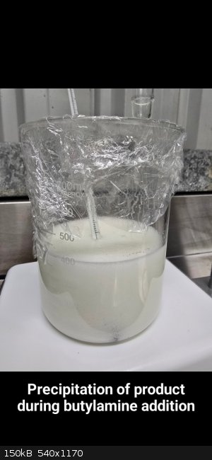

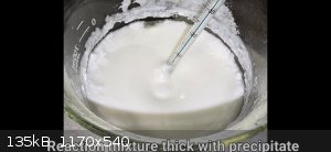

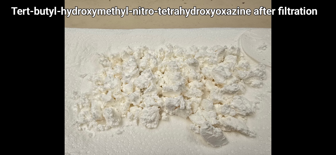

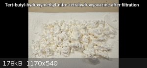

Step 1: 3-Tert-butyl-5-hydrpxymethyl-5-nitrotetrahydro-1,3-oxazine
Thankyou Radium's lab, i feel some luck will be needed.
The first reaction is a Mannich condensation between formaldehyde and nitromethane catalysed by sodium hydroxide. A second condensation is performed directly after in situ with butylamine to close the ring
Without further ado, here is step one.
Paraformaldehyde (81.06 g) was weighed out and dissolved in 300 ml of distilled water on a hotplate stirrer. A 40% solution of sodium hydroxide was prepared and cooled before 40 drops were pipetted into the above reaction mixture to act as a catalyst.
The reaction mixture was brought up to 40 degrees Celcius resulting in a clear colourless solution whereafter the dropwise addition of 32.40ml (36.62 g) was initiated from an overhead 100 ml dropping funnel. This step took over an hour as temperature control was challenging due to the exothermic nature of the reaction. At one point, the beaker had to be placed into a water bath as temperature climbed to 43 degree Celcius. After addition of the nitromethane, the solution became slightly cloudy and straw yellow in colour.
Temperature was now adjusted to 60 degrees Celcius and dropwise addition of 63.6 ml (44.30 g) tert-butylamine was begun. Only a small portion of the butylamine had been added before white precipitate began appearing rapidly in the reaction mixture. A short time later, the solution was so thick with the intermediate product that stirring was becoming increasingly difficult. Upon complete addition the stir bar was only just able to keep up and the top surface was barely being agitated around the edges of the beaker. Stirring and temperature was continued for one hour with some additional distilled water added to thin everything out to maintain stirring.
The reaction mixture was left to stir overnight and sure enough, the next morning, the stir bar was stuck.
The fine white precipitate was then vacuum filtered, rinsed with some cold water and placed on paper towel then into a vacuum desiccator with a vacuum pulled for complete drying. The wet product is extremely easy to handle and does not stick to the funnel or glass rods once the majority of the water is pulled through on the pump.
So far so good, the chemistry gods are happy with thy bidding and the first step is indeed high yielding:)
[Edited on 21-11-2025 by greenlight]

greenlight
Posts: 796
Registered: 3-11-2014
[*] posted on 26-11-2025 at 07:23
Final dried yield from step one is 111.84 grams. This corresponds to ~80%.
I believe the loss of stirring due to the thickness of the reaction mixture and lack of agitation contributed to yield losses.
If the reaction were to be repeated I would either add additional water to thin the mixture out and stir for a longer period or just use an overhead stirrer instead.

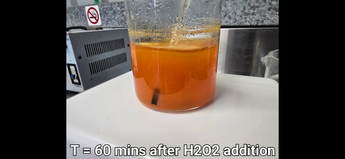

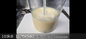

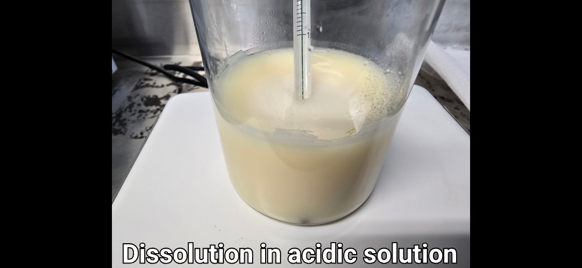

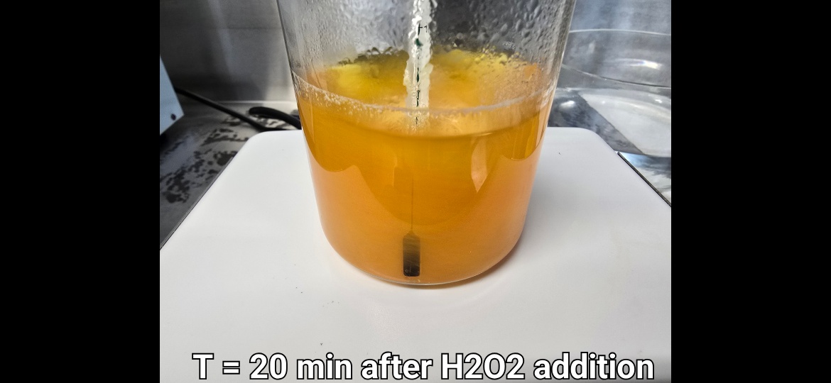

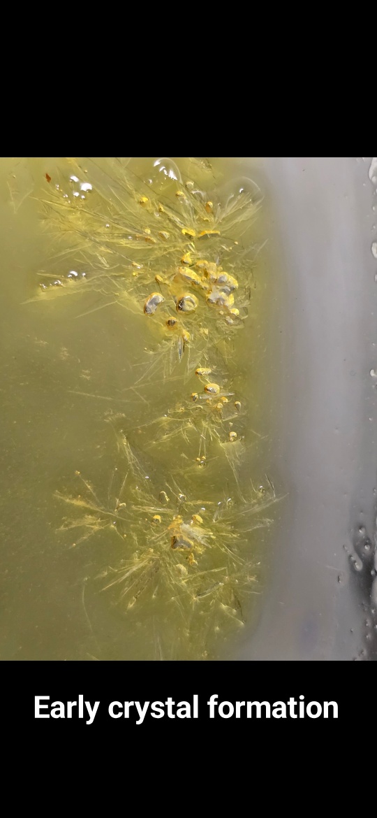

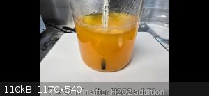

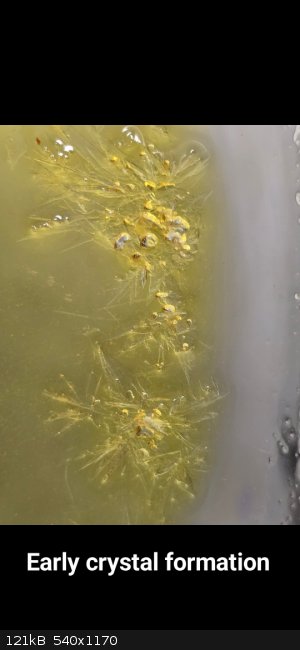

Step 2: 2-Tert-butylaminomethyl-2-nitro-1,3-propanediol hydrochloride
An aqueous acidic solution of 10.40 ml of 32% hydrochloric acid in 62.20 ml of distilled water was made up and placed on a stirrer/hotplate. To this solution was added 35.00 g of the product from step one and gentle heating applied to bring the mixture up to 40 C. Approximately a quarter of the product did not fully dissolve even when left for an hour at this temperature.
Slow addition of 13.68 ml 30% hydrogen peroxide solution was carried out before slowly bringing heat up to 58-60 C. The entirety of the step one product dissolved shortly after heating was increased. The solution began to take on an orange colour that became deeper as time under heat continued. Continuous bubble formation was observed and heating was continued at approximately 69 C for an hour.
The solution was then left to stir overnight at ambient temperature whereupon the next morning the bubbling activity has reduced to a minimal amount. The orange coloured solution was poured into a large evaporating dish and left at ambient temperature for three days to evaporate the water solvent. When approximately 2/3 of the water was removed, crystals began to form into a thin layer on the bottom of the dish.
The final product has yellow discolouration which could be due to the hydrochloric acid being hardware store grade and introducing iron contamination among other things or a need to recrystallise or wash the step one product.
Washing with isopropanol and then acetone has removed a large amount of the impurity leaving pale yellow crystals which are currently drying.
Maybe further washing of this diol is required as the literature states they are supposed to be off-white in colour.
Regardless, I only ran this on a small scale to identify issues so the process must be repeated with the remaining step one product.
I am quite sure the culprit is the hydrochloric acid and I think distillation will be required before using it for the next run.
[Edited on 7-12-2025 by greenlight]

Was the hardware store acid yellow?
greenlight
Posts: 796
[*] posted on 7-12-2025 at 09:50
Light tinge of yellow yes.
Ive just seen a video of someone getting the same orange colour with addition of hydrogen peroxide to hardware store acid so I am 99% sure that it is the issue.
