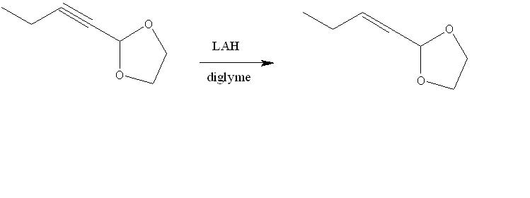

I were reduction of 2-(hex-1-yn-1-yl)-1,3-dioxolane by LiAlH4 in diglyme solution. After the reaction was finished, I had 2 ways to wash product:
1/ It washed by HCl 10% solution. After it was extracted with diethyl ether.
2/It was for x g of LAH x g of water, then 3x g of 15% KOH, then x g of water. But I didn't gain white solid. .....
Please give me some advices for this way!
It was moving protected group by HCl 15% for 1h, after it was extraxted by diethyl ether.
thanks

Post your entire experimental procedure, with all the juicy details in comprehensible English. You can translate Vietnamese to English online: http://translate.google.com/#vi|en|
Keep in mind that dilute acid will hydrolyse your protecting group.
The quench-formula you used is not the formula I suggested - no surprise you didn't get the white solid. If you have difficulty following this formula
then try Na2SO4*10 H2O method I suggested earlier or get another job

I were looking for a procedure :"The reaction was quenched by
addition of aqueous sodium hydroxide 0.1 mol/L (2 mL) at
0 °C followed by addition of ether (10 mL). The aqueous
layer was extracted twice with ether and the organic phase
was dried over anhydrous sodium sulphate. The product
was concentrated in vacuo and utilized in the next step
without further purification."
After this was hydrolysis protecting group procedure:
look below the picture
Some people were intruduce me that I could be hydrolysis protecting group procedure by CH3COOH 50%, reflux for 2 h.
can you give me some advice, please....
[Edited on 16-5-2011 by napoleon9]

For acid sensitive groups I usually work up LAH reductions with NH4Cl. Adding sulfate salts (MgSO4, Na2SO4) can also aid with precipitation of the
gel.
But it seems that you are going to remove the protecting group in the next step anyway, so why don't you just use acidic workup?

I will remove the protecting group in the next step. If you are me, how do you do ?
"I usually work up LAH reductions with NH4Cl. Adding sulfate salts (MgSO4, Na2SO4) can also aid with precipitation of the gel"
Can you give me this procedure ? Because I used workup LAH reductions with NH4Cl but It is gel. If you will filter it and wash it with ether, Could
you do lost product ?
Hic, I am worry. Please give me some advice ? thanks everyone
vulture
Forum Gatekeeper
Posts: 3330
Registered: 25-5-2002
Location: France
| Quote: |
I will remove the protecting group in the next step. If you are me, how do you do ? |
Well then just do acidic workup with HCl, you'll get no gel and you're protecting group will be gone too, skipping the next step.
