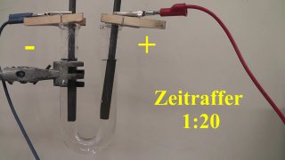

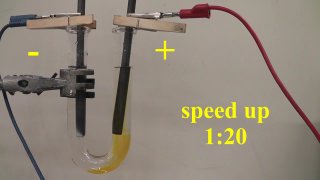

zinc bromide is dissolved in destilled water.[1] The resulting solution is filled into a U-tube to two thirds height.[2] Carbon electrodes are placed into the sides of the U-tube. The electrodes are connected to the power supply.
znbr1.jpg - 7kB znbr2.jpg - 9kB
Bromine is produced at the anode, indicated by a spreading yellow color. Greyish zinc is deposited at the catode.

The dilute yellow bromine solution you see is probably about as dangerous as a bleach solution. Pure elemental bromine is not produced.

You are right, this experiment is not very dangerous. Nevertheless elemental bromine is produced indeed.
