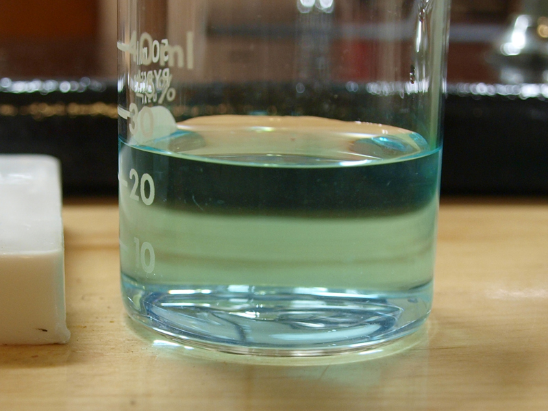

Anyways I went through this whole scheme but something went wrong on the final step. My copper hydroxide was filtered, washed, and dried so that I could weigh it before adding the sulfuric acid. However, I seem to have trouble keeping Cu(OH)2 stable when drying and it had at least partially decomposed to make the dry product a dark green instead of the turquoise blue it should be. I suspect it reacted with air into black CuO (which I've seen happen before) and green CuCO3.
I wasn't too worried about this because sulfuric acid should react with any of these compounds to still produce copper sulfate, so I went ahead and added the acid.
Here's what should have happened: Everything reacts and I am left with a blue solution of copper sulfate with no precipitate left over.
Here's what did happen: The solution is now green (similar to my CuCl2 soln) with a light blue precipitate remaining insoluble in the acid.
Any ideas to what might have been in my air-dried Cu(OH)2 that caused this? I thought that anything in there should have reacted away to CuSO4 in the final step, but clearly something else is happening. I can post a picture of it when I get home tonight if that is useful.

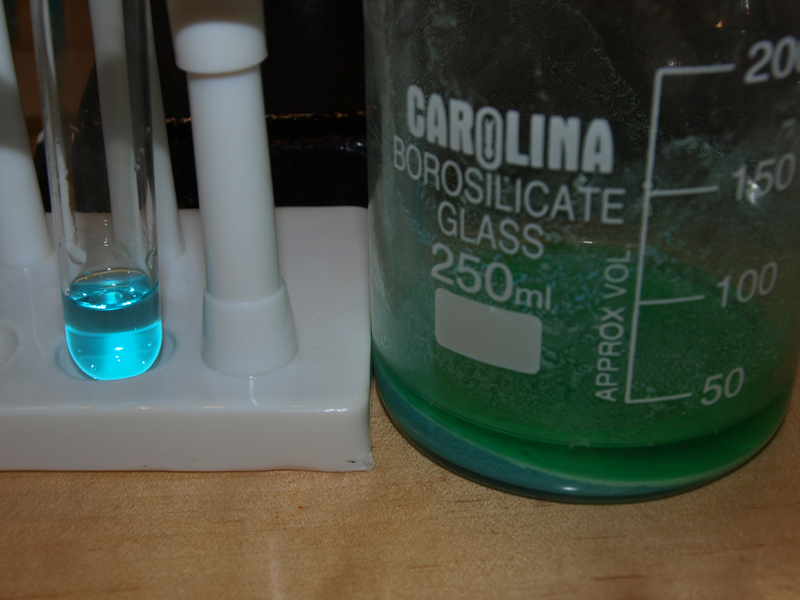

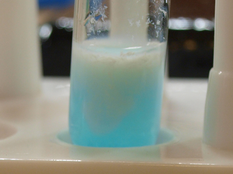

I performed a test on my unknown compounds, and here are the results (with pretty pictures!)
Copper Compounds.jpg - 327kB
The beaker on the right is my concoction of unknown copper compounds. You can see the emerald green solution, with blue precipitate. There also appears to be a thin layer of a whitish precipitate settled above the blue. It's been a few days, and everything remains insoluble. The solution is still very much acidic with excess H2SO4.
The test tube on the left is the result of taking about 1mL of the green liquid and diluting it with a few mL of distilled water. Notice the color change to blue - this is a strong indication that it is indeed copper chloride.

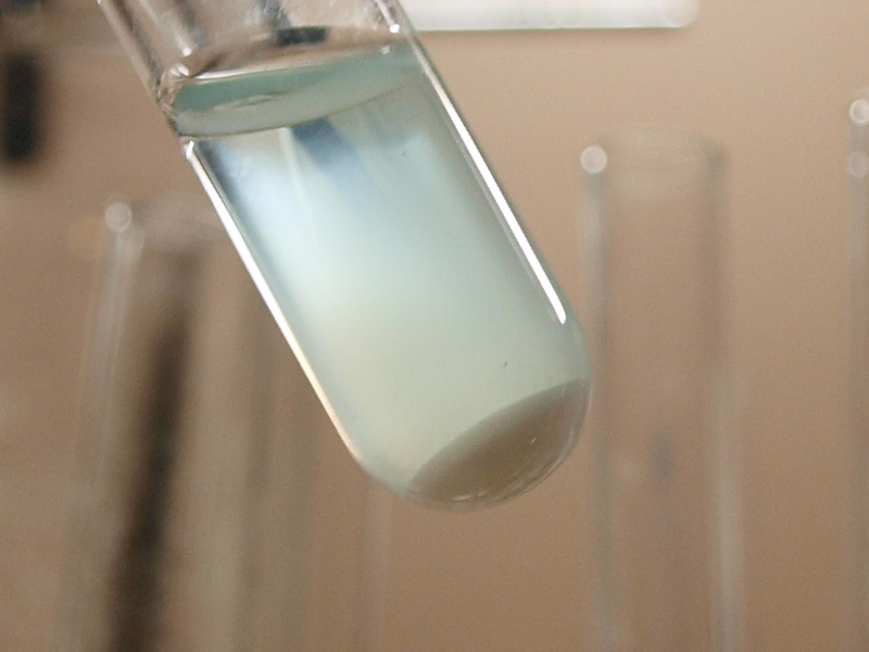

For further confirmation, I dissolved a very small amount of silver nitrate in 2mL distilled water, and added that to the test tube. Immediately a white precipitate of silver chloride was observed, confirming the presence of the chloride ion. The solution is now a lighter blue, suggesting copper nitrate (as it should be).
Adding AgNO3.jpg - 289kB AgCl precipitate.jpg - 274kB
Conclusion: the green solution is definitely copper(II) chloride. The question remains though, how did this happen? Did the sulfuric acid react with stray chloride ions from previous steps to somehow form HCl? That seems unlikely to me. There shouldn't have been much of that around.
And the second question remains: What is(are) the precipitate(s)?

I performed some tests on the precipitate, with interesting results!

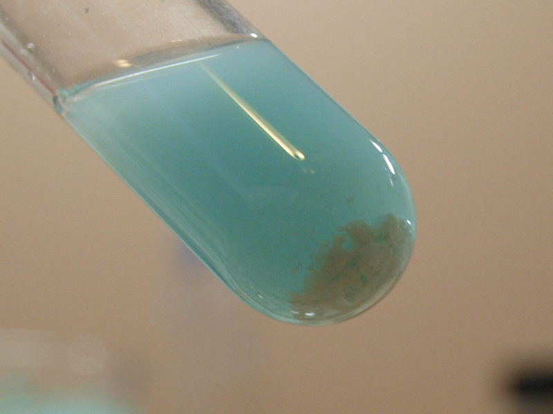

I scooped some of the blue solid out of the bottom, placed it in a filter paper, and rinsed it with water to remove any of the green solution. Surprisingly, all the solids dissolved!
Dissolved precip.jpg - 334kB
My blue crystals going easily into solution like this lead me to believe that this must be the copper sulfate I was looking for. So I transferred some into two test tubes for testing.

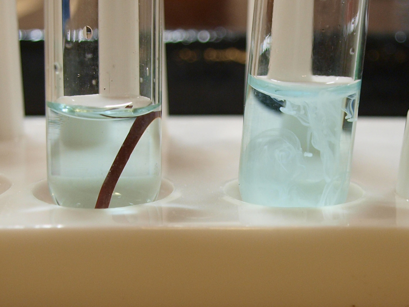

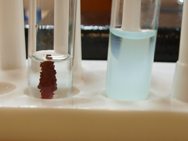

To the left tube I added a small piece of iron wire. If this is indeed copper sulfate, copper metal will plate out on the iron as it displaces copper in solution.
To the right test tube, I will perform an anion test, similar to what I did with silver nitrate above. This time I am looking for the sulfate ion, so I made up a solution of barium chloride. If sulfate is present, a white precipitate of barium sulfate will form. Here's the two tests taking place:
Precip test.jpg - 309kB
You can see the wire is visibly reddish, and a white precipitate immediately forms when BaCl2 is added to the right tube. Here's what everything looked like after a few minutes reacting:
Precip test results.jpg - 294kB Barium Sulfate.jpg - 269kB
On the left, lots of copper plated out and the blue color of the solution cleared. On the right, white barium sulfate is observed.
Conclusion: The precipitate is indeed copper sulfate.
So, I ended up with a concentrated solution of copper(II) chloride with a precipitate of copper(II) sulfate. Apparently, the sulfate is not soluble in a solution of the chloride. I'm still not really sure why this happened though. Adding sodium hydroxide in step 3 should have neutralized any remaining hydrochloric acid and yielded NaCl, and washing the precipitate in step 4 should have carried away most or all of this salt. I would not expect that there would be enough chloride left over to form such a concentrated solution of copper chloride.
That was pretty long-winded, but I enjoyed doing it. Anyone have any theories as to why this all happened?

Did you produce http://en.wikipedia.org/wiki/Dicopper_chloride_trihydroxide instead of copper carbonate or copper hydroxide like you thought? This would explain the results. The result after dissolving this in H2SO4 would be a mixture of CuCl2 and CuSO4. The common ion effect may precipitate the CuSO4 in a concentrated H2SO4 and CuCl2 solution because CuCl2 is more soluble than CuSO4.
Too little sodium hydroxide may be your problem, rather than too much like the Wizard suggested above. Too much may make cuprates, though.

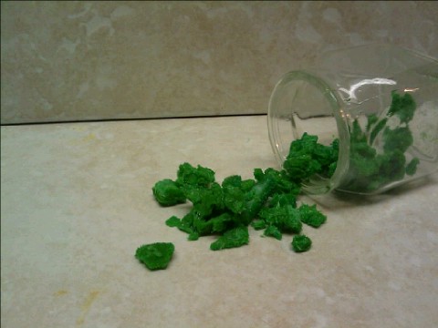

Hi all, long time lurker first time posting, blah, blah. I gotta say i luv these Cu complex's. Any one new to this should def start tinkering with the Cu. Any how on to my question i made a saturatedsol of CuCl2 and evap'd down to get some damp evergreen colored crystals, after a lot of time n effort i checked wiki and it says "CuCl2 may be purified by crystallization from hot dilute hydrochloric acid, by cooling in a CaCl2 ice bath" so it appears i took the wrong route.
Does any one hear have exp forming CuCl2 crystalls? What do they mean when they say dilute HCl acid, how dilute?
I've attached an image (hopefully).
Wiki also describes the appearence as blue-green, im assuming mine are evergreen in color because their still moist? I started with CuSO4 then CuCo, to the CuCl2, btw. thx
IMAGE_copper chloride.jpg - 34kB

Looks a lot like my CuCl2. I think the issue that is being addressed by crystallization from dilute HCl is possible contamination with oxychlorides. Like many other transition metal chlorides, CuCl2 will give off some HCl if you try to just heat to dryness from aqueous solution, i.e. you get a small amount of Cu(OH)Cl mixed in with your CuCl2. I really think that in the case of CuCl2 this contamination is pretty minor, though; unlike ZnCl2 and some other strong Lewis acids, it can't attack water that easily.
