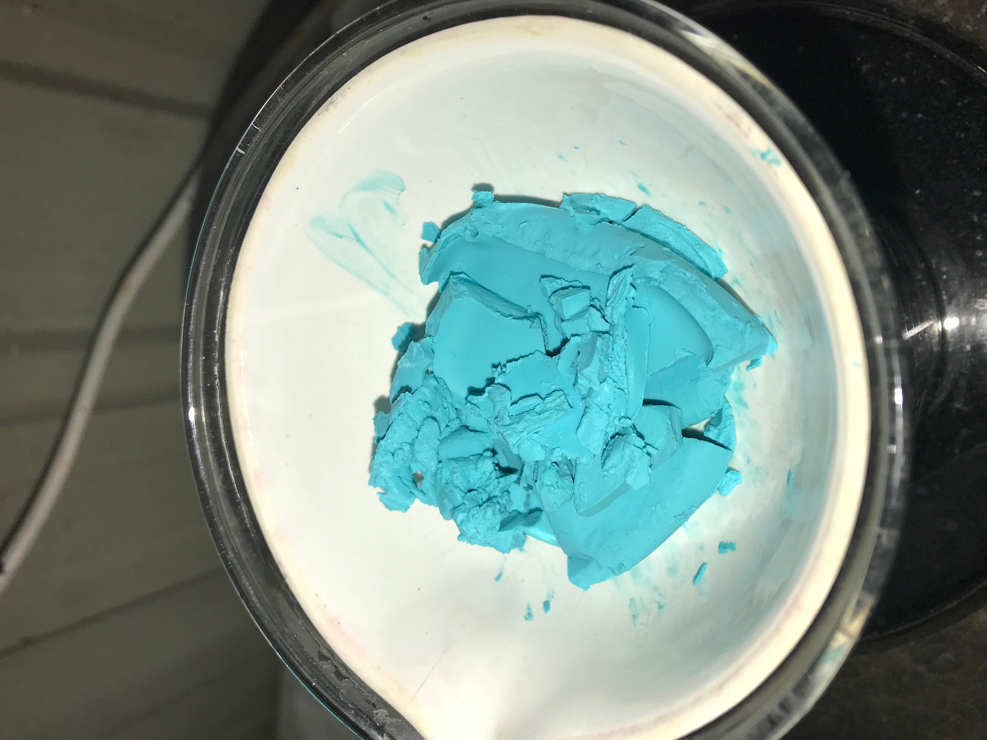

I also had a go at copper borate; specifically hoping for copper metaborate Cu(BO2)2.
First attempt:
- 15g sodium metaborate NaBO2 dissolved in 100ml water, heated until dissolved in a clear solution.
- 20g copper sulphate pentahydrate dissolved in 100ml water, heated to dissolve all.
- Slowly add the copper sulphate solution to the sodium metaborate solution (both hot). Initially there was just a slow color change but suddenly there was a lot of gas evolution and the beaker bubbled over. The gas had no smell. This was unexpected, still don't know why it happened.
- Solution turned baby blue.
- Stir for 60 minutes and vacuum filter. Clear filtrate, baby blue remainder. Photo below. Rinse once in funnel with hot water.
11.jpg - 519kB
- Dry on steam bath until weight stable. Color became slightly darker. Photo below Final recovery 10g.
12.jpg - 448kB
The product dissolved quite easily in concentrated HCl giving as yellow-ish solution, with tiny bit of unreacted material. I also heated some product in a test tube on a bunsen burner for 10 minutes; it turns more green. Photo below. The green color remains when the crystals are wetted.
13.jpg - 436kB
I tried to do a flame test; there is a hint of green - much less green than when I do a test with boric acid.
As mentioned a few times in this thread, what I got was probablky a mix of a copper borate and copper hydroxide?? I had another go while trying to reduce the boric solution prior to adding the copper sulphate.
Second attampt:
- 20g copper sulphate pentahydrate in 120ml water, room temperature. Stir till all dissolved. I purposely used the same amount of CuSO4.5H2O.
- 15g sodium metaborate in 120ml water, stir to dissolve at room temperature. pH very high, 11 or more.
- Add boric acid H3BO3 to the NaBO2 solution and keep checking pH, stop after 5g added because some boric acid did not dissolve. pH around 9 as far as I can tell from the strips.
- Mix slowly - very slowly - with both solutions at room temperature.
- Some gas evolution, for a few seconds, but much less than with the first attempt.
- Baby blue solution, similar color as first attempt.
- Stir (no heating) for 24 hour. Color remains the same, see photo below. No more unreacted boric acid to be seen.
21.jpg - 679kB
- Vacuum filter. Wash once in funnel with large volume of room temp water.
- Dry on steam bath until weight stable. See before and after photos below; dried product is much darker blue than the first attempt. Final recovery 12g.
22.jpg - 454kB
23.jpg - 439kB
Attempt at a flame test shows very little green.
When heated on the bunsen burner, this product also turns green, photo below.
24.jpg - 348kB
After this, I wanted to make copper hydroxide and dry it using the same steam bath to see how the final product compares to the above two. This went as follows:
- A solution containing 20g copper sulphate pentahydrate was added to a solution of 8g sodium hydroxide when both solutions were warm - a blue suspension formed but turned black within seconds. Looked like the copper hydroxide decomposed to copper oxide, and this was discarded.
After more reading up, the reaction was tried again but with much more dilute solutions:
- 20g CuSO4 dissolved in 400ml water
- 8g NaOH dissolved in 100ml water.
- Mix the room temperature solutions slowly, initially a light blue suspension which became a lovely dark blue. See photo. Solution was quite thick and hard for the stir bar to get moving.
31.jpg - 402kB
- Vacuum filter and rinse once in funnel. Clear filtrate, dark blue remainder. See photo. The remainder retained a lot more water than the "borates" and took much longer to dry.
32.jpg - 679kB
- As it dried the color changed became darker and eventually alomost black, see photo. I suspect this became a mix of hydroxide and oxide.
33.jpg - 554kB
- Final recovery 9g.
- The product dissolves readily in contentrated HCl, but a bit slower than the "borates".
Thus the 'borates' are different from the hydroxide; they are much more stable in terms of keeping their color at the steam bath temperature, and seem to retain less water i.e. they dry easier. But what I really got I dont know.
I'm tempted to have a go at stirring copper powder with boric acid and see what happens, but these kind of reactions ties up my (only) stirring hotplate for days. So it will have to wait as something else is currently on the plate.
Photo for comparison:
34.jpg - 565kB

I think that blue precipitate is some polyborate (like di-, tri-, tetraborate etc.) and the green stuff if actually metaborate. You can see some other black material in your green solid - this is probably CuO.

Gents thanks for the replies. I was aware of that report of copper borate melting 'easily' but when I heated my 2 products in a strong bunsen burner flame they only turned green.
Clear info on what happens to copper borates when heated seems not that easy to find online. The attached document describes synthesis of copper borates and has a section on their thermal decomposition:
"The temperature of the thermal decomposition process of copper hydroxyl nitrate was reported to be 246 °C [9]
which was very close to those of the precipitates obtained in the present study. The mass loss onset temperatures of the all samples were between 237.7 and 248.7 °C as shown in Table S1. The remaining mass after thermal decomposition would be 66% considering the stoichiometry of the reaction in Eq. 2. The remained mass from the samples at 600 °C were in the range of 63.4% and 70.9% as indicated in Table S1."
It does not mention melting, rather decomposition as far as I can make out.

Attempt at prep. of copper borate
Forgive me for not posting exact weighed measurements, but I added about 2 tablespoons of copper sulphate "feed grade" crystals in about 250 ml of distilled H2O in one flask, and then ~ 2 tablespoons of laundry borax in ~250 ml of distilled H2O in another flask, warmed both both flasks for ~1 minute in microwave, stirred well. Then dumped the contents of the copper sulphate flask into the borax flask, stirred by hand another minute or two.
Next, poured it all into a teflon beaker and placed on a magnetic stirrer hot plate stirring vigorously, ran the temp. up to 62C, kept it for 2 hours. Used a simple coffee filter to filter out the precipitate, washed the cuprous borate out several times with distilled H2O over an hour, it drained very, very slowly - - a vaccum filtration would have been better. Finally, placed the turquoise filter cake on a teflon mat in the oven drying it at ~93C for 2 hours. Disposed of the Na2So4 filtrate.
If there was any CuOH2 in the final product it would have been revealed by the rather classic lab procedure of heating a small portion of my final product in distilled H2O at ~97C, just below boiling for an hour which converts any CuOH2 present to black CuO, with a few boiling stones for good measure. I did that.
Result: No black color was observed at all.
