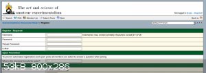

[*] posted on 20-7-2018 at 03:06
I've just reported another round of spam. Thanks to whoever it is that has already cleaned up most/all of it.
There are plenty of good ideas here for how it might be prevented in the future. What we really need to do is pick one and get it implemented.
The chemistry related question as a CAPTCHA seems the most straightforward. Using the virtual machine Polverone creates as a backup I've started making the changes. I've updated the form and now need to add choosing the question and then evaluating the response.
I'll seed it with some simple questions but the administrators should be able to add new or delete them from the database.
Screenshot from 2018-07-20 06-51-12.png - 53kB

This is a really good suggestion. I doubt the questions will need to be difficult to be effective and this style gives lots of variety.
I got the question selection part implemented this morning before going to work so just have the evaluation step to go. With a bit of luck I might be able to get this finished today.

[*] posted on 20-7-2018 at 17:00
Sorry Melgar. I think I went back to page 15 but I find these really long threads a bit intimidating. I'm sure I missed a lot.
I can understand your experience. I first learned programming with PHP but it has probably been a decade since I last used it. I moved on to python where the prime directive is to write readable code. Getting to grips with this codebase was quite the culture shock. The approach seems to have been to take code that would be understandable spread across 50 files and squeeze it all into 2 files.
However, I think I have a working implementation. I'm writing up instructions now.
streety
Posts: 110
Registered: 14-5-2018
[*] posted on 20-7-2018 at 17:13
I believe I now have a simple captcha question implemented.
The steps needed to add this to the forum are:
1) Merge in the pull request on github: https://github.com/mattbernst/xmbforum/pull/1
2) Copy member.php and templates.xmb to the forum (these are the only files changed)
3) Restore the templates cache by going to the Administration panel, then templates under 'look & feel', clicking 'Restore all' and then 'yes'
4) Add the questions to the database by going to Administration panel, then 'insert raw sql' under 'database tools' and submitting the sql query in the attached file
Attachment: table_creation.sql (1kB)
This file has been downloaded 608 times
