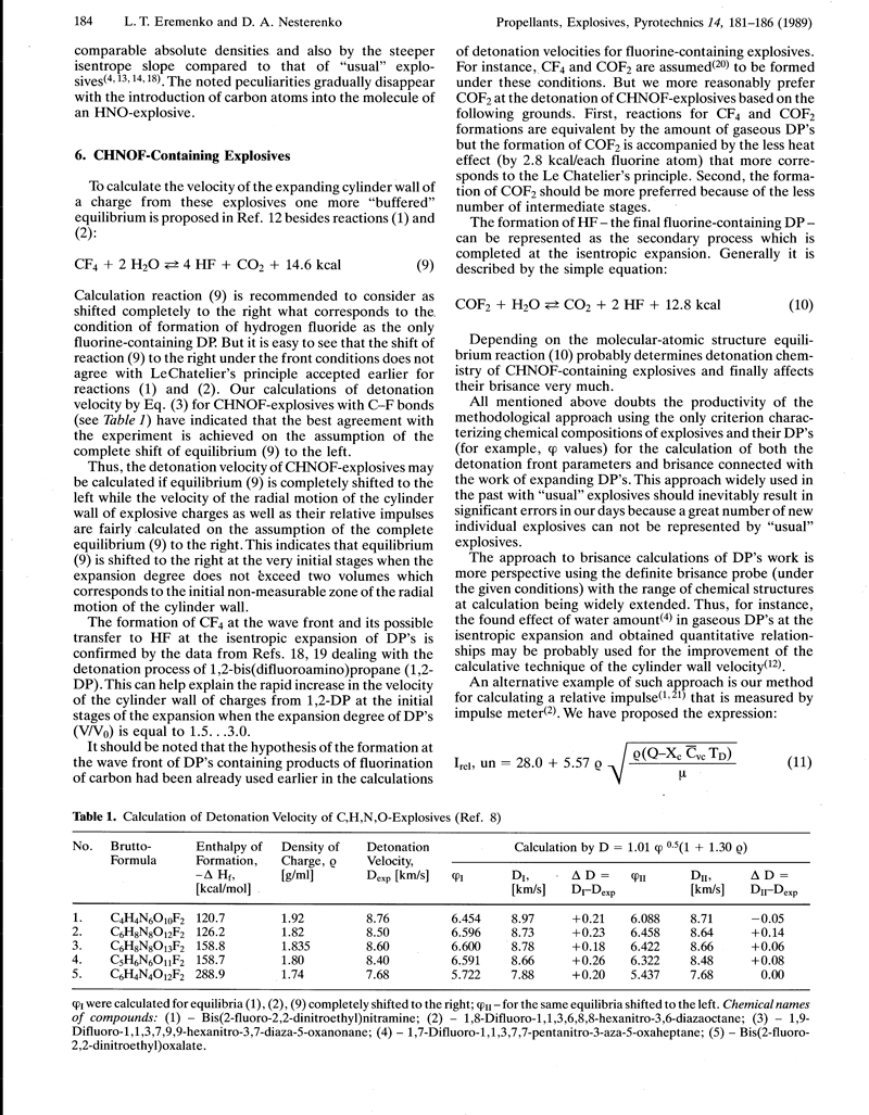

Oxygen-balance-57.jpg - 366kB Oxygen-balance-58.jpg - 298kB Oxygen-balance-59.jpg - 329kB Oxygen-balance-60.jpg - 129kB Oxygen-balance-61.jpg - 203kB Oxygen-balance-62.jpg - 387kB

Thank ye kindly for the reference, Wizard :D. I read all of that. My comments are:
1) It can not be denied that fuel is being wasted when the OB of an explosive is substantially negative. The question is how to exploit this situation without adversely affecting the explosive properties.
ETN (+5.3% OB) can probably be mixed with PETN (-10%) quite well without affecting the VoD of either.
I am not sure if AN (+20%) or NaNO3 (+47%) in a composite with TNT (-74%) to have an OB of zero would actually reduce the VoD or simply produce more energy during afterburning and not detonation.
Therefore I agree with your reference when he says "OB correlates reasonably well with relative power, provided these comparisons are made for similar expls."
BTW is there an error in Table 1 for TNT? It lists the OB there as -21.6% but just to the left the calculation showed it to be -74%
2) Figure 1 shows pretty good correlation between OB and explosive power.
As an engineer I understood the theoretical meaning of explosive power to mean the reaction heats divided by the reaction time. The reaction heat can be calculated while I would estimate the reaction time to be the time taken for the VoD to traverse the sample of explosives, after making corrections for DDT/SDT.
3) I'm not quite sure I agree with you that VoD has limited practical meaning. High VoD leads to faster hollow charge jets/EFPs, more brisance and higher peak pressures. Hollow charges are the bread and butter of modern anti-armour weapons.
