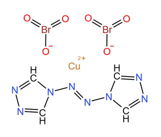

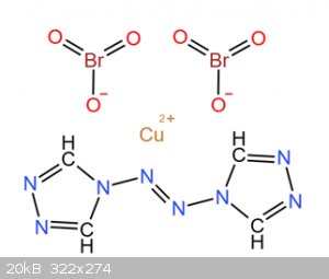

Cu (4,4′-azo-1,2,4-triazole) Bromate (BLG-1)
Cu(C4H4N8)(BrO3)2
https://pubs.rsc.org/en/content/articlelanding/2023/mh/d3mh0...
It's a 2023 paper. The claim is 3mg to initiate RDX and 1mg for CL-20 that is the most efficient I've seen. They are also claiming lower sensitivity than lead azide but we know how these Chinese claims go.

Yet another great find Axt. I looked through the supplementary material, and I think it looks promising. The photos of the lead plate tests with 30-70 mg neat BLG-1 are quite convincing assuming they are not a complete fabrication.
I will have to prepare some bromate, but in the meantime I've tried with perchlorate as the oxidizing counterion:
1 mmol 4,4'-azo-1,2,4-triazole was dissolved in about 7 ml hot distilled water along with a little HClO4. 1 mmol Cu(ClO4)2 was prepared by dissolving 0.5 mmol Cu2CO3(OH)2 in slightly more than 2 mmol diluted HClO4.
Once all the 4,4'-azo-1,2,4-triazole was in solution, the Cu(ClO4)2 soln was added dropwise. This caused immediate precipitation of a blue solid. At time of writing, I'm allowing the mix to come to room temp with stirring.

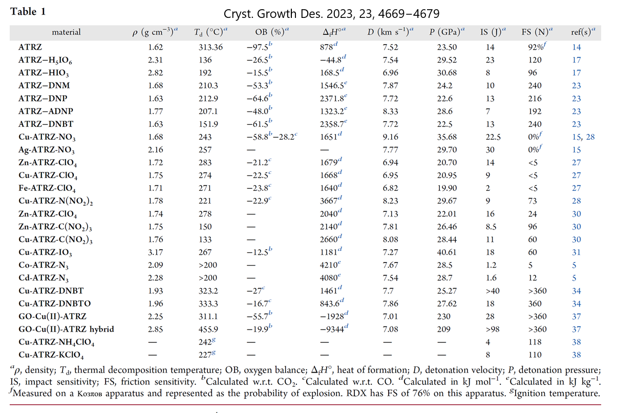

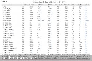

Here's some further info on the nitrate [Cu(ATRZ)3(NO3)2]n. Not entirely sure what to think of this one, its properties are all over the place. The props of the perchlorate are given in table from a review article (too big to attach).
Its calculated properties are also in supporting info here: https://pubs.acs.org/doi/10.1021/acs.chemmater.5b04891?ref=P...
To summarise the nitrate, low sensitivity, extremely high heat of detonation, relatively low density (1.64-1.68) and wildly calculated VOD's 9160 & 6780.

Here's some further info on the nitrate [Cu(ATRZ)3(NO3)2]n..
[Cu(atrz)3(NO3)2]
[Ag(atrz)1.5(NO3 )
If the formula of these complexes is correct, then I see no reason to do this.
They are very weak. The energy of -N=N- recombination is insufficient to create a high-explosive for this molecular mass. And it contains very little oxygen.
[Cu(atrz)3(NO3)2=[Cu(C4H4N8)3(NO3)2=>Cu+6H2O+12C+13N2
"Among them, the heat of detonation of complex 1 is 3.62 kcal/g (6.08 kcal/cm3 ), which is even higher than those of CL-20 (about 1.5 kcal/g)and octanitrocubane (ONC;
about 1.8 kcal/g ), the most powerful organic explosives known."
Taking into account the formula and the equations of detonation, this is a clear fake. How can you believe in it?

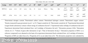

I don't. It's a compilation of the available information to shed light on this particular family of complex salts. The supporting info linked above argues against it by providing a heat of combustion figure lower than the heat of detonation figure in that attachment, you would expect a high heat of combustion for something so oxygen poor so it's of no surprise that it far exceeds RDX. There is still a general trend for these "MOF's" to have very high heats of formation though.
I don't know where the "9160m/s" in the review article is coming from. The only figure in the references provided is that attached here, which seems plausible.
Yes, 6780-6860 m/s 18.56-19.15 GPa and Qdet=4388-4562 KJ/kg at 1.63 g/cc looks more realistic.
