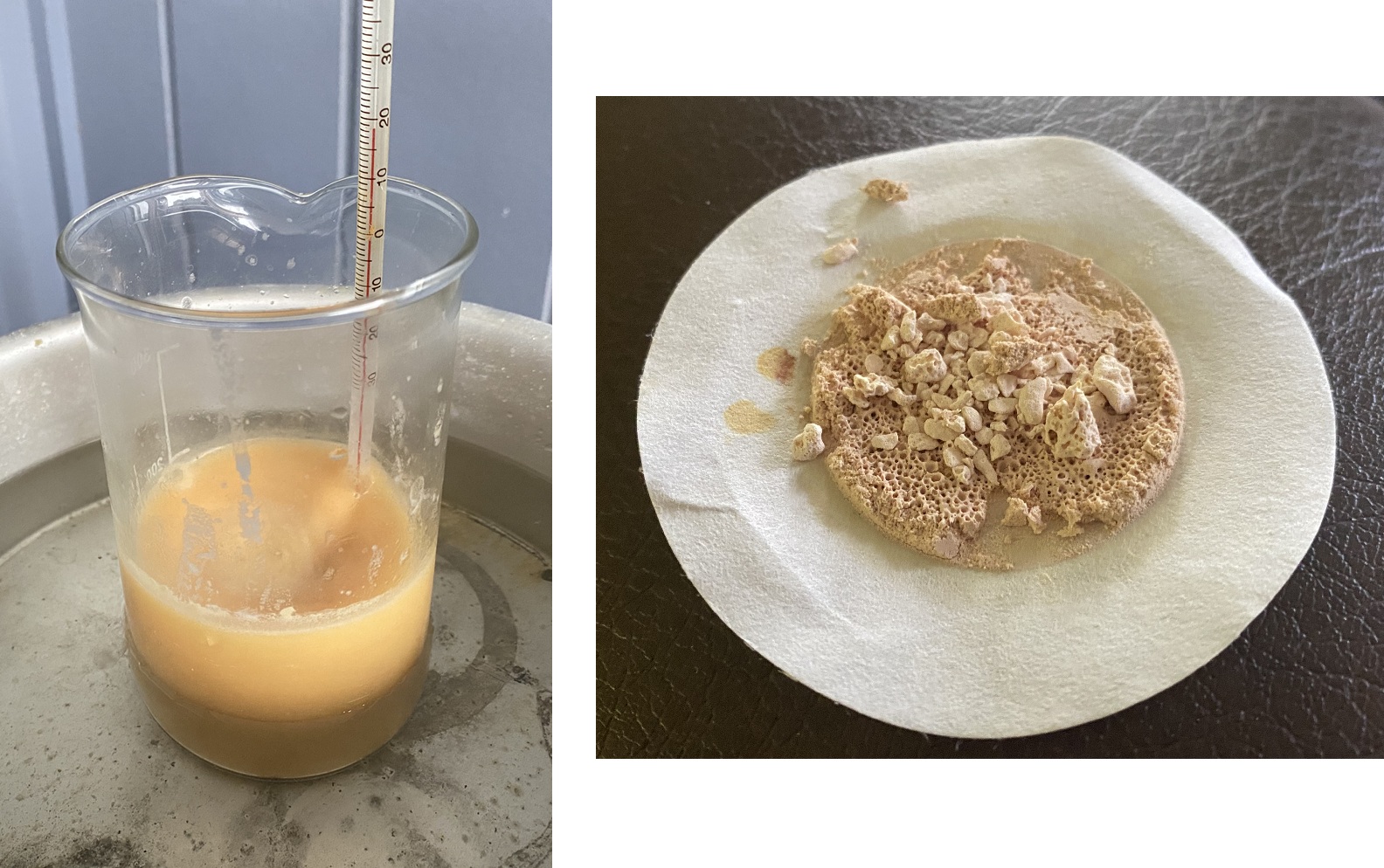

I've been defeated. I tried following the NaOCl route as closely as possible but apart from a small amount of white powdery precipitate in the initial stages of the reaction there was nothing more on standing. The SDIC route has also killed me, I'll describe my process here as detailed as possible
SDIC·2H₂O ---------------- 25.7 g ----- 0.100 mol
Acetic acid (glacial) ------- 9.08 g ----- 0.151 mol
4-Amino-1,2,4-triazole ----8.8 g ------- 0.105 mol
Sodium hydroxide ---------12.0 g ------ 0.300 mol
Water (total) ---------------201.3 g ----- ~11.2 mol
25.7 g of sodium dichloroisocyanurate dihydrate was dissolved into 125 mL of water with stirring and brought down to 5C by placing it in a freezer, at the same time 45.4 g of 20% acetic acid is cooled by the same means. The acetic acid is introduced to the SDIC in one portion at 5C and stirred as it is allowed to come to room temperature over the following hour in which time a fine suspension of cyanuric acid forms turning the solution milky white. In the mean time 8.8 g of 4-amino-1,2,4-triazole was dissolved into 40 mL of water.
Into a 400 mL beaker with stir bar sitting in a cold water bath is injected by way of a 3 mL pipette 1 squirt of the 4-ATZ solution followed by 4 squirts of the SDIC/AcOH solution. The additions in that order are continued at a pace to maintain the temperature at 20C. This takes approximately 30 minutes. The solution is seen to turn orange with slight effervescence and foaming which was easily dissipated by turning the stir speed from 250rpm to 400rpm. After the final addition the solution was allowed to stir for a further 30 minutes then vacuum filtered. The product was stirred into 12 g of sodium hydroxide in 300 mL of water and vacuum re-applied. Only a small amount of brown-buff coloured residue remained.
This light brown residue was energetic, flaring off on ignition leaving little residue. Presumably that the desired product but the yield is abysmal. The only thing i can see to change in a re-attempt is to well cool the reaction solution to 5C then filter then cool the hydroxide to 5C too and re-filter. Frankly I should have thought to do that this time, but do you cold filter Microtek? I just re-read your round abouts solubility figures.

Hmm, I don't cool it much before filtering, just to about room temp. I do cool the hydroxide soln since I have a feeling it does slowly react with the product (though that may not be an issue when the cyanuric acid is there to absorb it). I will say that my yields haven't been up to the claimed 90 % mark either, and just getting to the ~50 % level took some tinkering.
You could maybe try the method where SDIC and acetic acid is combined and stirred for 6 hours before the aminotriazole is introduced. I would still modify that procedure by adding the SDIC/HOAc to the aminotriazole rather than the other way round, which they seem to have done in the paper.

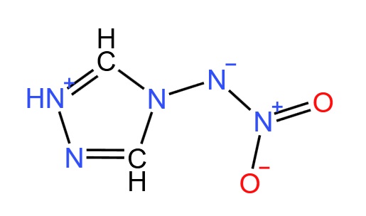

I found a fascinating route to the N-nitroimide, by the reaction of 4-ATZ with sodium ethoxide and a nitrate ester (ethyl nitrate, diethyleneglycol dinitrate and PETN are examples given). Gives a calculated density 1.82 and confirms that its zwitterionic nature can be broken and precipitated as its metal salts. Melts at 172C with explosion.

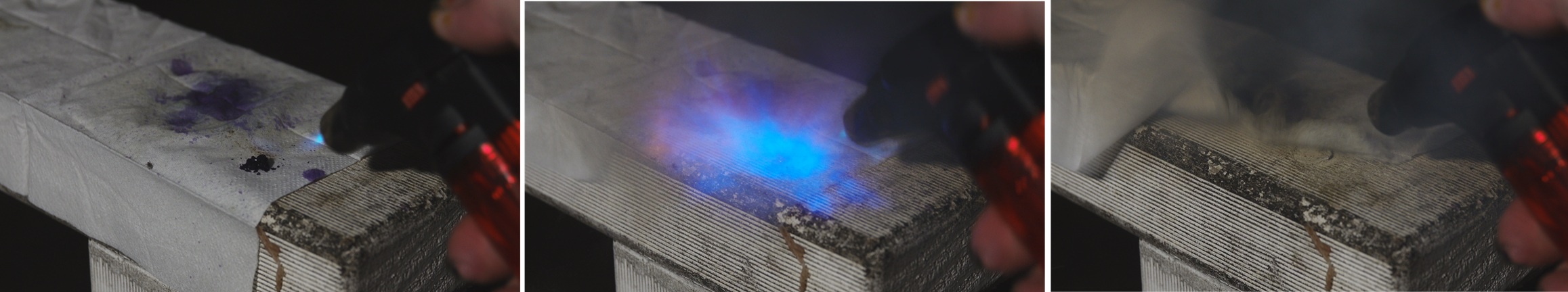

Yes, my crude does look something like that. I recommend a recrystallization from water. It makes beautiful needles that are similar to nitroguanidine, but smaller.
I haven't tried burning as large amounts as demonstrated in the video, but it does flash when ignited.

The nitraminotriazole looks easy, and it would be interesting to explore both metal complexes and nitrogen rich salts. The only problem is time...

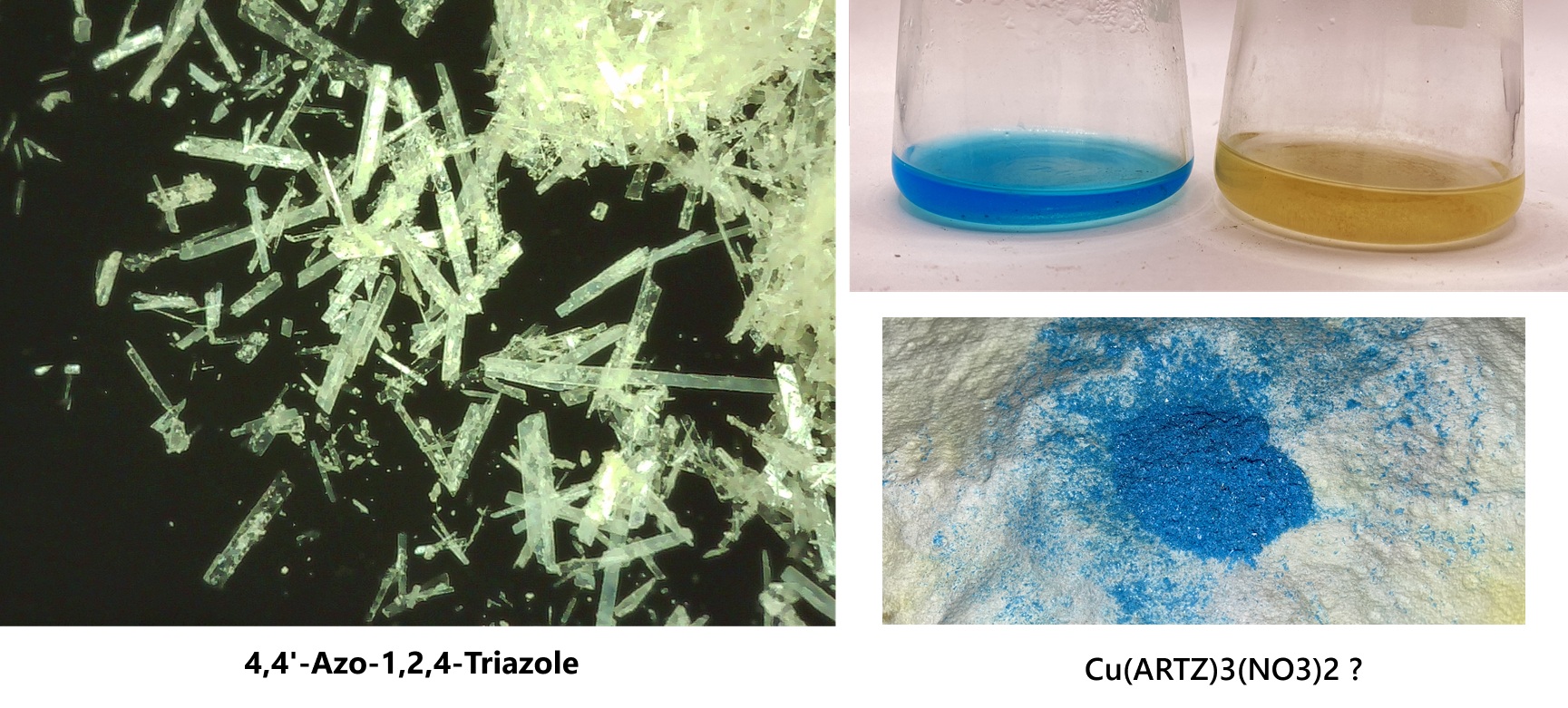

Hmmm. I recrystalised the azotriazole and yes, small matted felt-like needles that peel off the filter paper (attached), fast deflagration with no residue. Attempted BLG-1 but used ATRZ, copper nitrate and sodium bromate, 1:1:2 the process matched your experience blue crystals precipitating not immediately but on standing for an hour, but it is quite timid when ignited. Significantly slower than even the copper aminotriazole perchlorate although faster than nickel aminoguanidine nitrate. It makes me think the nitrate has precipitated preferentially. I don't have much left to test, but it would be good to run it again sans bromate and see if the nitrate product matches this product. It is still quite impact sensitive, but produces a weak snap not an ear splitting crack that you'd expect.

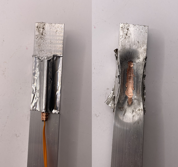

How did you ignite it? When flame ignited from above on a piece of Al-foil it pops, but does not penetrate the foil. When heated from below, it detonates and penetrates the foil. However, even then the detonation is not that impressive; it is not nearly as sharp as typical nitrotetrazolates or azides. Nevertheless, it is impressively efficient as an initiator.

I kept the filtrate, and it deposited a small amount of extra precipitate. Much more vehemic than the first major crop, and yes about the equivalent of NAP. Crystals are attached, what i presume to be the nitrate is quite jagged, whereas the bromate is quite cubic.
The first crop I would characterise as vehemic as blackpowder, when ignited with a smouldering splint even quite large quantities wouldn't do more than puff. Very small quantities of the second crop give that distinctive loud POP. Further evidence is provided by the colour of the flash on ignition, there is no blue tint like you should get from a Cu + Br reaction on the first but there is in the second.

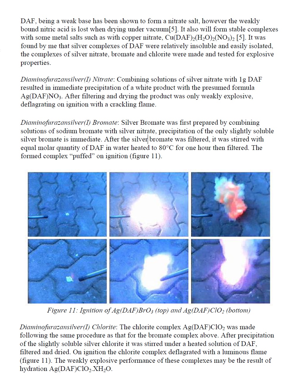

I was just looking at my copy of https://www.sciencemadness.org/member_publications/energetic... and it had an extra section on DAF complexes. I'm not sure why it wasn't in the "published" article, frankly I don't even remember doing it now, but this is it.

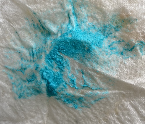

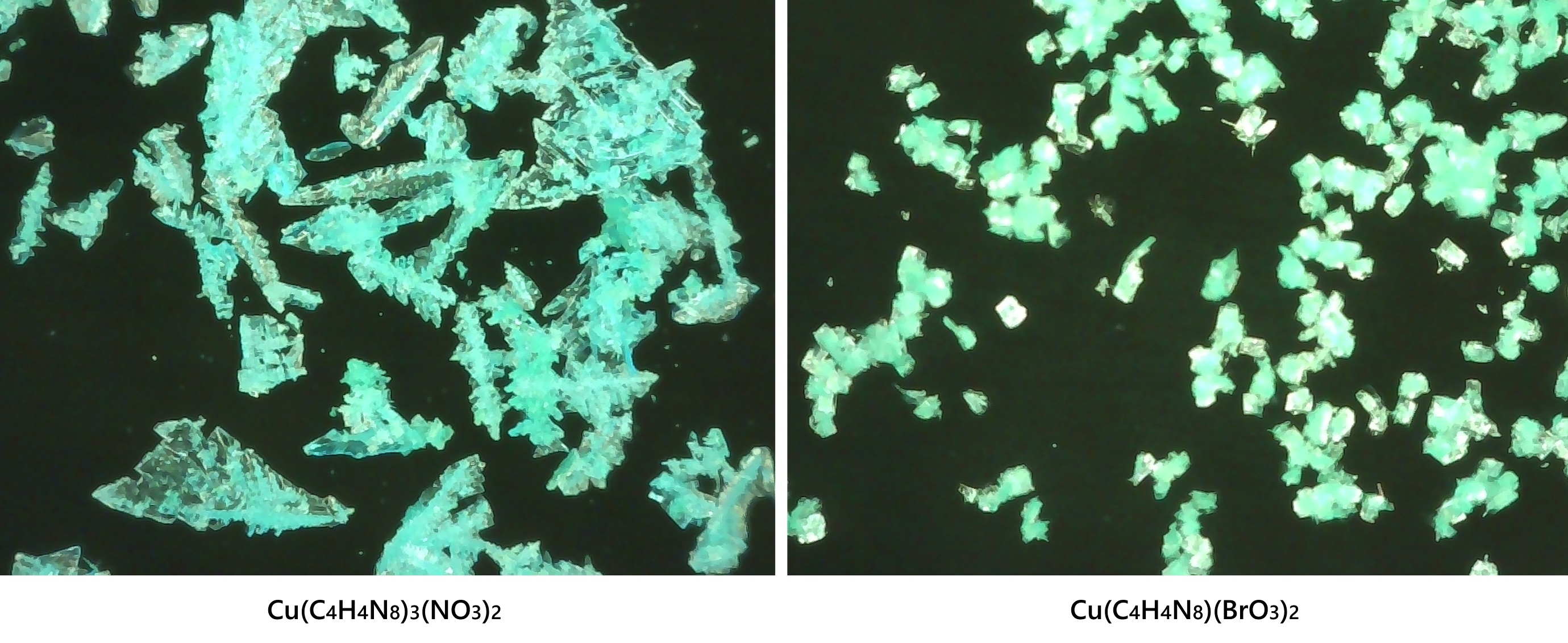

I wanted to try out the copper 4-amino-1,2-4-triazole bromate complex, so I added 4-ATRI to a solution of CuSO4*5H2O in water. It immediately turned a beautiful deep sapphire blue, indicating fast complexation. While I was preparing the bromate solution, large amounts of a pale blue precipitate appeared in the solution, so I conlcuded that the sulfate complex also has a low solubility in water.
I was worried about contamination of the bromate complex by the sulfate, so I tested other copper salts to see if I could find something that would not precipitate with 4-ATRI.
I found that both the chloride and the nitrate also precipitate, but the acetate does not. I prepared the putative bromate complex both from copper sulfate and from acetate to see if there is a difference in performance, and the samples are drying at time of writing.
I also isolated the nitrate complex and dried a small sample at 90 C for a couple of hours. No visible change occurred (except for the drying obviously), and the substance was found to detonate with a sharp report on heating from below Al foil (in sub mg amounts). It didn't penetrate the foil in this test, but if the foil is folded around the sample, it is pulverised on detonation. It only pops when contacted with flame from above.
I haven't tested the initiation ability of this substance (and considering the disappointing performance of the perchlorate comlex, my expectations are not very high), but nitrate complexes that DDT in such small amounts are quite rare so that at least is interesting.
