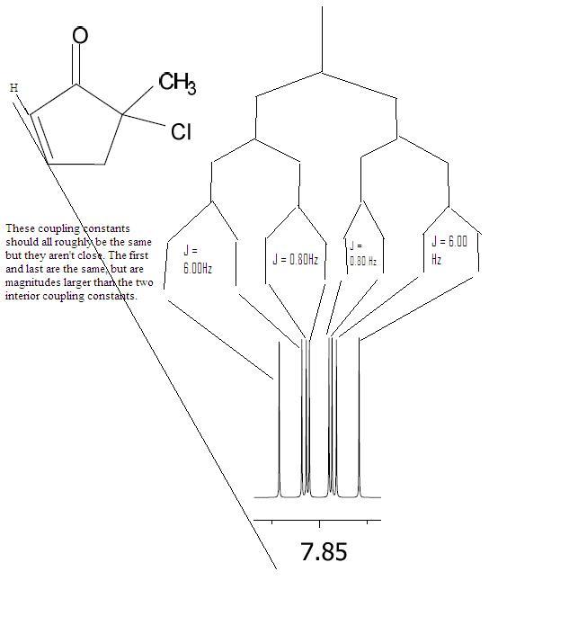

Hi Guys,
For the peak seen at 7.85ppm (shown below) which is pretty "clean", it seems to be a ddd. However, the smallest coupling constants don't add up. The two outside coupling constants are equal, but the two interior coupling constants are different than the outside coupling constants, and by a fairly large amount. Shouldn't the coupling constants in the same level all be equal for a ddd? I have attached a .jpg file to show what I mean.
In final my question is... what is wrong with this NMR Spectrum? If this is indeed a ddd why aren't the coupling constants adding up?!

You seem to miss the fact that in the bottom part of the tree the "branches" can cross. Think about it: what would a "ddd" look like for J=4,5,6 Hz? Pretty much exactly like your diagram, isn't it?
NMR has always been black magic to me, but this seems to make some sense. BTW: Are you sure you are looking at the correct proton? What does the signal of the proton at the other side of the double bond look like?

Thanks. Yes, you are right, I mislabeled my hydrogen. The chemical shift should correspond to the adjacent hydrogen.
So... How would I draw my tree diagram and find the rest of my coupling constants?

Come one... I gave you the answer. :( If you make the tree for J=4,5,6 Hz it will be obvious which peaks form pairs.
BTW: This example is obviously simulated. No way a real NMR spectrum would look like this with the shifts being exact to the 5th significant place.
(Answer for the lazy: 6.0, 7.1, 7.9 Hz)

I did draw a diagram! And I got the answer!!! You sir, are AMAZING! :) Thank you a ton!!! To prove to you I drew the diagram please find it attached below :)
By the way... how was I suppose to know beforehand that there was overlapping between the bottom "branches"? Is this simply a guess I have to do? Also, may I add... how do I know which hydrogen the coupling constants (6.0, 7.1, 7.9 Hz) couple too. Of course it couples with one of the hydrogens I am drawing the "tree" for, but how do I know which other hydrogen as well?
Thanks a TON again, I really understand this now :) Awesome! :)
