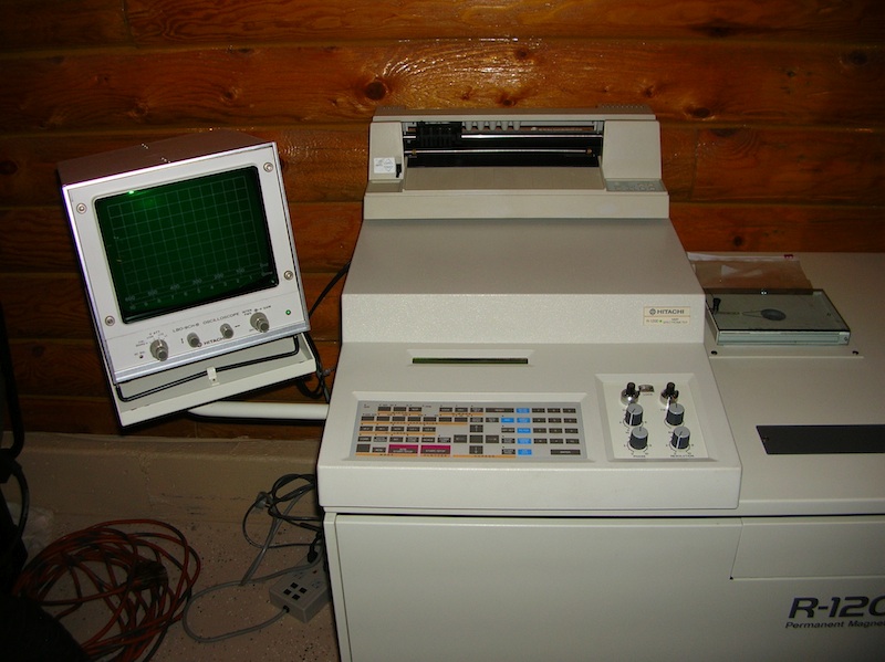

Here are a few pictures of my new NMR spectrometer. The shunt key, and other accessories arrived yesterday. I hope to get the instrument running over Christmas weekend.

[*] posted on 24-5-2012 at 22:56
First Proton NMR Taken in a Garage?
It will be about a week until I can post the spectra since I don't have a scanner:(
I got my Hitachi R1200 NMR spectrometer to
work and I ran several spectra yesterday on some ferrocene derivatives I
have prepared, including 1-ferrocenylethanol and Bis(diphenylphosphino)ferrocene.
It works quite nicely and the spectra are very similar to
those on the Aldrich website for these compounds. I am trying to find the
plotter pens for the plotter, I made an improvised one out of a ball point
pen, but it does not work that well. The spectrometer signal drifts
rapidly due to the fluctuating temperature, but I can get acceptable
spectra running a 30 second scan. The instrument did not require a lot of
adjustment to find the water signal, but I adjusted a bunch of the shims
to increase the signal and resolution. I will have to scan the spectra and upload them when I can get access to a scanner.

That's a gorgeous machine :) congrats!

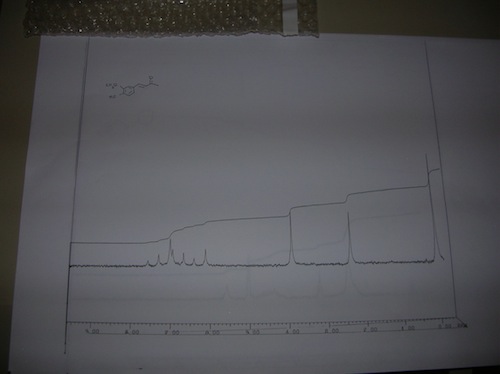

60 mHz 1HNMR spectrum of aldol condensation product of vanillin and acetone. Intermediate in the synthesis of zingerone. This spectrum was obtained with a 30 second scan and correlation on this instrument. Sample was dissolved in deuterated chloroform, tetramethylsilane was added for reference since the residual chloroform peak is not distinguishable. A Perkin Elmer infrared spectrophotometer pen was used in the plotter, this seems to work fairly well.
