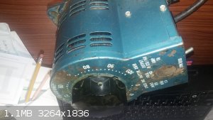

[*] posted on 25-1-2018 at 16:28
Just happens I found this bad boy at University surplus today, for $36. 1kW, tests OK, just needs some cleaning up.
20180125_182646[1].jpg - 1.1MB
