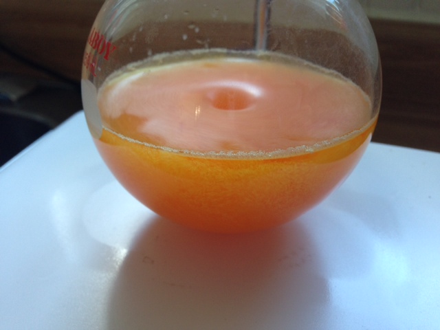

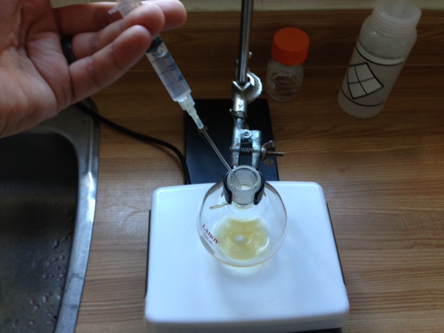

2ml of 48% HBr was added dropwise to the solution, resulting in a gradual progression from yellow to dark orange.
vanil4.JPG - 89kB vanil5.JPG - 70kB vanil6.JPG - 74kB
Next a yellow precipitate materialized, stirring was continued for 45 minutes in an ice bath. This isn't indicated in the original procedure but a significant exothem was noted and as such I decided to cool the reaction.
