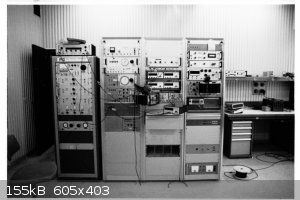

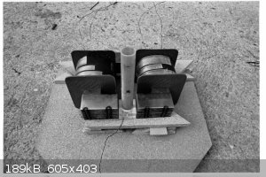

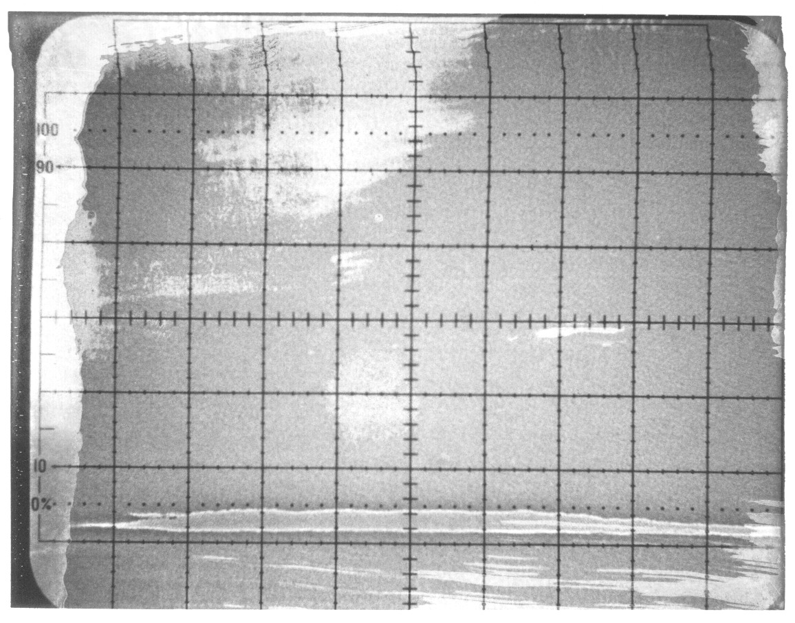

I'm going to try to measure VOD with an oscilloscope, but it is an experimental procedure I haven't tried before (I don't know much about electronics - I only barely know how to operate an oscilloscope), but I've found some papers that describe different methods.
The simplest method uses ionization probes, which can be made from coaxial cables. It is based on using the conductivity of the reaction zone just behind the detonation front to act as a switch to close an electrical circuit. This can then be detected with an oscilloscope.
Another option that looks attractive is based on detecting the arrival of the detonation front based on capturing the emitted light, and guiding it to fast photodiodes using fiberoptic cable. The optical detectors they used in the paper were quite expensive (ca. 500 dollars a piece and I need at least two - more preferably a few more), but I've found some much more affordable ones that I'm hoping are good enough.

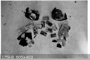

Measuring VOD
Synchronising measuring instruments such as oscilloscopes with such fast phenomena is not easy. Here is an example:
During my engineering studies, I did an internship in an explosives research centre, where I worked on measuring the particle velocity behind the wavefront, which is of course lower than the VOD, but is nevertheless expressed in km/s. I used the magnetodynamic method, which consists of measuring the current induced in a metal strip immersed in a magnetic field and entrained by the products of the detonation. The explosive was 200 ml Astrolite A. Both oscilloscopes were triggered by a probe located a few centimetres upstream of the metal tape, but only one worked, and gave a null image. Either it was triggered too early or too late, or its calibration was not good. And I didn't get a second chance...
2.Measurement part.jpg - 154kB 1.Metal strip mounted on plexiglass.jpg - 143kB 0.Command console.jpg - 155kB 3.Device rear.jpg - 186kB 4.Device front.jpg - 189kB 5.Bunker (TNT 5 tons equivalent).jpg - 146kB 6.Before.jpg - 187kB 7.After.jpg - 179kB 8.Scope recording.jpg - 284kB 9.Aftermath.jpg - 175kB
[Edited on 9-2-22 by pdb]

Yes, noise and unreliable triggering is why I was thinking that fiberoptics and a fast photodiode might be better. Time will tell. Whether I can get it to work or not, I'm sure I can find some use for my new oscilloscope.
