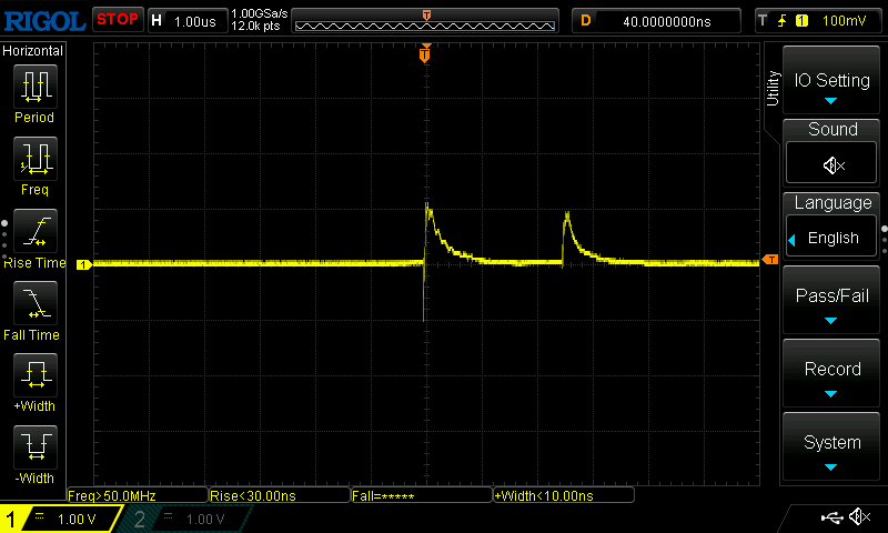

Recently, I have devoted my spare time to developing test methodology for measuring VOD using an oscilloscope. I can now report my preliminary findings:
PETN_d1.57_15mm.png - 32kB
This is a screencapture from a test on pure PETN with probe placement 15 mm apart. The probes are ionisation probes, with each probe simply consisting of two square cut copper leads inserted (the picture shows a single probe point):
Sleeve.jpg - 2.3MB
The test sleeve is resin 3d printed and the flaring base is just to have a secure attachment to the print plate. It also allows me to glue it onto a witness plate if I want to test brisance along with VOD (the axial hole goes all the way through). The picture doesn't do it justice, but the probe holes are very cleanly printed at exactly 5mm center distance.
The principle of this testing method is that the reaction zone just behind the detonation front is conductive since it is a high density plasma. Therefore, it can act as a switch to close a circuit. I have then constructed a simple circuit with the probes acting as switches in parallel and included a voltage divider setup to allow the change in signal to be detected, even if the conduction zone hasn't completely faded at one probe before triggering the next. The circuit is powered by a 9V battery, which provides the signal.
In the screen capture above, you can clearly see the very sharp rise in the signal as the detonation reaches the probe, followed by a gradual fall as the conductive zone attenuates. The time between the leading edges is very close to 2.5 us which, with probes 15mm apart, corresponds to a VOD of 6.0 km/s. It is difficult to assess this value since I don't know the exact density of the charge. Also, litterature values are often the result of tests on much larger charges, so even if I did know the density, the VOD of my charge would be less than most litterature values at the same value.
Nevertheless, I find the results encouraging.
I still have much work to do, examining the reproducibility of the setup and trying more than two probes to see if I can map the velocity profile. I also have to examine many different explosives to see if the detonation zone is similarly conductive for others.
[Edited on 8-3-2022 by Microtek]
