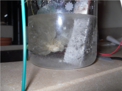

Part I: Procedure with CuSO4
The first test that was conducted was with copper sulfate. 6 grams of CuSO4ยท 5H2O and 300 ml of distilled water were mixed in a beaker. In a square of cardboard, holes were cut for a cathode and a condom. The condom was partly unrolled and washed in distilled water. Once the lubricant was gone, the condom was no longer oily to the touch. An aliquot of solution was poured into the condom, and the condom was placed through the card. The card and condom were lowered onto the beaker. A graphite anode was placed into the condom, and an iron cathode was lowered into the solution outside the condom (see attachment 2) 14V was passed through the cell until the blue color had changed to green (see attachment 1).
Once electrolysis was stopped, the anolyte was transferred from the condom to a beaker. The graphite electrode had crumbled into the anolyte so the black suspension was allowed to settle. The resulting liquid was clear. To test for the presence of sulfuric acid, 0.6g of technical grade barium carbonate was shaken with an aliquot of the anolyte, with plenty of venting. Some CO2 bubbled out and the solution turned cloudy, confirming the presence of sulfuric acid. Oddly however, the precipitate soon turned dark yellow-green. The rest of the solution remained clear (see attachment 4).
Originally the copper sulfate electrolysis was done because I assumed that no sulfuric acid would form without a barrier (copper will react with the acid and create more copper sulfate.) After doing some reading online, I found that it wasn't necessarily the case, so I tested it myself by doing a control test without a barrier. The first experiment used a iron cathode because I didn't expect it to dissolve in reducing conditions, but it did dissolve a little. Copper would have been a better choice, but for consistency, I used iron again for the control.
The electrolysis was allowed to run until the cathode (a steel paper clip) was fully dissolved. At that point, the color had gone from bright blue to light blue. The sulfuric acid test (with barium) gave a very similar result but the precipitate was biphasic (see attachment 3). The top phase was a yellow-orange liquid. The bottom phase was yellow-green with a hint of suspended particles. There was also a rusty orange precipitate at the bottom. After this experiment, the condom was permanently stained blue.

In the sulfate experiments, the dissolution of the iron cathode was unexpected and likely complicated the otherwise simple experiment. Dissolution was fairly slow, but nevertheless a paper clip was dissolved in a matter of 15 minutes. It is likely that the rusty orange precipitate formed during the barium test of the control electrolyte had something to do with the iron dissolving. A copper or graphite cathode would be much more apt in future experiments.
Otherwise, the condom seemed to be successful in separating the anolyte from the catholyte. The anolyte was visibly clear while the catholyte was green. It also kept out whatever substance was causing the upper phase and orange precipitate in the control test.
The anolyte had a greenish/yellowish tint after the barium carbonate was added. This is consistent with some divalent copper compounds, but the true mechanism of coloration remains unknown to me.
