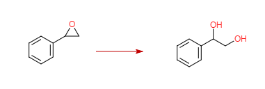

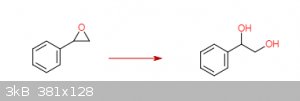

styrene oxide to phenylacetaldehyde via the pinacol rearrangement?
In theory, mixing styrene oxide and a non-halo acid (H2SO4) should give styrene glycol. A halo acid such as HCl will give a halohydrin instead.
styrene glycol.png - 3kB

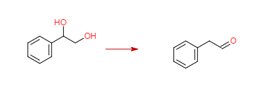

On further mixing and heating phenylactaldehyde should be the product (see this Youtube video on the Pinacol Rearrangement).
phenylacetaldehyde.png - 3kB
I'm assuming roughly following this procedure in the attached pdf (Organic Syntheses, Coll. Vol. 1, p.462 (1941); Vol. 5, p.91 (1925)) and substituting an equal molar amount of styrene oxide for pinacol will give the desired results.
I don't have any glassware to try this out myself but any comments on the theory are welcome.
