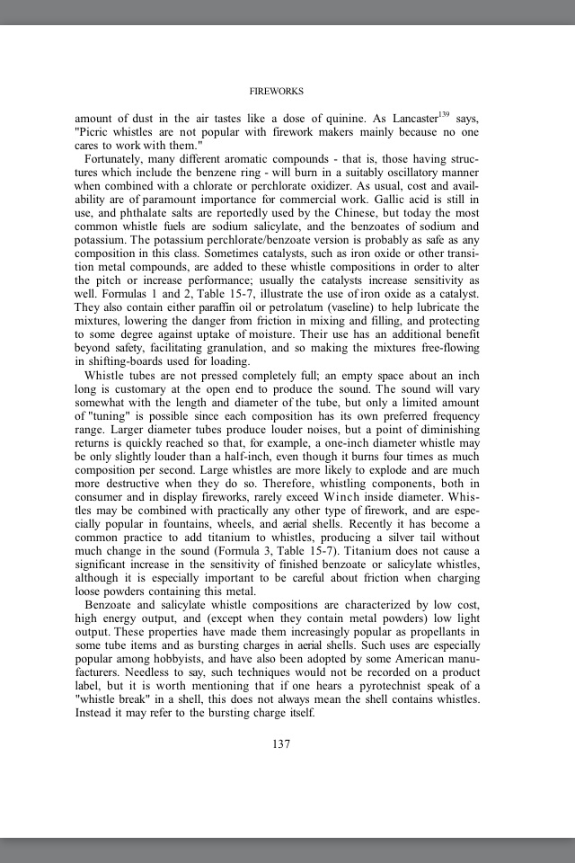

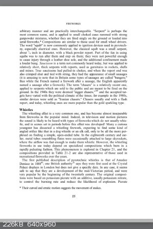

First: it seems you are using too much fuel and too little oxidizer. 70:30 works with perchlorate, chlorate calls for closer to 75:20 as there is less Oxygen available per moll. See below-
HOW did you distribute the petroleum jelly evenly through the mixture- Did you use a solvent, such as lacquer thinner? If so, are you certain it has all evaporated?
While drying off the solvent, how humid was the air... Damp whistle mix doesn't work, regardless of being wet with hydrocarbons or water.
:oTHIS: chlorate mixtures should NEVER be dried in direct sunlight. Small amounts of acidic impurities and moisture will cause a bit of Chlorine dioxide to be formed. Ultra violet light in sunshine then causes the Chlorine dioxide to set your composition on fire! So don't- If it's the only oxidizer you have, learn chlorate's particular dangers, and how to minimize them.
:mad:And tell your Chinese suppliers you want PERchlorate. It doesn't cost much more, and you won't be his customer anymore if his chlorate kills you.
Are you in India?
Yes, you can make whistle with Potassium chlorate. But it's a lot more dangerous-
If you stick a blasting cap in it, goes high order. Goes off from much less shock, than perchlorate whistle, probably a lot less friction as well- I'll have to look the figures up. Minor contamination with Sulfur, sulfides, Antimony or Arsenic compounds among other things will all further sensitize this, like pretty much any other chlorate mix.
image.jpg - 226kB image.jpg - 227kB image.jpg - 239kB
image.jpg - 239kB
