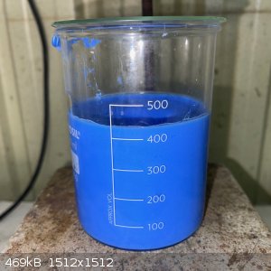

- I added excess water to the bulk and stirred it for an hour. This broke it up and it became a fine suspension.
9.jpg - 469kB
- This was then vacuum filtered. The wash water remained blue so I suspect it is slightly soluble in water.

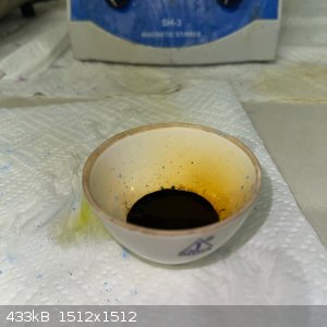

- I took a bit of the product and put it in a small crucible and on my hotplate at maximum heat which should be > 250C. It melted, bubbled a bit, and I was left with a black solid substance.
- I wondered whether there was traces of copper in the charred remains and added 70% nitric acid. The acid bubbled a bit and released NO2. I don't know if the release of NO2 confirms copper was present or whether there was another reaction.
12.jpg - 433kB
Cleaning up all the beakers and dishes was quite easy as the product dissolves readily in concentrated HCl.

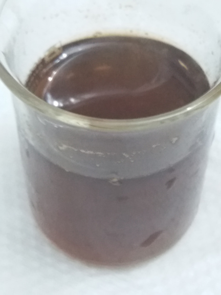

[*] posted on 10-7-2021 at 00:06
Iron:
As often Iron yielded confusing results.
- 26g MSG dissolved in 300ml water, giving a clear solution.
- 20g Fe(NO3)3.9H2O dissolved in 75mm water, giving an orange-ish solution.
- Mix hot - the solution went dark, and there appeared to be some ppt but almost nothing.
- Add 300ml methanol. A brown-orange suspension formed. Stir 10 minutes.
- Vacuum filter. Filtering was slow as the brown remainder was very fine. The filtrate was wine red.
- The remainder when scratched off the filter paper was surprisingly dry:
1.jpg - 725kB
- Leave out on bench to dry.
- Next day: The product was seemed to have attracted moisture from the air and was now dark and wet:
2.jpg - 554kB
- In desiccator, vacuum over NaOH for 48 hours.
- Result was hard, dry black crystals:
3.jpg - 627kB
- 3.6g was recovered and bottled:
4.jpg - 427kB
This was the first of the glutamate reactions that gave a product that was more difficult to filter out, and that seems hygroscopic. It dissolved in concentrated HCl giving a green-yellow solution presumably of FeCl3; the wet brown remainder dissolving much easier in the acid than the dry black remainder. But it is a iron glutamate complex or something else. Any ideas? What also surprised me is the fact that it was filtered out from the solution that was at least 50% water quite "dry" but then became more wet on the bench. Was it dry in the solution because of the methanol in the water, or because it was filtered when hot?

Because Lion850 didn't tryed Fe2+ so I tryed this. I used 5.5g MSG and 4.0g FeSO4 7H2O(2:1 mole ratio). I dissolved MSG and add FeSO4 7H2O solid. the solution becomed deep brown(1st photo). And then I added isopropyl alcohol to try remove some water. solution becomed 2 layers(2nd photo). lower layer like soy sauce(laugh). upper layer almost clear, have little brwon, maybe have little product? More isopropyl alcohol also didn't make solid presipitate out, so I didn't tryed crystalise. 2nd time I used 3:1 mole ratio. this time the solution becomed lighter brown, didn't like last time so deep. also this time the solution have solid presipitate out(3rd photo). If I use plastic spoon to scoop/ladle the solution the solution surface becomed deeper colour. I think the reason is Fe2+ oxidised to Fe3+. Now I understand why Lion850 didn't tryed Fe2+.
1.jpg - 64kB2.jpg - 67kB3.jpg - 65kB
sorry for bad english

What color did the iron(II) solid have when you made it? Next time I think you better dissolve it before adding it I think.

@Tsjerk iron(II) solid? I don't understand this. My FeSO4 7H2O is green small granule, diametre about 1mm, but some granules because too old so becomed brown/yellow.
Posts: 2938
[*] posted on 25-11-2021 at 12:11
Then I understand the brown color. My Fe(II) solutios are green.
