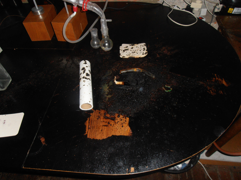

[*] posted on 10-4-2013 at 12:59
Update:
I went to my lab, there are no fumes anymore. but EVERYTHING is coated in a thick layer of sticky H3PO4. any tips for cleanup?
here are pictures of the damage:
FLOOR.jpg - 178kB
This is the floor where the bottle was, RIP :D
TABLE.jpg - 181kB
This is the table where I dropped the bottle before it rolled off.
E17 bottle.jpg - 159kB
This is a bottle containing S, the bottle is identical to the one that had the RP in it
BOTTLE.jpg - 208kB
This is the bottle I was pouring the RP in to. It seems like I will be able to recover a good amount.
Willie Pete.jpg - 167kB
this one is my first ever batch of WP,l not bad for a beginner! pure nerd porn!

Well, I held my breath most of the time or breathed through a damp cloth, but got a few big lungfuls while dragging him up the stairs. now I feel fine, must have been anxiety.
to clear up on the ''pouring'' thing, I held the neck of the RP bottle just above the neck of the empty bottle, and was gently turning it to make the powder fall into the smaller bottle. I have no idea how big the burst came to be, It was right in front of me, so maybe it wasn't that big. the hot plate was maybe 1m away.
The smell might of been intense, but that was the first time I had smelt WP so I had no idea how strongly it smelt. there was no fuming.
I don't see how this might be MY fault Endi.
I feel fine now, he has a little pain breathing. I might go check today to see if the smoke has settled, otherwise i'll check tomorrow.
These mistakes are very harmful for your health... I don't mean you could have predicted it or not done that whatsoever, but I know of a man who died because of inhaling asbestos, a woman who died because of inhaling hlorine (NaClO+HCl, you can imagine)... and, well I suppose this is no nonsense either. Hope it's all right!

but you can also watch the phosphor rot! It can be bad in you and in me!
He will check the bottle to make sure he's not sending the wrong stuff or a contaminated bottle. You have to be careful with red phosphorus (not just the white), as it, too, can be very dangerous.
(I'm assuming "rot" is a typo or mistranslation of "red", as in German, rather than him claiming that red phosphorus will decompose....)
