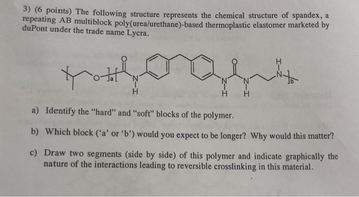

I know this thread has been inactive for 12 years, but is there any way of converting the spandex polymer, which is made from THF, back to THF?
ArbuzToWoda
Posts: 98
Registered: 15-7-2020
[*] posted on 19-11-2020 at 09:23
Where did you get the information that spandex is made of THF? It's an urethane containing polymer, look at the attachment.
edit: now I see what you meant, but I wouldn't expect there to be such a way. Spandex structure doesn't have any tetrahydrofuran-like rings at all.
