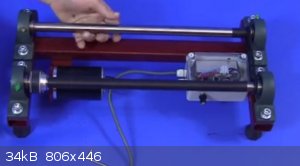

I wish I can build professional ball mill like this : https://youtu.be/MXfs4laIRVs
Capture.JPG - 34kB
I think he use 24v or 12v DC motor. I wounder how long can it run !
I am trying to search for DC motors as well since they have strong starting torque and speed can be controlled easily.

Ecos, it is easy enough to get some pillow block bearings. Not sure if these are the best bearings for you, but it gives you an idea anyway.
http://www.ebay.com/itm/4-PIECES-1-2-Pillow-Block-Bearing-UC...
The frame is fairly simple and could be easily made from some scrap materials even. The motor could be the expensive component, especially if you aren't careful. It is nice that the motor in the YouTube video is so small and fits underneath the drum, but it really doesn't have to and if it wasn't required it would make motor selection much easier probably. Most places I have been, with even fairly modest population size, have motor shops. Often times second hand motors can be found too for good prices, especially at salvage shops (even the ones that don't specialize in motors). All motors eventually wear out, or need to be refurbished, so you have to figure out what is available to you and then what gives you the best value. Maybe you can get motors that only last a few months, or less, but they are really cheap or free. It might make sense to go through several dirt cheap or free motors, if you have a convenient source, rather than spend hundreds of dollars on one top of the line specialty motor. It depends what is important to you.
