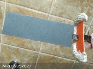

made another one of these this time plated with ultrasound and very low current density of 6ma/cm^2
flaky was from previous plating attempt which sucked cuz I used too high current density.
It was extremely hard to remove the old plating that was all bumpy because even while running it in NaCl at 300ma/cm^2 it just wouldnt come off.
I had to run it as a cathode which finally took out most of it away and then plated only using ultrasonic bath with low current for this currently nice even coating.
IMG_20201118_000157.jpg - 74kB
[Edited on 17-11-2020 by mysteriusbhoice]

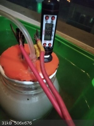

one of my latest runs with it
Percell2.jpg - 31kB perchcell1.jpg - 27kB perchcell3.jpg - 56kB

about the superglue composite PbO2 on lead substrate PbO2 anodes they are amazing but not for perchlorates!! for making H2SO4 from CaSO4 with NaOH catalyst they can run at 200ma/cm^2 no problem at 12v!! across the membrane and not shed during the run because heres my crop from that latest run on that project plus a video showing the concentrated acid from the cell.
https://www.youtube.com/watch?v=t5gppFbrtWE
H2SO4 from cell.jpg - 2.9MB
