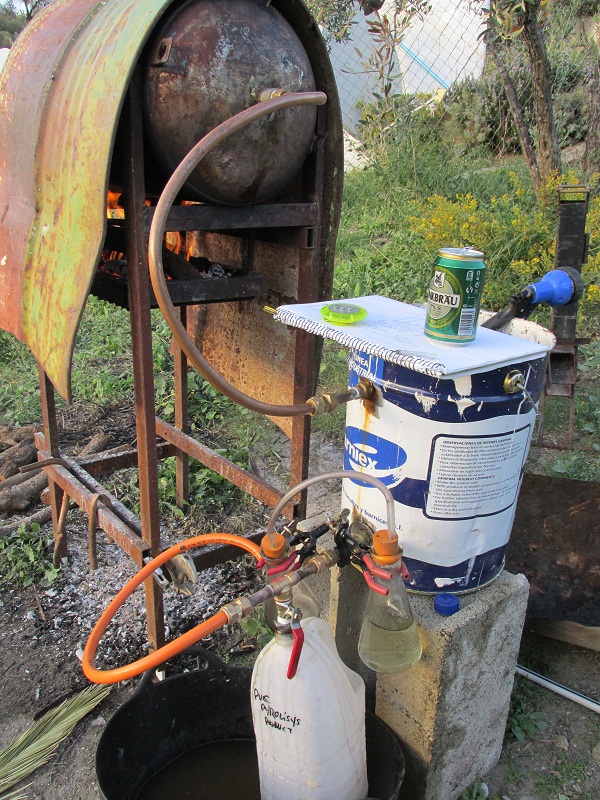

I finally got my 10 gallon pyrolysis rig set up, and working.
The rocket stoves didn't work (5 at once).
Welding up a grate and simply making a wood fire under the tank got the interior to > 300 C.
For the first run, i used some weeds, which are in plentiful supply hereabouts.
Syngas was (presumably) the gaseous product, as it burned rather well, and with hardly any colour.
Is there anything to be Done with syngas other than just burning it ?

[*] posted on 27-10-2014 at 13:28
Might be easier if you see what Advanced Technological Apparatus is deployed here.
rig.JPG - 209kB
Yes, the blue and white tub is full of water and about 5 feet of copper pipe as a condenser.
[Edited on 27-10-2014 by aga]
